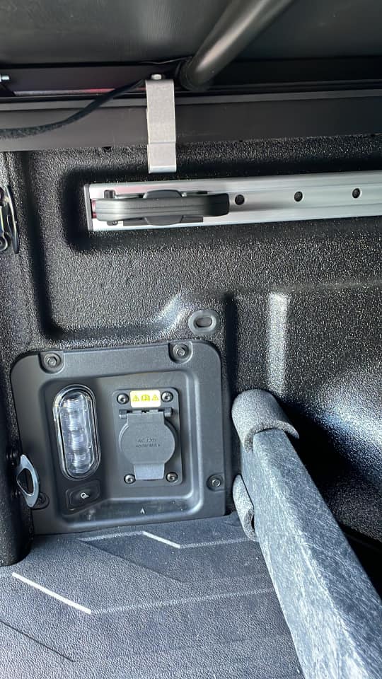

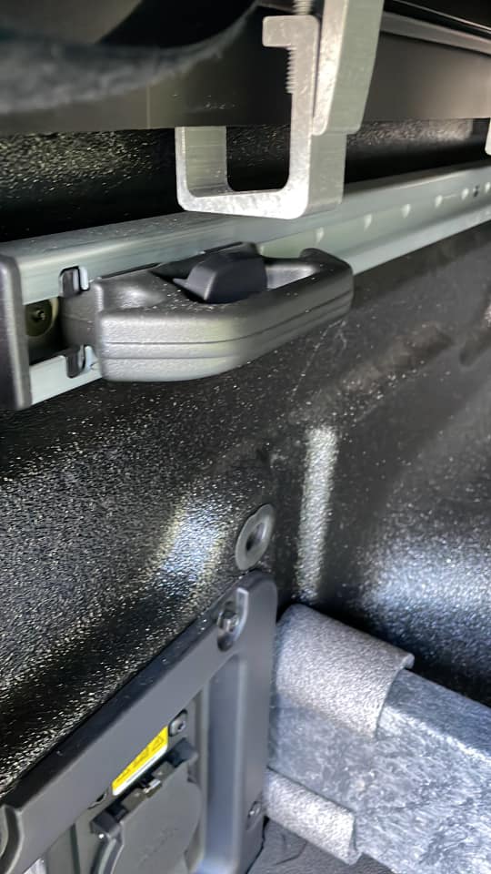

I stole this from a FB page just to share here, so credit to Laura Hamilton.
“Got my divider cut and put in today. Pleased with how it turned out. Used recycled plastic lumber in black from Menards, and added the pipe foam to make sure It doesn’t scratch my bed liner and I don’t hear it when I’m driving. Ready to get groceries 🤣.”​
"With my spray in liner it [plastic lumber] was about 54 1/4 inches long in that slot. We started at 54 1/2 and made a slight trim."​
"It’s about 15 3/8 inches from the lumber board to the tailgate"​
At the price I probably will black stain a wooden board and use the pipe foam on that. I will cut the foam tighter so it looks cleaner as well.
Link: 2 x 6 x 8' Black Plastic Lumber at Menards https://www.menards.com/main/p-4221069730084277.htm
Which tonneau cover are you using? Soft? Hard? Roll up or Tri Fold. Just curious because I saw the clamps in one of the pics and I was wondering with a plastic trim on the bed if a clamp was going to damage the plastic. And is it one of the Ford ones or a another brand? Thank you in advance for the info.
