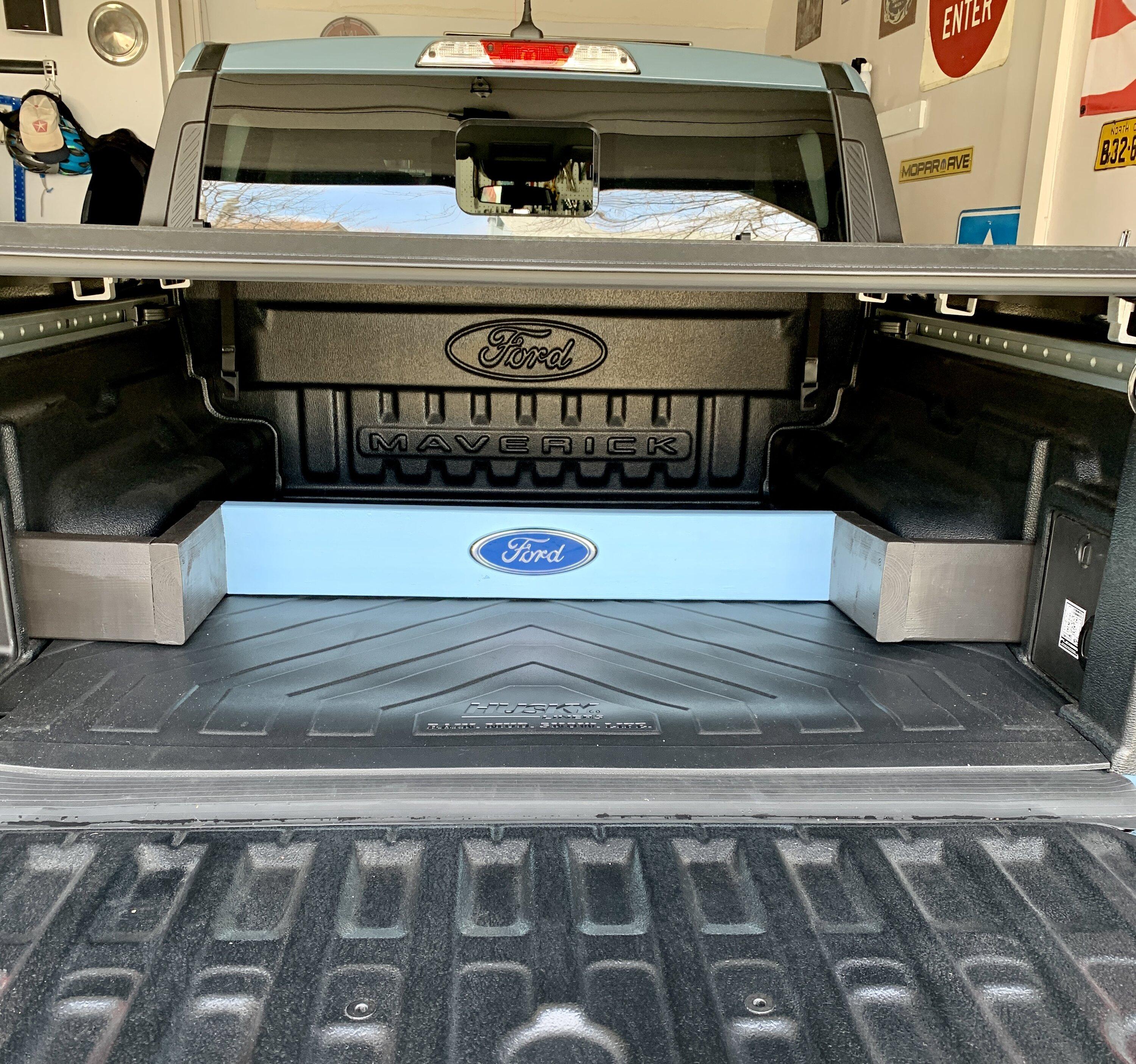

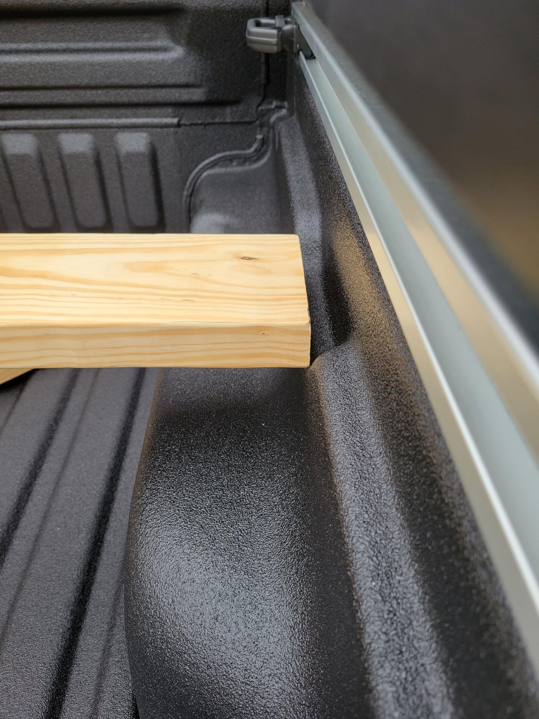

I'm going to assume if you're wanting to place your lumber like this, you'll need the 55" cut. The above pic is using the same 2x6 I had in the original images. It's too short to be secure in this configuration.
Not sure what you mean by the 55 cut. The first pic said it was 55 1/4. Yet it's to short.
The OP has 54 1/4”, not 55”. The 54 1/4 is for the slot behind the wheel well, the spot on top of the wheel well is 55”
2x6 at 54 1/4. It fits, I just think I want a taller one. Maybe 2x10? Might just stack a 2x4 over it. Don't know yet. Anyways, just sharing in case anyone wanted to see the 2x6 specifically. Going to paint whatever I use a matte black or maybe some type of bed liner spray if I can find some.

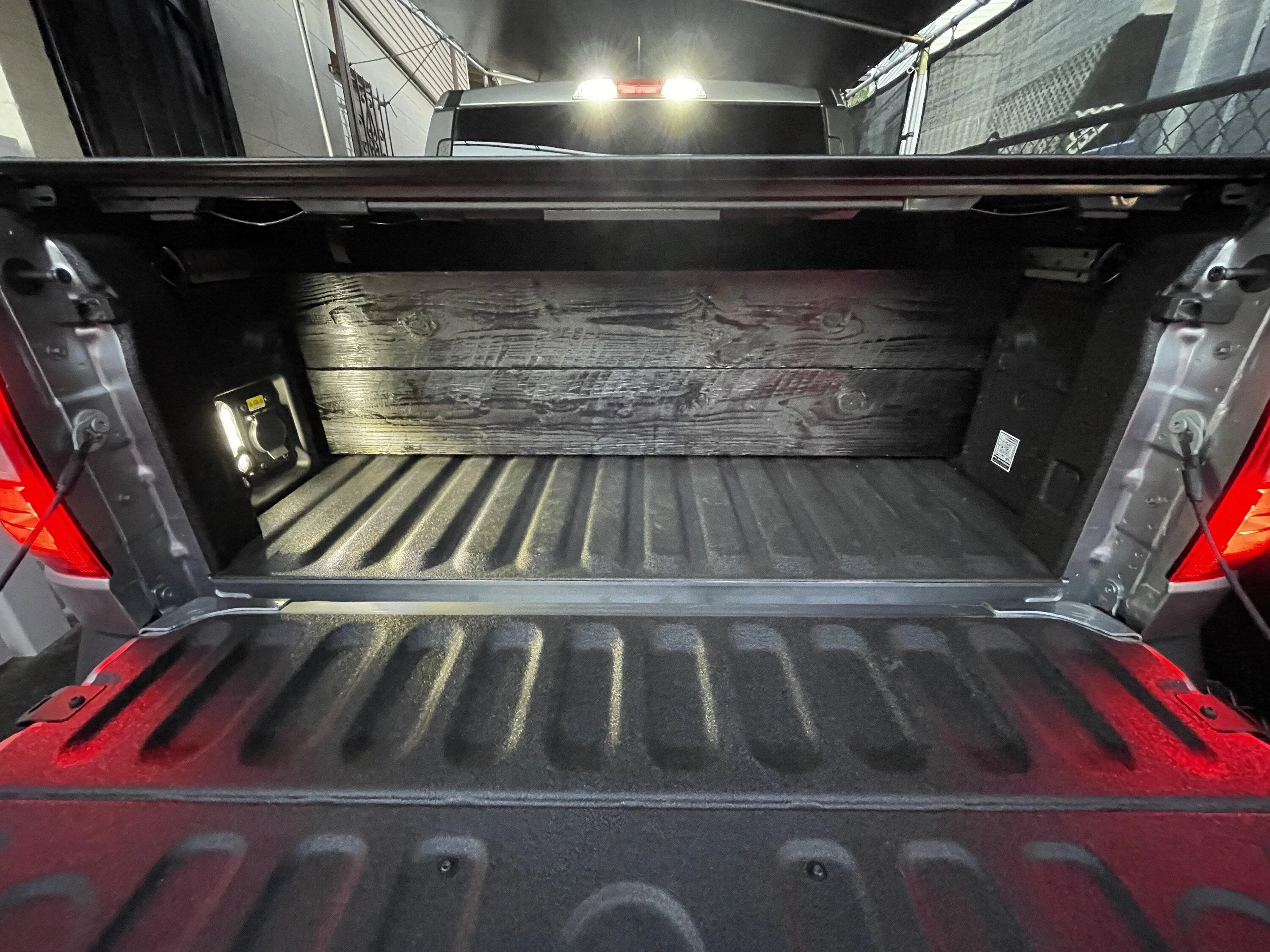

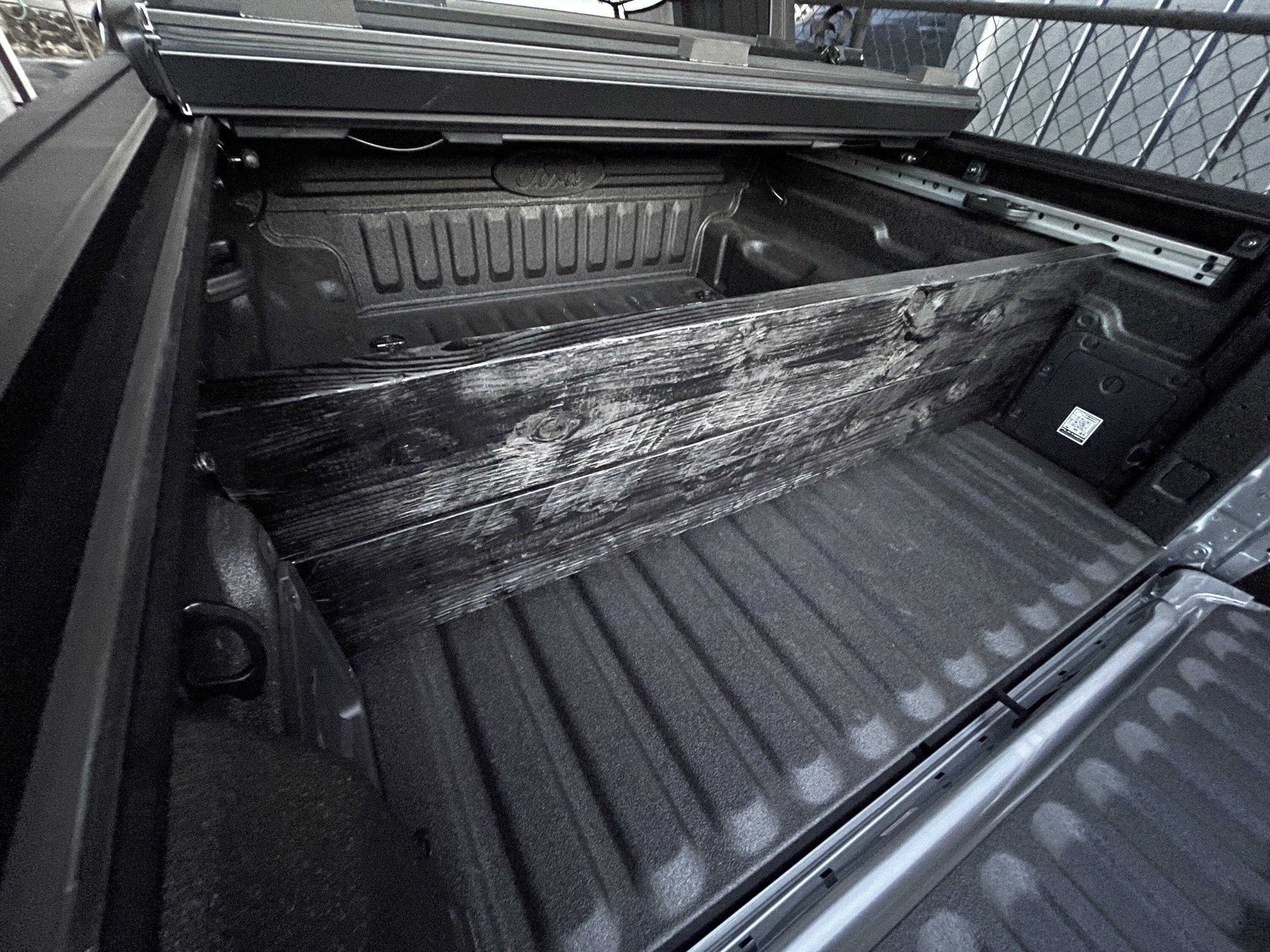

I managed to use 2-2x10s with a velcro strip between the length of each piece. I also added rubber gaskets to the back side to prevent bumping
Ford Maverick 2x6 Bed Divider for the Flexbed IMG_4026
and spray-painted them black.

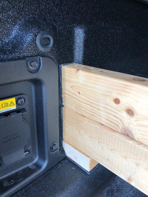

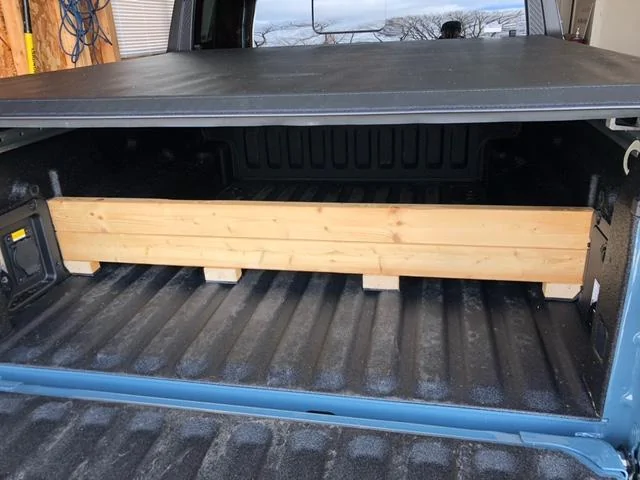

This is my super simple bed divider solution using stuff I had around the house. The 2x4s are not connected, and I find that makes it easier to take them in and out and place in position. I cut a strip of one of those thin heavy rubber floor protectors for the ends to help avoid marring/scratching. Then sanded and covered with 2 coats of water based varnish to make smoother and hopefully avoid slivers.
I could also flip the bottom board around (if that makes sense!) to then have the gaps between the boards if wanted. As they are now it would minimize much wood contacting the bed if it got wet.
Ford Maverick 2x6 Bed Divider for the Flexbed z

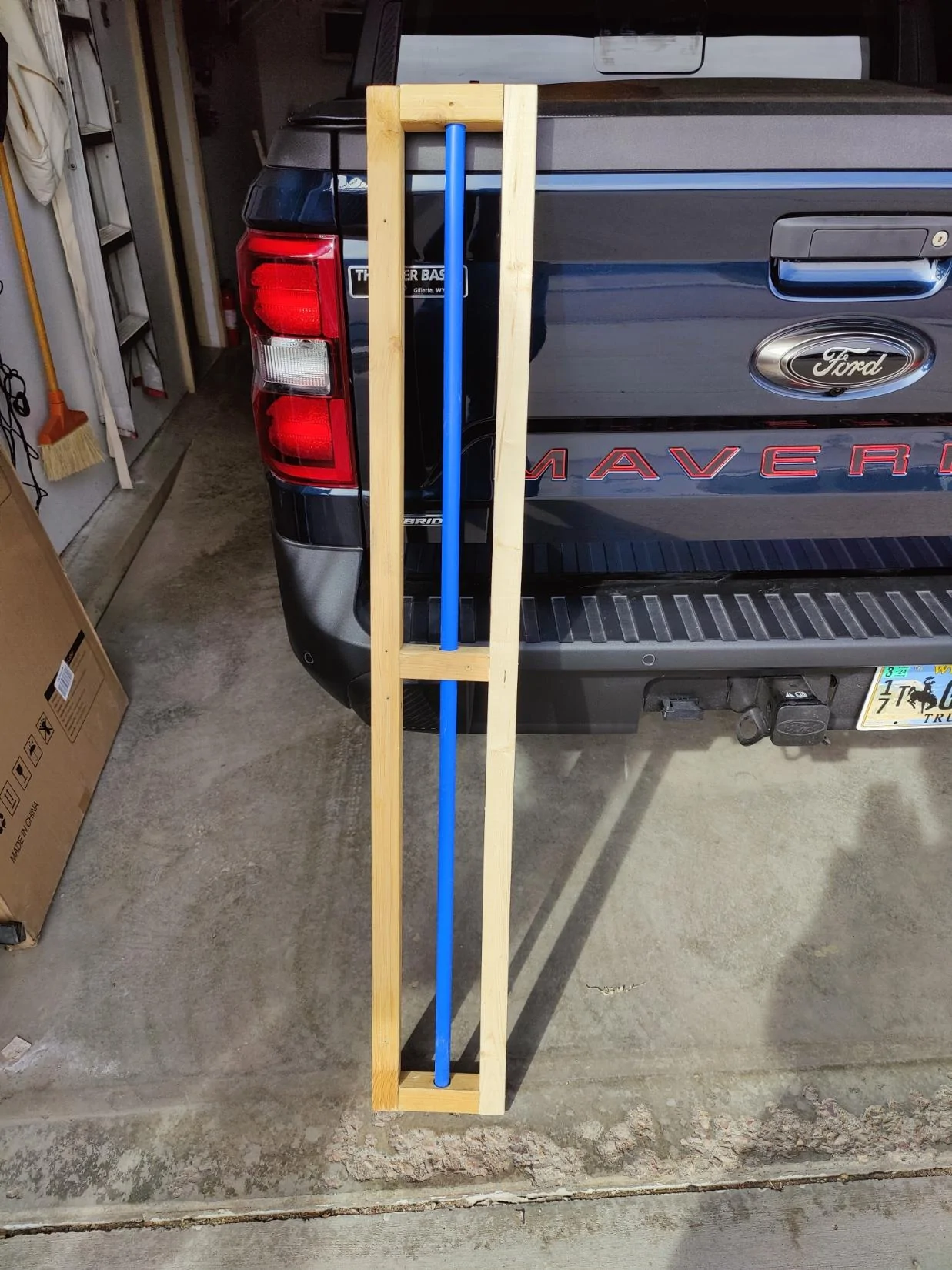

I had to modify mine, in order to hold more groceries. Mine is used to keep groceries within reach.

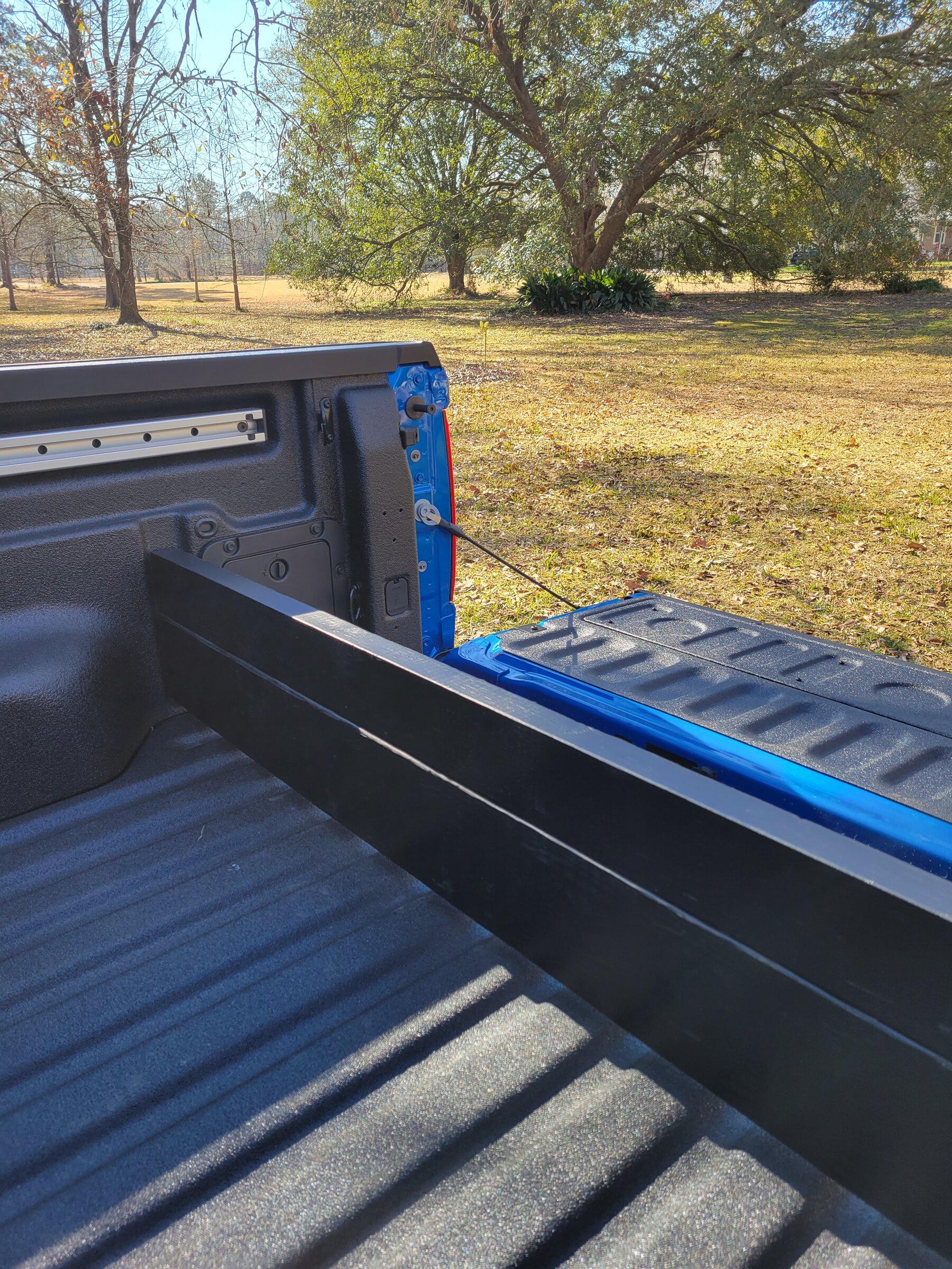

I made the 2x6 and painted them satin black. They came out nice. They make nice cargo compartments. If I did it again though (and I may) I'd make them 2x8's. The 2x6's are lower than the height of the wheel wells. If I put in 4x8' plywood, the weight would be mostly on the wheel wells. Only the sag would touch the boards in the middle.

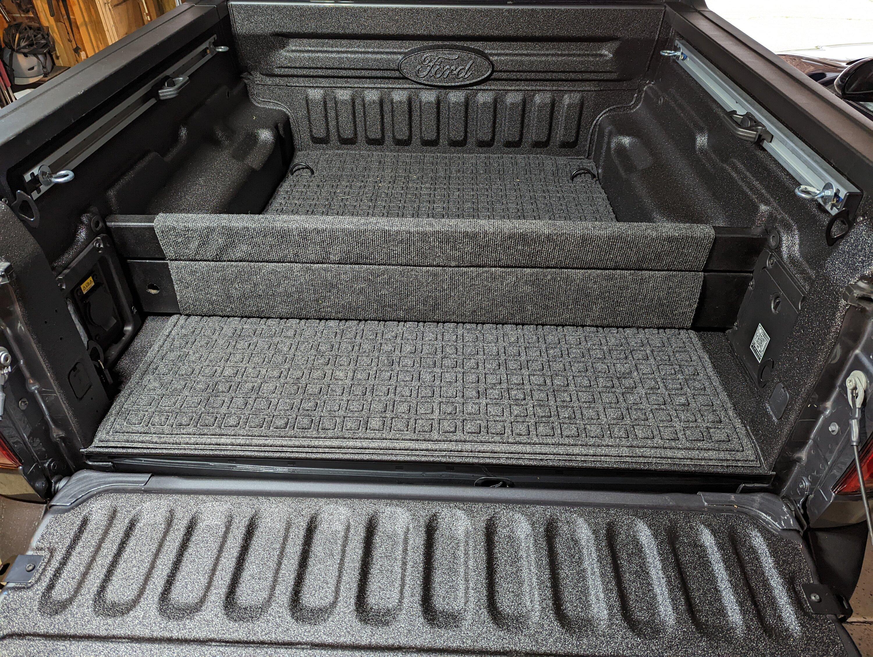

Improvised divider this morning for my wife's Maverick when she told me she needed to carry some food containers.
Rubber stripes were added on the lateral sides to avoid scratch the paint.
Worked okay so far.
Ford Maverick 2x6 Bed Divider for the Flexbed 19d3ee68-86fd-421c-99f7-8969d1219260
Ford Maverick 2x6 Bed Divider for the Flexbed 1468eaed-2ee1-4cf1-994e-d9041c91b298

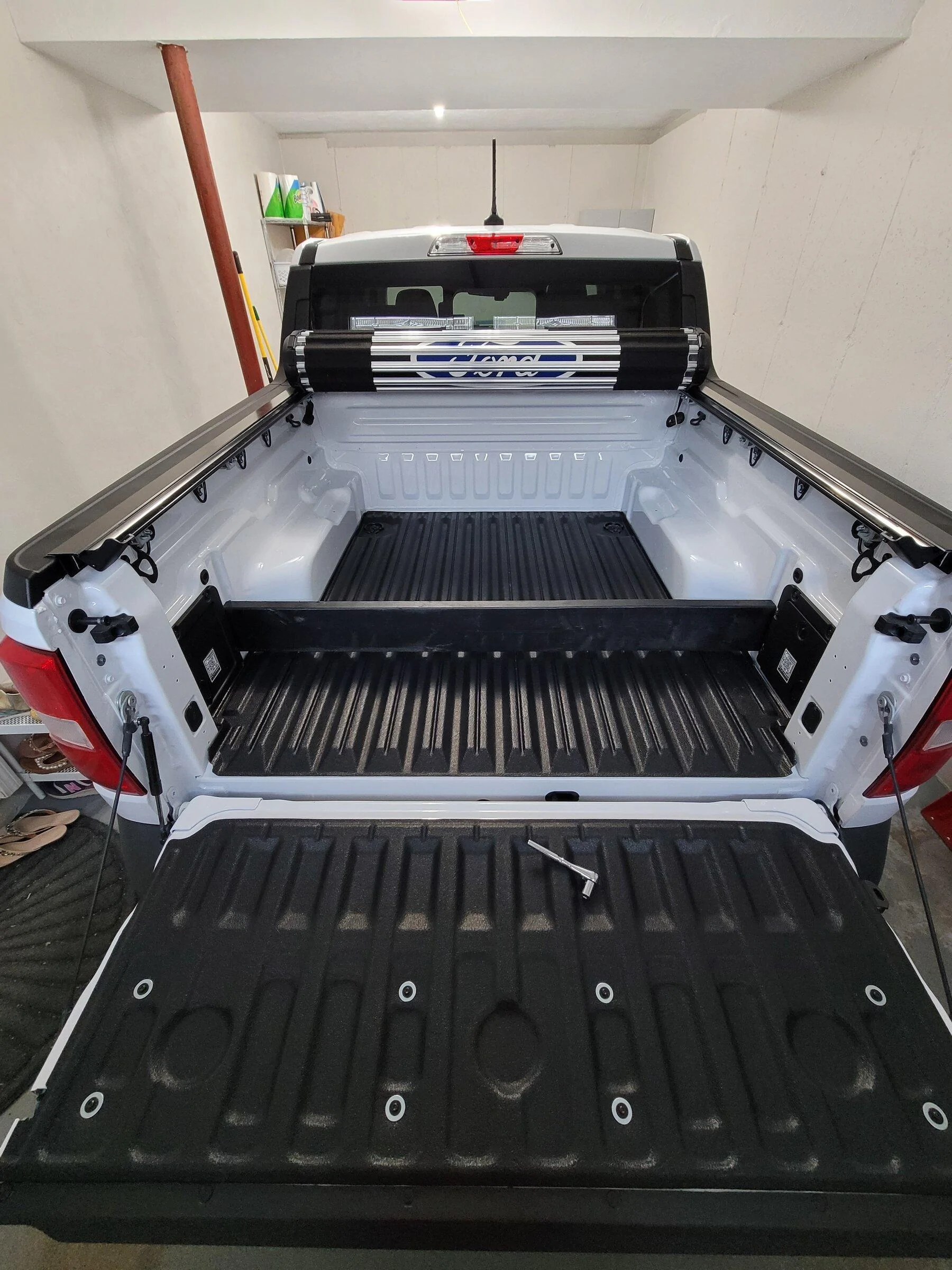

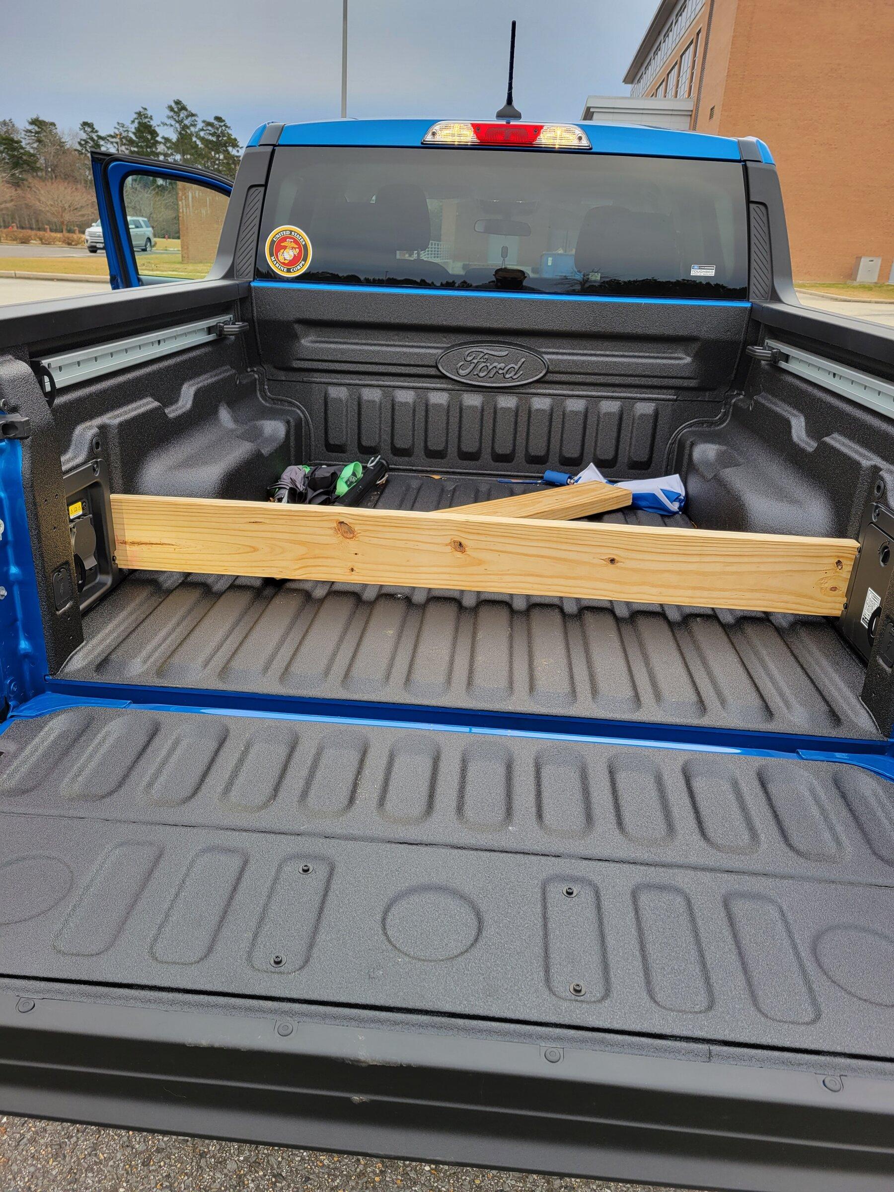

Added a 2x4 to slide in right on top of the 2x6 and painted both black. I am happy now.
I also went with stacking a 2x4 over the 2x6 but I find that most of the time the 2x6 is sufficient alone and leaves enough room to move a milk crate between the divider and the tonneau without opening the tonneau.
Ford Maverick 2x6 Bed Divider for the Flexbed PXL_20220612_004413852

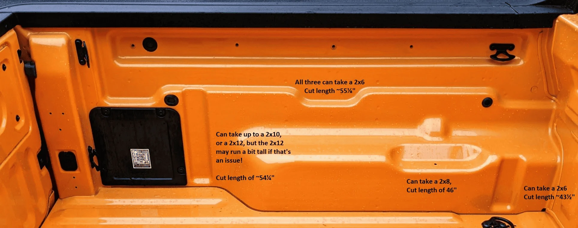

By the way, here's a picture from an earlier thread that shows the cut lengths for each of the locations in the bed. Sorry I can't give credit to whoever did the work on this - I saved it in my "Maverick" folder for future reference - like now!

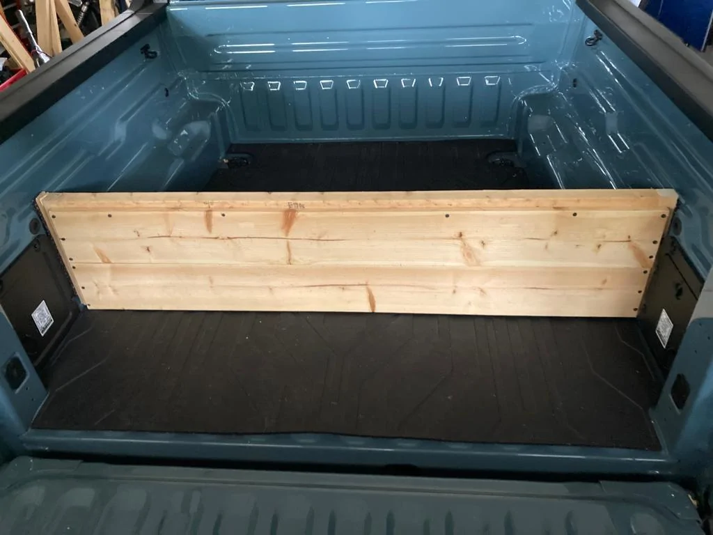

Unless you have small grocery bags, thi was lighter and easier to make.
