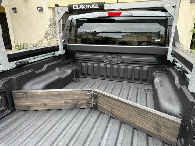

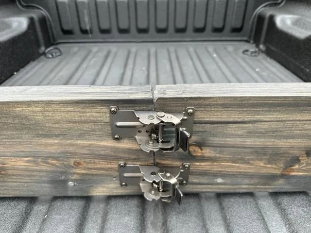

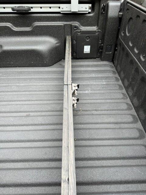

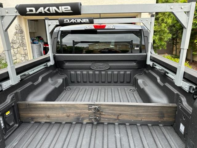

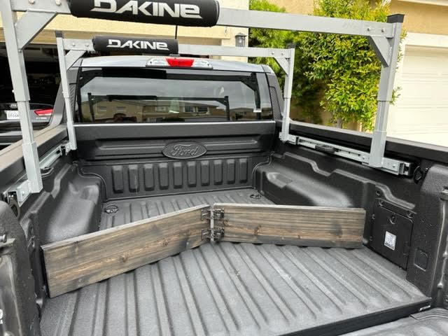

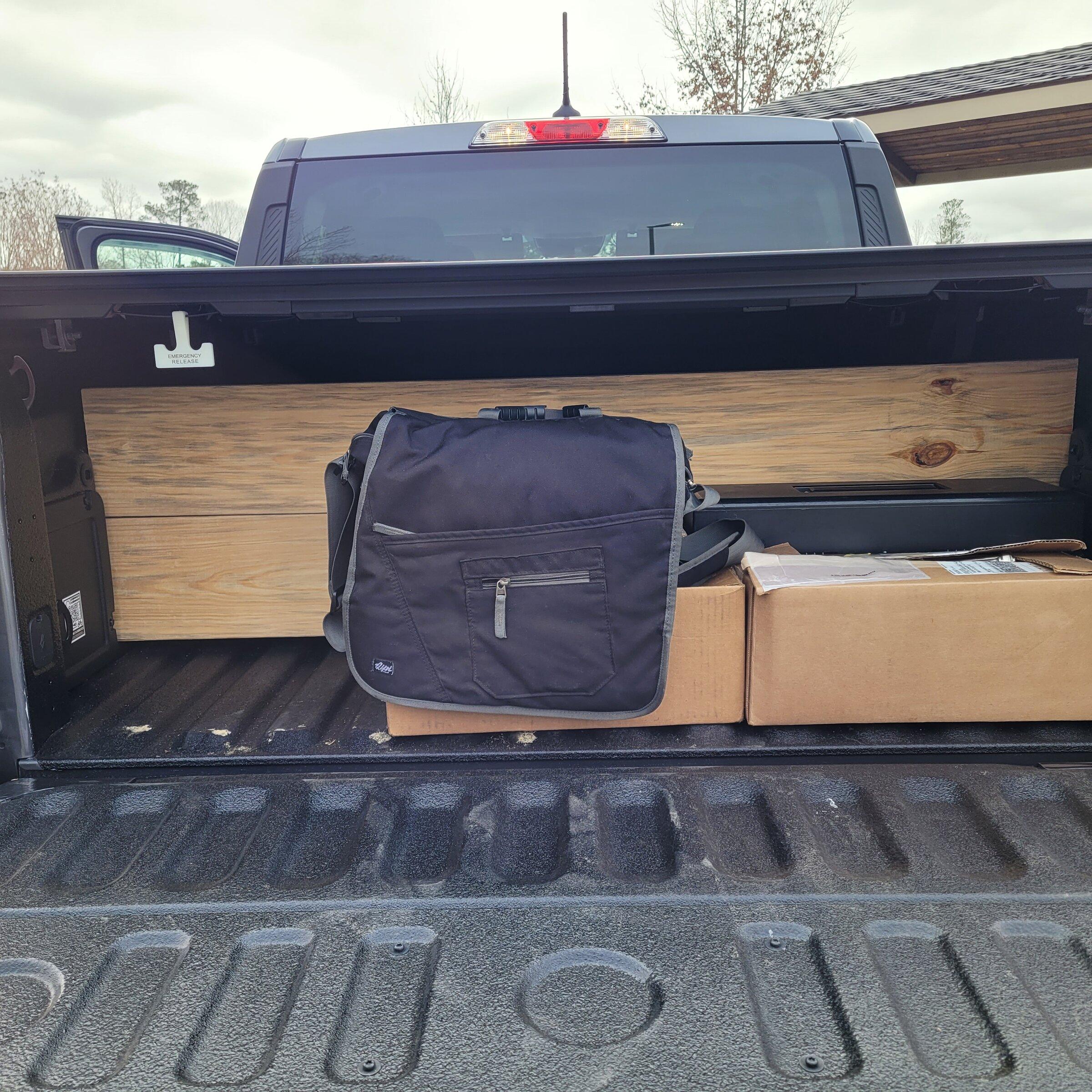

DIY bed divider with lockable hinges. I used a lighter weight 1x8 pine wood x2 cut to 54 1/4. Cut in half and install lockable hinges for easy removal.

2x6 at 54 1/4. It fits, I just think I want a taller one. Maybe 2x10? Might just stack a 2x4 over it. Don't know yet. Anyways, just sharing in case anyone wanted to see the 2x6 specifically. Going to paint whatever I use a matte black or maybe some type of bed liner spray if I can find some.

Iam curios, will the 2 x 6 you have in your pic also fit horizontally over the well wells ??

Cut some angles on the ends of the 2x6 so that it can sit right down on the floor. The way that you have it sitting up is going to wear holes in your liner material. I have found that anything taller than a 2x6 is extremely hard to remove with the tonneau rails in the way, so if you want it taller then use stacked 2x6's instead.
