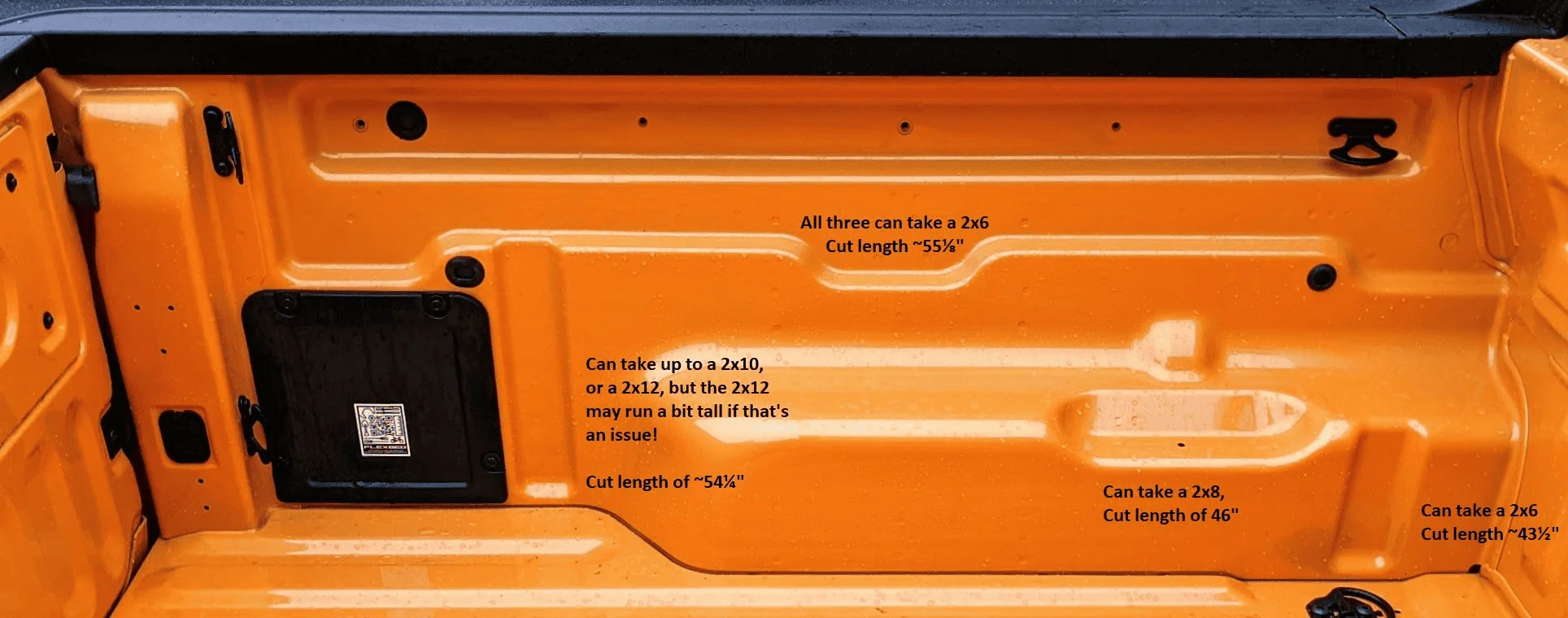

I would infer the same 2X6 @ 54-1/4" would fit perfectly across each of the three slots above the wheel well?
I have read in other posts they are different.

Here's a picture that shows all the dimensions. I can't take credit, as I found it elsewhere on the forum... (But I do like the fact that it's in the best Maverick color! 🤣 )
Ford Maverick 2x6 Bed Divider for the Flexbed Bed Divider Dimensions

Was just coming in here to post this pic again lol

If you are the guy who originally posted it, I just want to say "THANKS"... It has come in handy a bunch of times!

lol I wish I was that guy - like you, I found it a long time ago and keep it bookmarked. I post it anytime a similar question comes up 😂 I need to go find the OP so I can link his thread in the future.

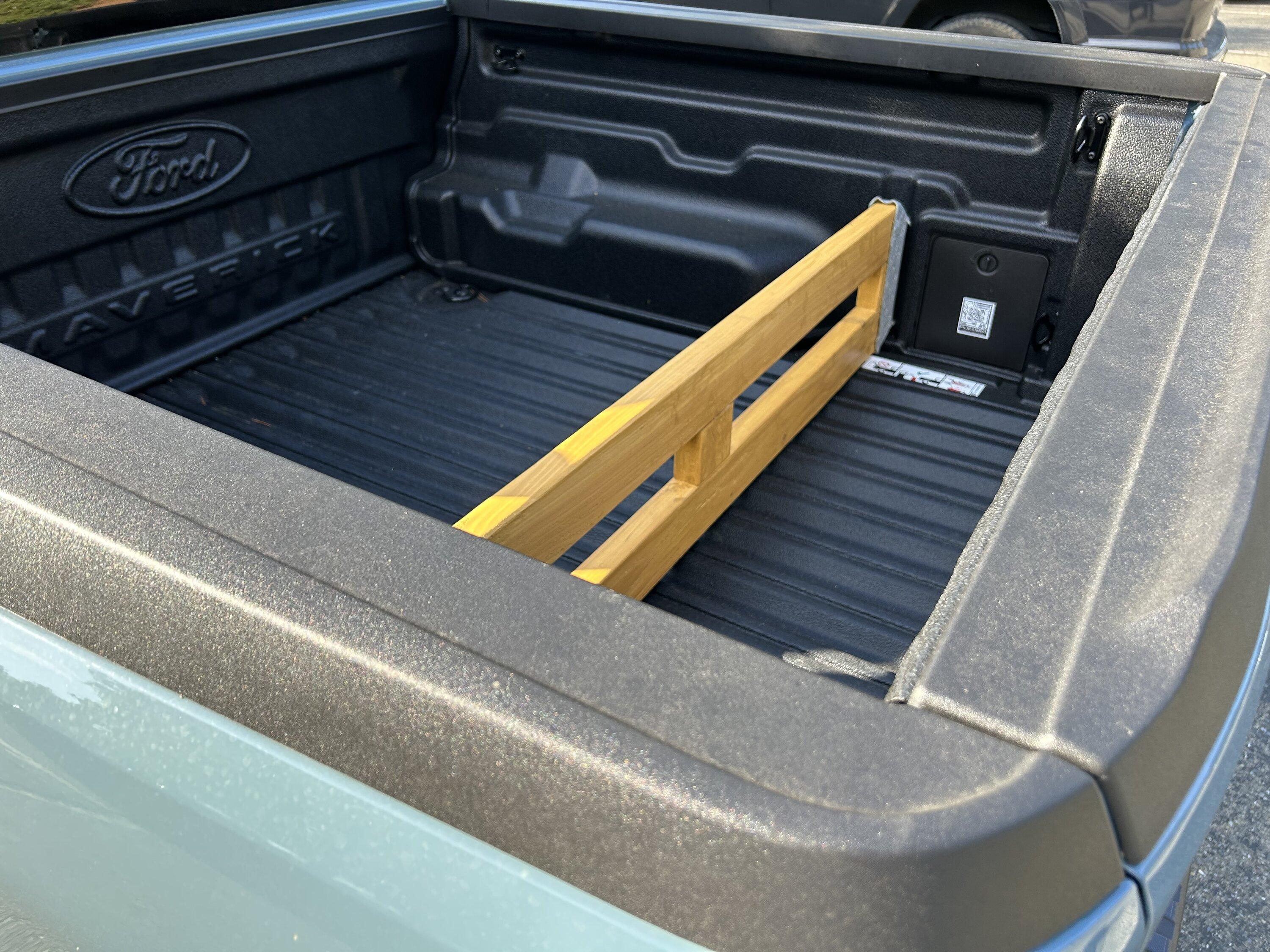

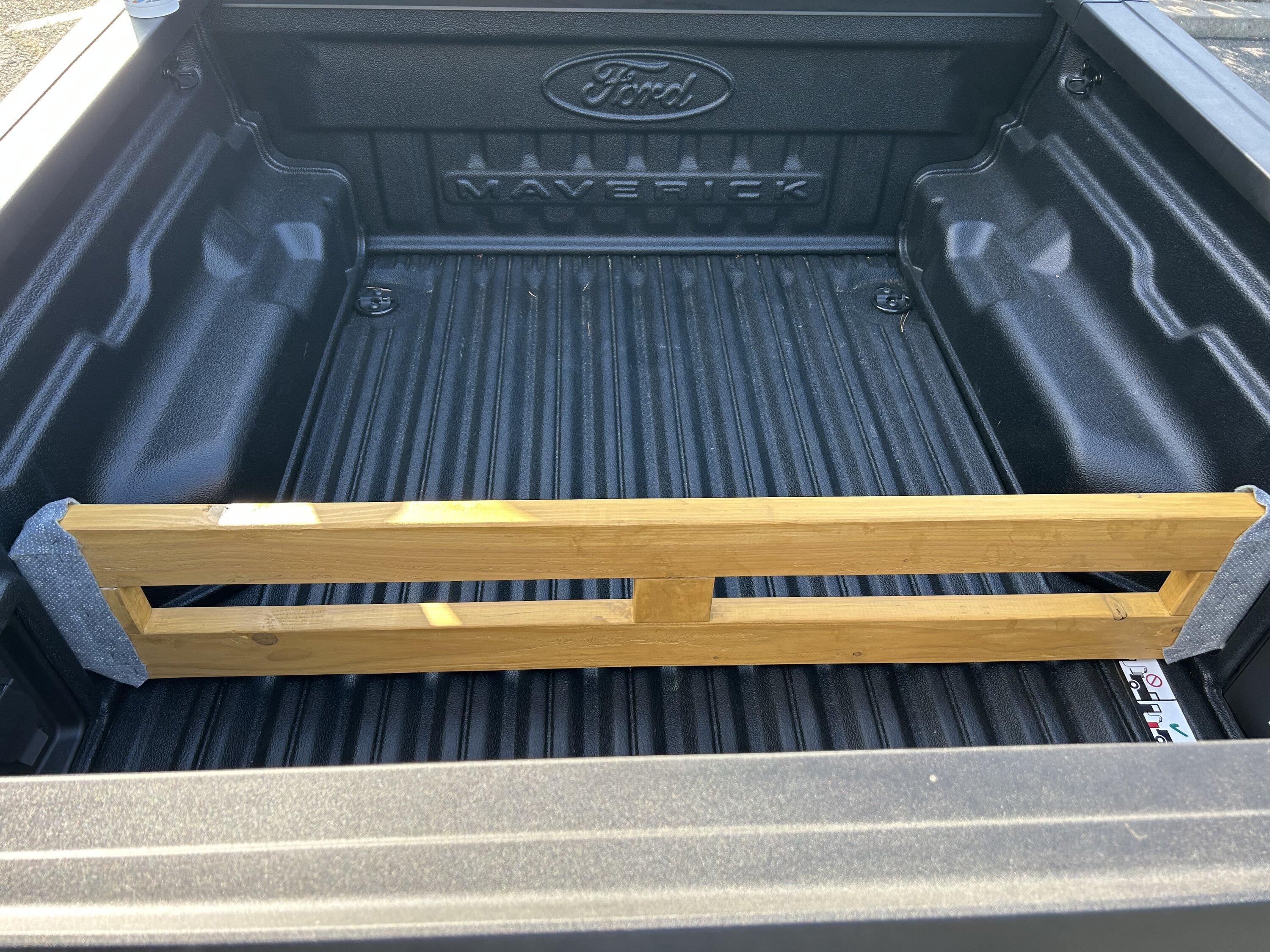

My take. 2x4s with 3” pocket hole spacers. I cut 45s in the corners to make removing it easier.
Ford Maverick 2x6 Bed Divider for the Flexbed IMG_0102
Ford Maverick 2x6 Bed Divider for the Flexbed IMG_0103

Unless you have small grocery bags, thi was lighter and easier to make.
