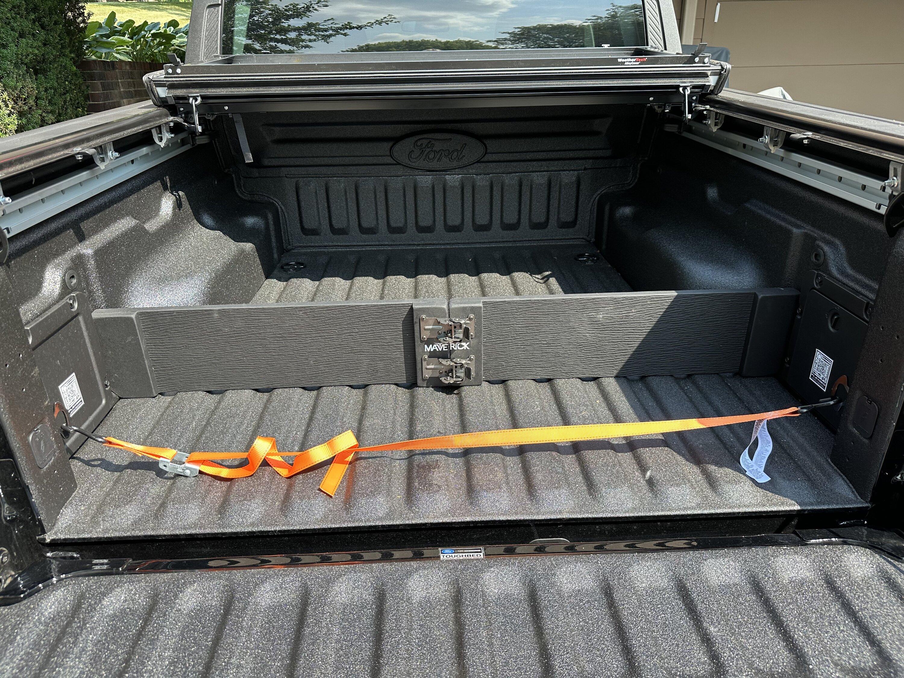

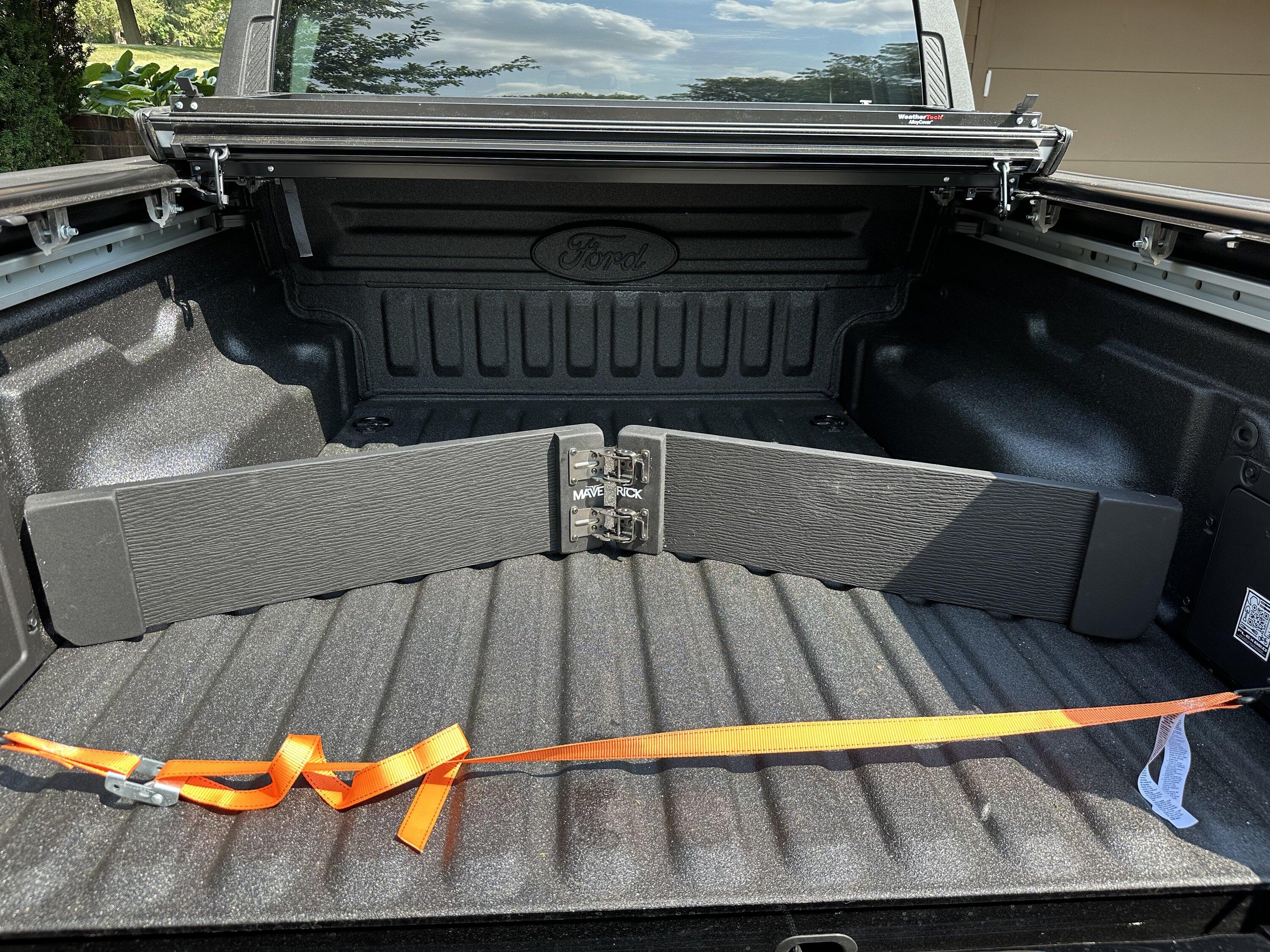

Rather than using a heavier 2x4, I used a 1 inch board and wood glued a small piece of the same board at each end so it fills the same space in the slot as a 2x4. I have 3/4” more of bed space on the side with the spacers. If the glue does not hold up, I will use wood screws.
