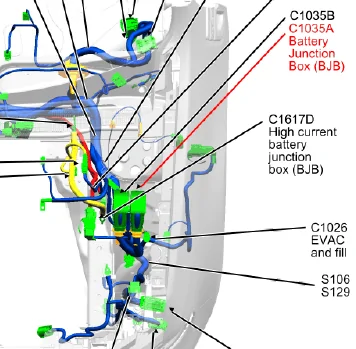

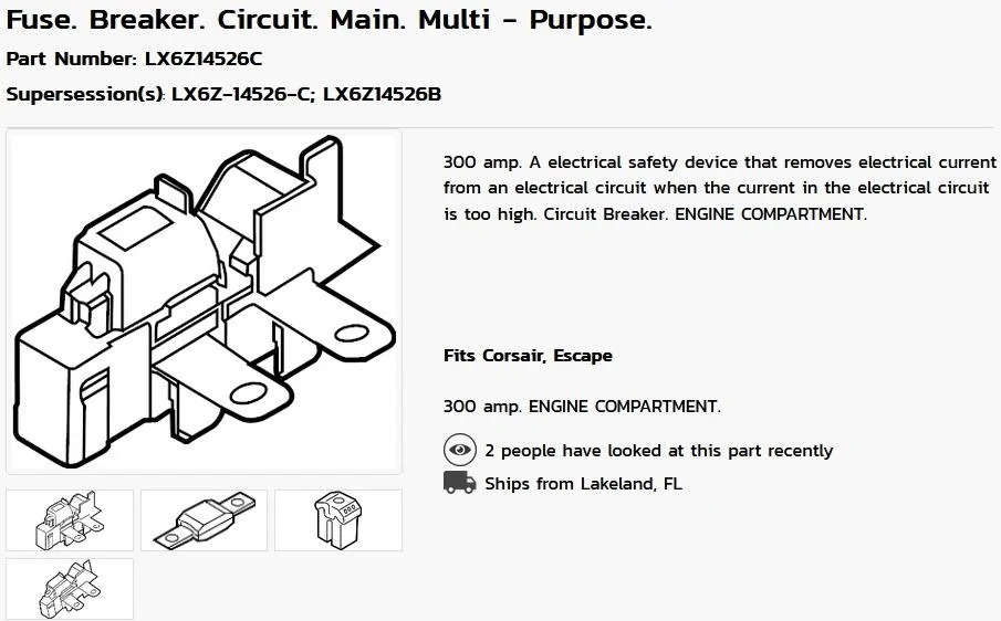

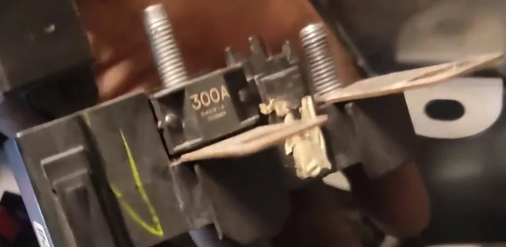

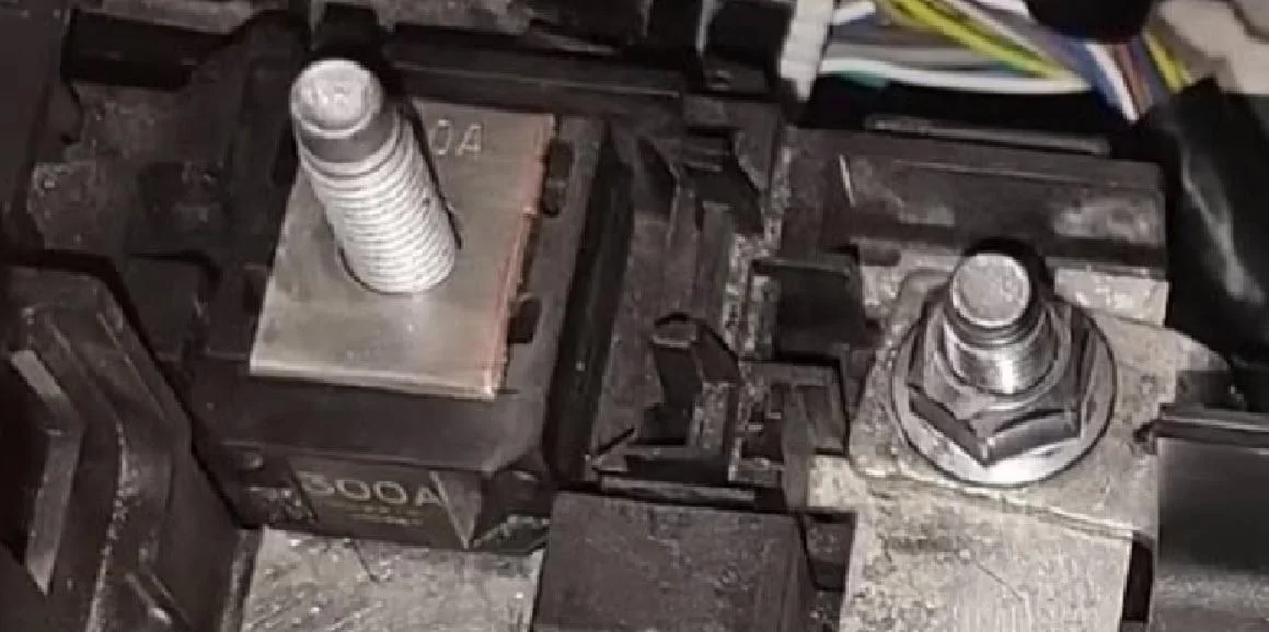

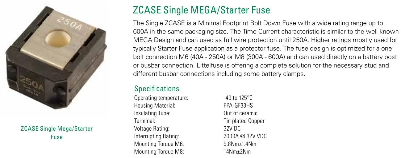

I have seen this mega fuse actually develop a crack ( typically caused by road shock/vibration)which can intermittently allow the loss of electrical charge to the battery, I've had them where they test good with an ohm/continuity meter laying on a bench but then with a little pressure applied to each end will test open.
Do you happen to know if this Mega fuse is a ZCASE fuse that bolts in this assembly or must replace the assembly?
Thanks
Littelfuse - ZCASE M10 32V Series - Zcase M10 32V
Mouser - Littelfuse 3298300.ZXSTA 300A
Ford Maverick Newest Ford special service message on Hybrid 12v Volt Battery Drain Problem ZCASE Mega_Starter Fuse - Littelfus
Ford Maverick Newest Ford special service message on Hybrid 12v Volt Battery Drain Problem LX6Z-14526-C Fuse Main Multi Purpos
Screen grabs from one of the youtube videos.
Ford Maverick Newest Ford special service message on Hybrid 12v Volt Battery Drain Problem 300A Mega in BJB
Ford Maverick Newest Ford special service message on Hybrid 12v Volt Battery Drain Problem 300A Mega Fuse Assembly in BJB

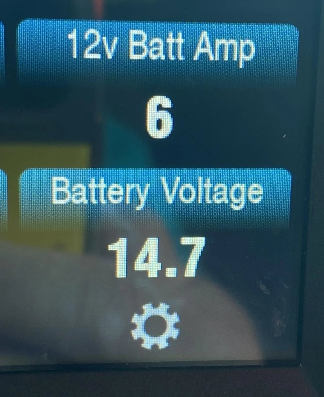

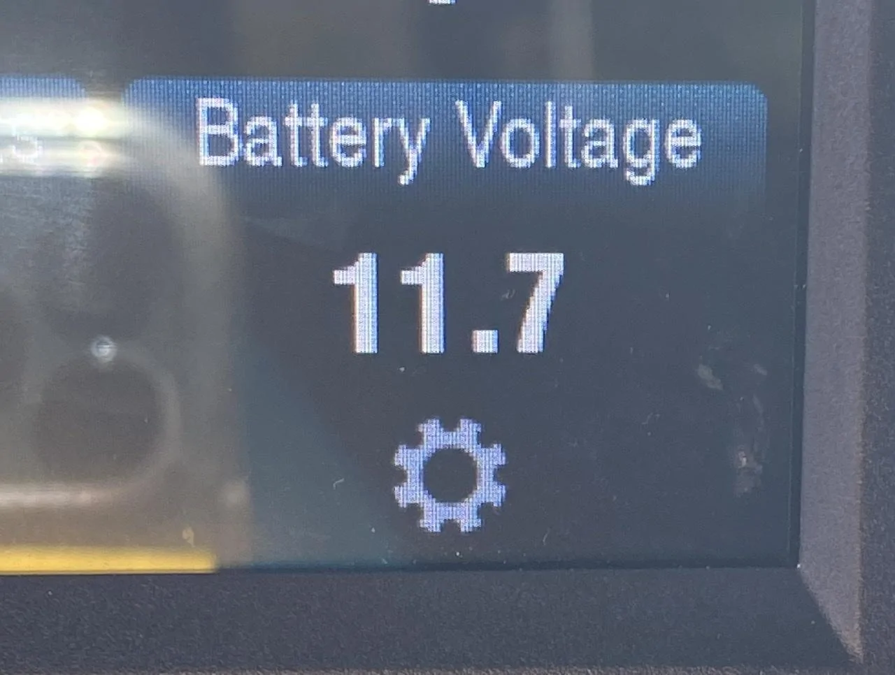

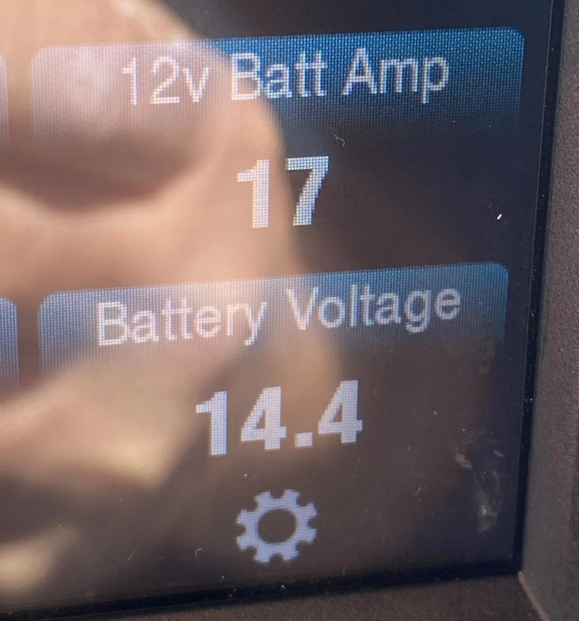

Data:
Parked at 6pm Friday after a 45 min drive.
Started at 11am Sunday.
Sat for 41 hours.
Nights: 50's
Days: 80's
Sunday Morning:
Ford Maverick Newest Ford special service message on Hybrid 12v Volt Battery Drain Problem 56C4B32B-DC11-470B-8A66-69B8BB33CF3E
Key to run, DC/DC converter running:
17 amps recharging the 12 v
Ford Maverick Newest Ford special service message on Hybrid 12v Volt Battery Drain Problem 8EF2DC49-A14B-4DBD-B752-19E091B2AB43
After 10 minutes of driving:
Ford Maverick Newest Ford special service message on Hybrid 12v Volt Battery Drain Problem 75EE152B-3E48-4B0F-A28F-21C89D667559
*** The display is not the parasitic draw. It's on a quick disconnect and I take it in the house EVERY night so it does not get stolen. ***
