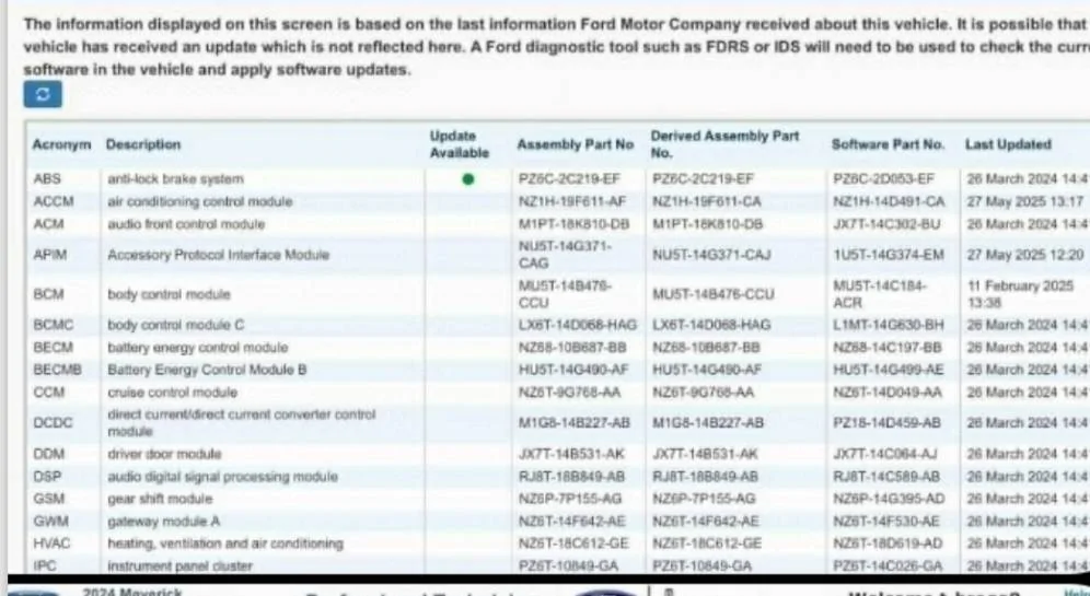

Is my update OK or should I have it addressed?
My advice is this. If you don't have problem with a battery drain, then just leave it as is. But I don't think that this update can be done over the air considering the steps that we had to take to perform it. I could be wrong though. But again if you don't have a problem, don't worry about bringing it in to get updated. But if you do have a problem, then get the update done. By the way the vehicle I worked on was updated successfully today when I installed new compressor.
