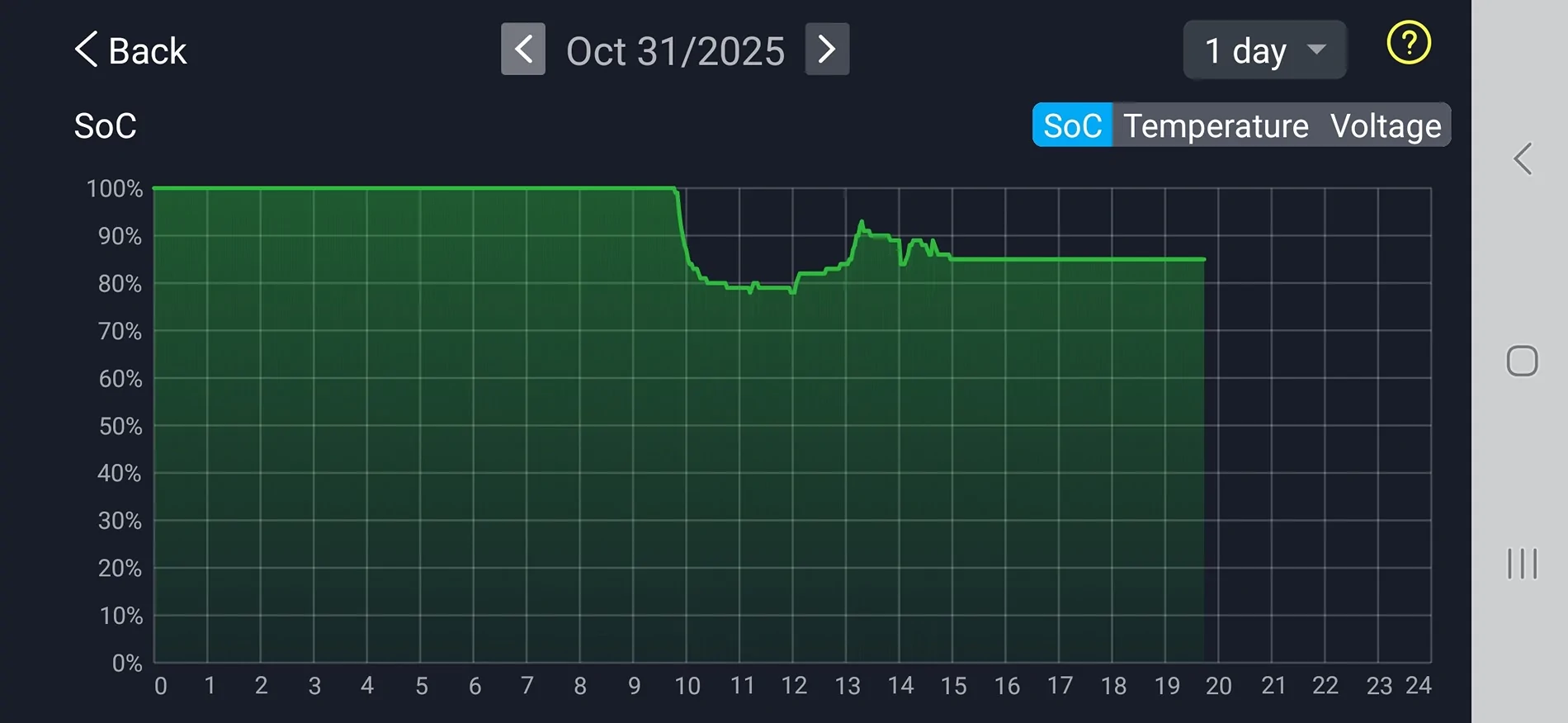

For giggles, I put a smart charger on the posts under the hood of our 2023 hybrid Maverick Lariat Lux. I was able to take it from a 52% SOC up to 100% SOC at a 10 amp charge rate in about 3 hours. Drove it today approximately 15 mile round trip. Parked it back in the garage. Just checked the ANCEL BM200 on the app via Bluetooth and it is currently sitting at 85% SOC. I venture that tomorrow morning it will be down in the 70s percent range. Rediculous that the vehicle is discharging the battery to half of its capacity in just a matter of days. Come on Ford! This is 2025. You should have the capability of finding the chronic undercharging problem and the seemingly unstoppable current drainage.
Ford Maverick SSM 53801: 2022-2025 Maverick Hybrid 12V Battery Drain Issue Update Fix Released! Screenshot_20251031_194556_ANCEL BM200
