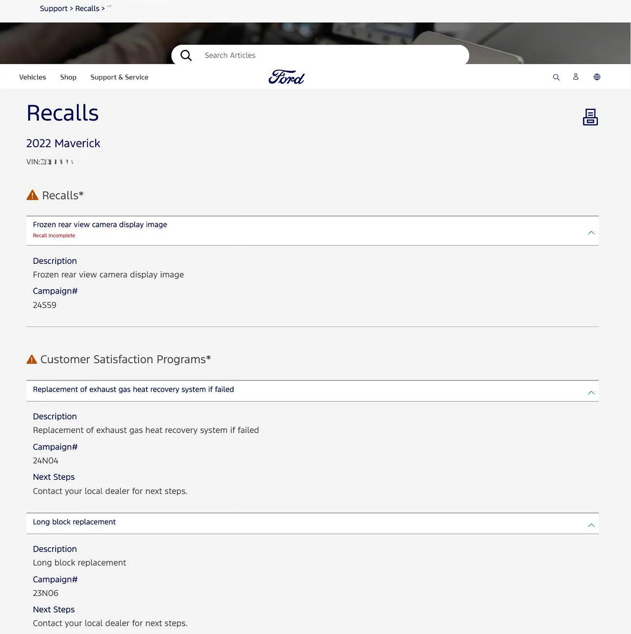

That recall is only for 2.0L EcoBoost Engine Mavericks, not hybrids.
You can always look up what recalls are available for your vehicle. Once on Ford's site, linked below, enter your VIN and all available recalls and customer satisfaction programs that have not been completed will be listed like below.
https://www.ford.com/support/recalls/

Ford is going to be issuing a recall shortly on the 12v battery issue with poorly designed charging. There is a notification to dealerships that if your battery tests bad they are to replace it under a special warranty. You shouldn't be paying anything. If you have they should refund you.
