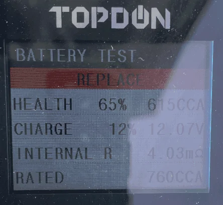

Pretty much the same schedule here, except I only drove about 6-8 miles Wednesday and didn't drive it until Saturday. Before taking off, checked the battery with the tester:
Ford Maverick New 12V battery drain in 3 days! 1701003122575
The voltage meter tester directly on the battery poles showed 12.17V, pretty much like a dying battery. Slammed the hood closed, put away the testers. On my way back, I used the FOB for remote start and it started right up. Took off with the truck and at the second traffic light, the auto stop/start worked just fine, the same for the rest of the way for the 6 - 7 miles round trip. That with the heat, steering wheel and seat warmer on...
