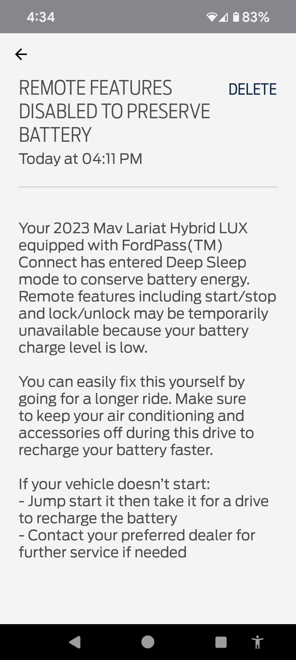

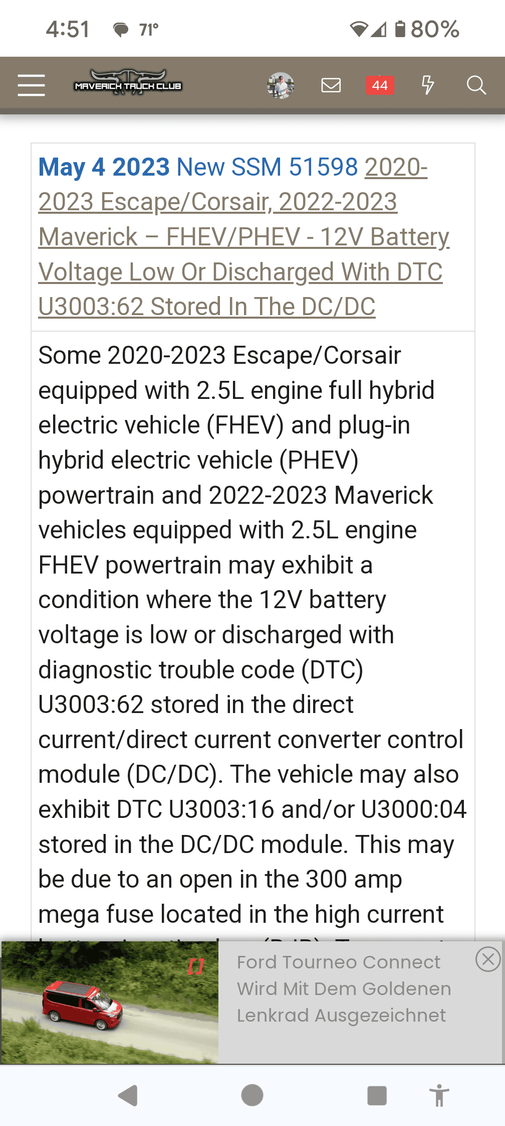

I have a 2023 Maverick Lariat Hybrid and ever since I left my Maverick for a week while away on a trip I have experienced “Deep Sleep” mode that renders my Maverick totally without power, no start, no lights, nothing works. I called Ford Roadside assistance and had my Maverick towed to the dealer. The dealer replaced the battery and reprogrammed the PCM under warranty. 5 days later, after a weekend of no usage my Maverick again went into “Deep Sleep” mode. This time I quickly charged the new battery and drove for 20 minutes. I reported this situation to my local dealer who is researching the issue and any permanent fix from Ford.
I found a Ford Service Bulletin that may be related to this problem (see attached). I do not want to constantly be concerned with a dead battery on my new 2023 Maverick so I am hoping for a Ford resolution soon.

Hello, I experienced the same issue. Waited one year for truck order, got 2023 model in August last year, and initially, no issues. By October, I started to get Deep Sleep messages, and finally in December, after truck was not used for a week, the remote controller didn't work, had to use key to open door, and truck would not start. 12V battery was completely discharged, my first thought was that maybe I left some light on, but this was not a case. I charged battery, and was free of low battery messages for a while, then they started again. The App advice to drive for a while to charge the battery is useless, I drove 250 miles to have the low battery message back as soon I got off the truck. In January I brought the truck to the dealer to take care of two recalls 23P18 and 23C41. The first one PCM reprogramming was supposed to take care of the battery issue as well. The result was that now the Sleep Mode become permanent, disregarding if the battery was fully charged, or no. Last week I got back to the dealer. They called me to say, that the battery was damaged by a total discharge, and can't be fully charged any more. Since Ford Maverick batteries are unavailable in the Ford system, would I agree they get an aftermarket battery to replace? I agreed, battery and was replaced. I will see how long will last. My personal feeling is that something is draining battery at much higher rate than Ford expected. When I leave the truck and lock it, I can hear relays clicking under the hood and a sound of motor operating, is this a fan? Also, I make sure that the headlights are turned off, they are supposed to be auto-off, but I am taking every precaution to make sure all power is off. Is the truck's communication modem sucking all the juice? I don't know, but It is active 24/7 listening for communication.
