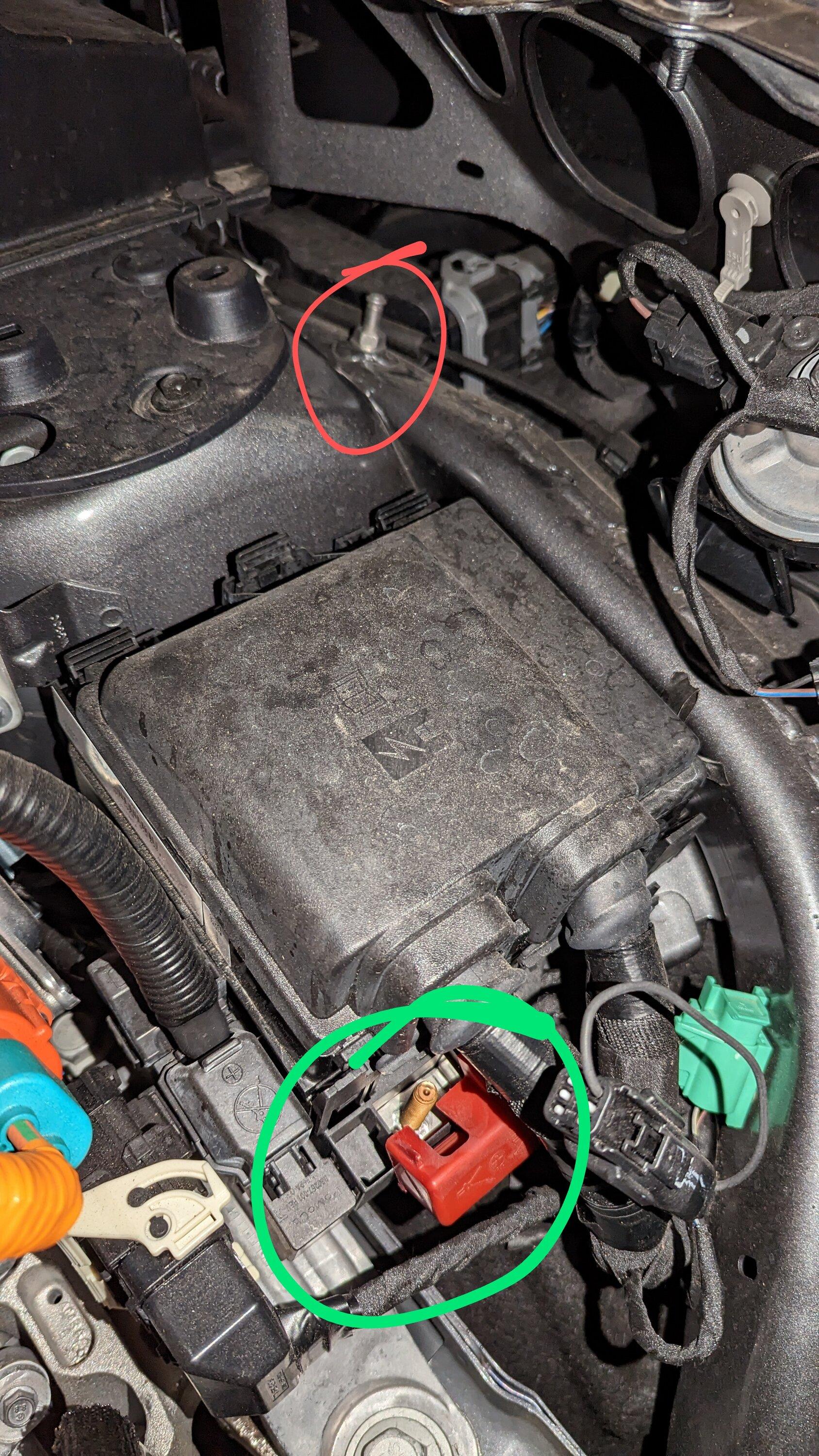

I'm getting the deep sleep messages too. If I were to connect a small, 1 amp battery maintainer, where should I connect it? Under the hood at the jump posts, or directly to the under seat battery? Does it matter?
I would connect to the jump posts under the hood. I just use a battery keeper like You would use for a lawn tractor or a motorcycle. It won't overcharge and just keep it topped. Kind of silly to pull apart the battery all the time. I've pulled off the red positive here so you can see underneath and then the negative post is up on the fender and it's also circled. I've got motorcycles and another old truck so I'm just kind of used to doing this with vehicles not getting used. I think it's cool it gives you a reminder in the phone app if the 12 volt battery charge is getting down there.
I would go with 22XLTHybrid 's cable connection photo little further in this post. When you receive low voltage warning might be a good idea to measure the voltage at the battery and at the posts under the hood near fuse box. Just to eliminate the possibility of bad cable.
