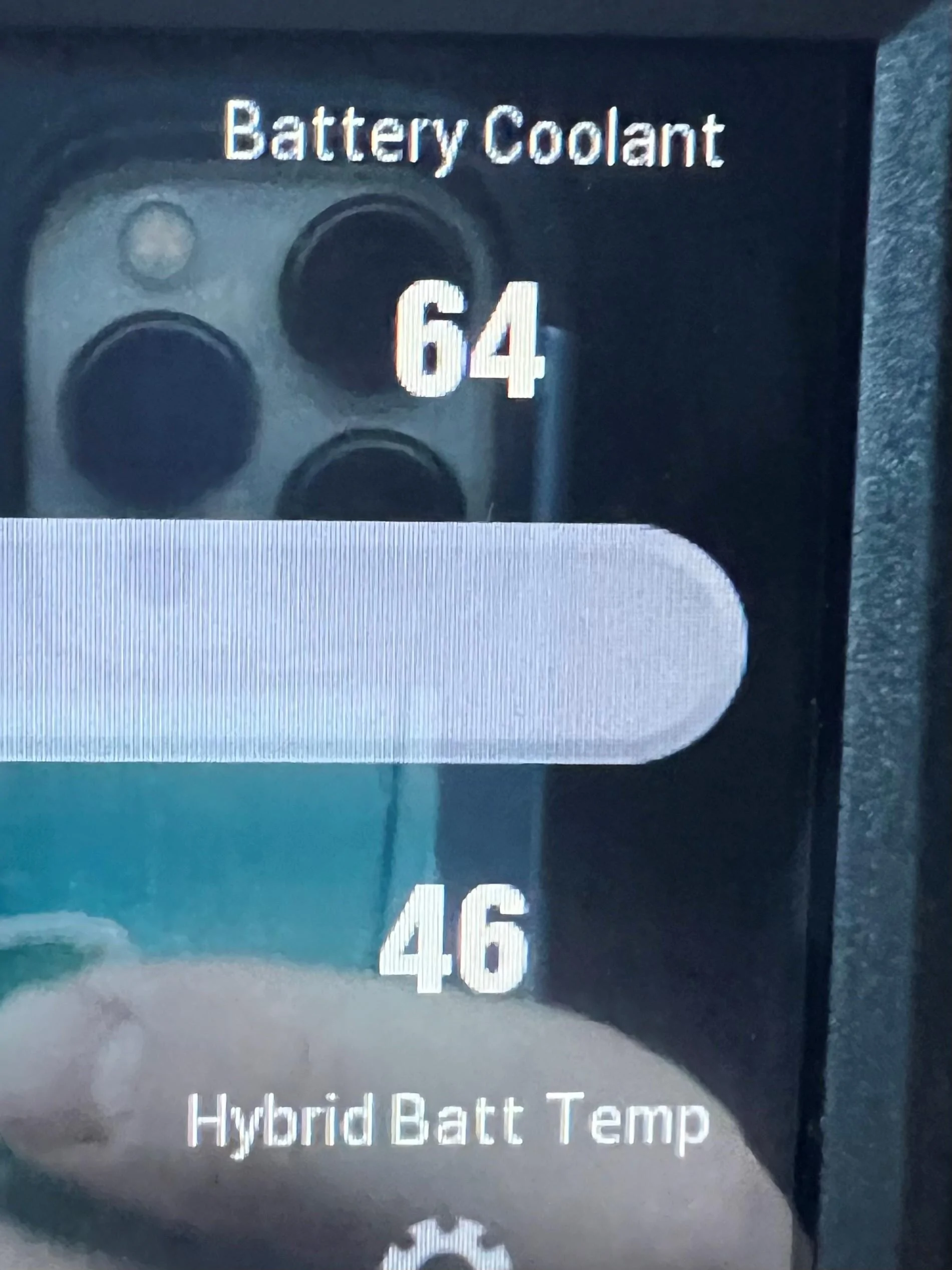

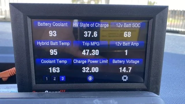

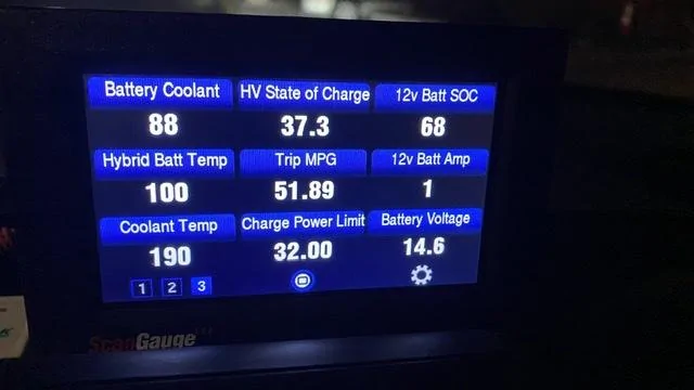

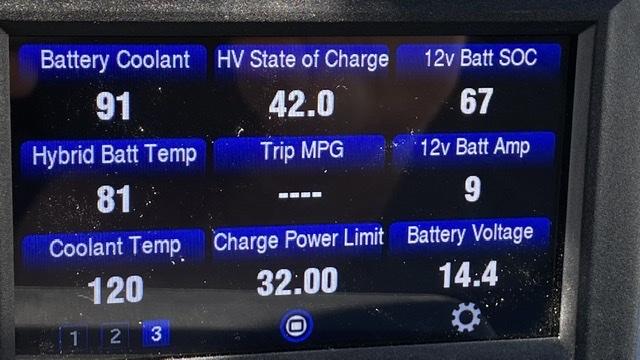

This was a picture I took at startup yesterday in 46* degree ambient temps. I have waited to post this, but this differential is what I am seeing regularly at cold start.
Thank you
You and me both see +/- a 20 degree differential.
I'm seeing this consistently.
It's likely the scangauge conversion is off. The raw data is hexadecimal code that has to be converted to degrees F. You can have degrees C or degrees K or degrees actual times 47 minus 13.8 if that suits your fancy.
Look at it and mentally subtract 20 from battery coolant the next few days and I'll bet things make sense. It does for me. Again today, after being parked all night and everything should be in equilibrium, a 20 degree offset.
58 outside air = 78 battery coolant.
66 outside air = 86 battery coolant.
Afternoons
79 outside air = 99 battery coolant.
95 outside air = 115 battery coolant.
💡115°F battery coolant did not make sense to me before. But now it can be explained if the actual value is 95 like ambient air and cooling was right on the cusp of kicking on at 96°F. 💡
