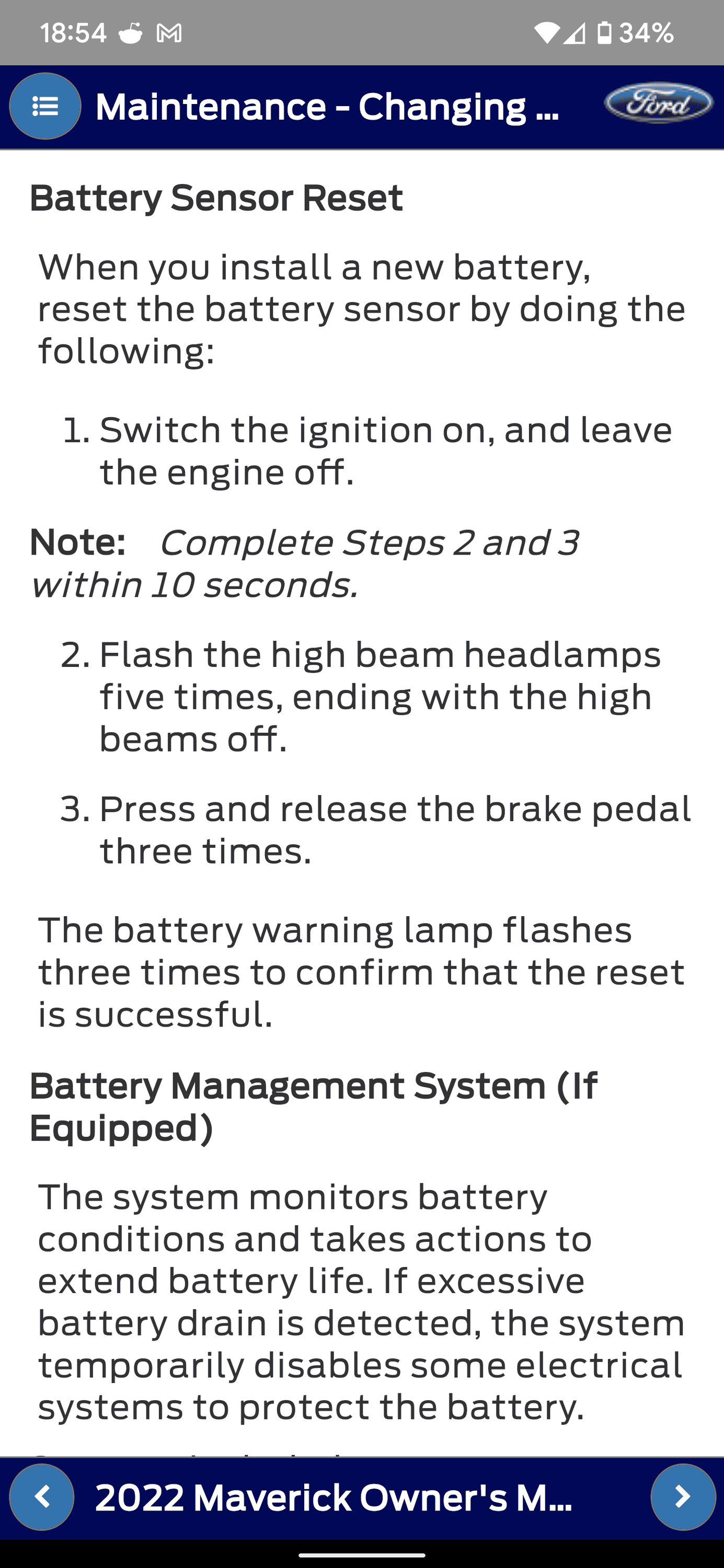

Just checking to see if I am doing this correctly, I fully charged the battery, disconnected from the car, and let it sit connected for a day to recalibrate. I just saw this in another post from the Owner's Manual, so I just tried this too and I never got it to flash the battery icon at the end. I ordered a cable for Forscan but it arrives Thursday. Has anybody done the sensor reset below?
EDIT: It worked, you just have to wait and do nothing after pressing and releasing the brake 3 times, wait and watch the battery light, after about 10 seconds it will finally blink.

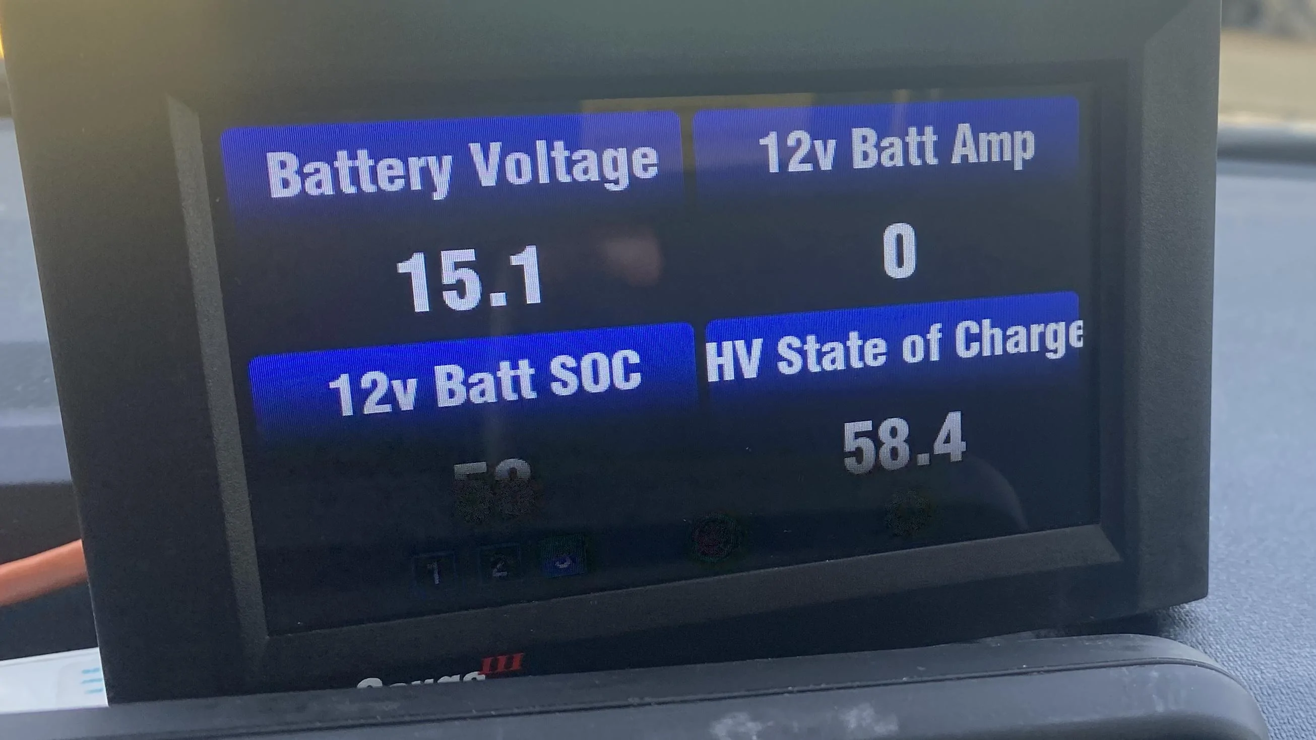

This at first key turn:

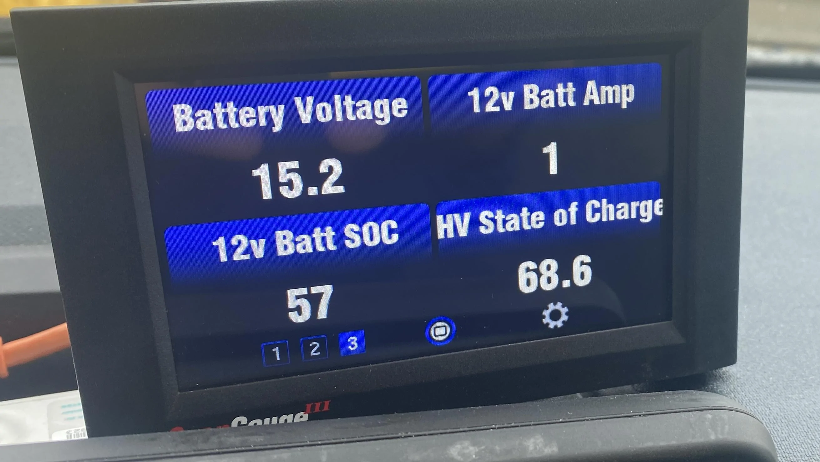

This after 40 minutes drive:

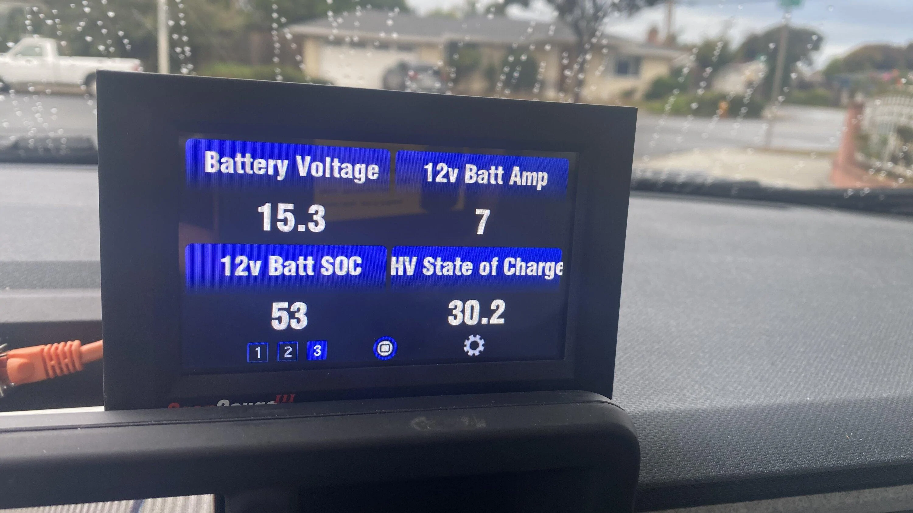

This after 80 minutes of driving:
Ford Maverick New 12V battery drain in 3 days! IMG_8919
Hard to see the last one due to shutter speed sync but I think you can make out 58% charge and zero amps going into the 12v battery.
BUT THE TRUCK STARTS AND GETS ME TO WORK EVERY DAY. SO YOU TELL ME: do I have an issue or not????
As long as it does that, you don't have an issue. At least, that's the attitude I have with similar battery/charging issues on the EB 2.0....
wow, at that high of voltage I would say it can't be anything but 100% SOC. I think for some strange reason the truck thinks it's 58 but it's not correct.
It shows 0 amps so the converter doesn't seem to be feeding it.
The truck is shut off correct? If so I wouldn't worry about it.
