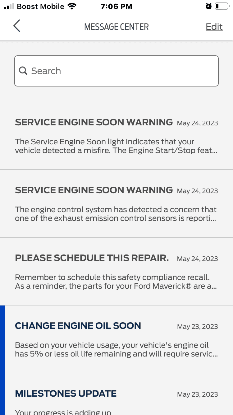

Here is my ford pass log
Ford Maverick My Ford Maverick EcoBoost caught on fire and exploded!!! 🔥 IMG_0016

You had only 5% left on your oil? You were well past the orange in the app. How many miles were on that oil change?
That didn’t matter any way. I had it planned to do the oil change on the 25th of May. I usually do it every 7500 miles even though Ford recommended every 10,000 miles.. The emissions had a problem at 1:47pm and a few seconds later the engine was misfiring , 15 mins later the firemen had put out the fire.

I know it didn't matter, but it just surprised me. I went 10k miles as recommended and even the the app said I was still around 20% left on my oil.
I know people are jumping on you, and I'm not exactly in your corner on this one. Live and learn. You're okay. Your family is okay. Vehicle can be replaced. It clearly was mechanical failure of some sort. I just would be careful with what you say or post because you want them to own up to it. Adding oil to it was probably not the right decision. You literally added fuel to the fire. Oil spray on the engine is either (with misfire diagnosis) a blown head gasket getting to the pulley. Or, you had a fracture in the head/block that was pumping high pressure oil in a spray outside the engine.
Either way, leaking oil, you can usually argue to limp it home/dealership/etc. But spraying oil? That's a no.
Leave the hood open to reduced trapped heat. Let the engine/block/exhaust cool and have it towed to the dealer to find out if/when you're getting a new engine.
