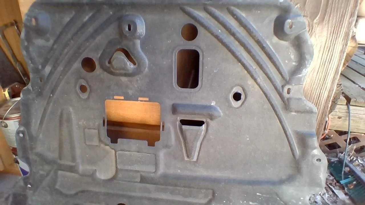

I have a 2023 hybrid delivered from Mexico in December...it has been recalled. It has 8000 miles and I live 50 miles away from work and family and its all mountain roads! From the reading I have done the front end is really enclosed and can trap fluids and vapors...so I took off that lower plastic/carboard shroud..,lots of places it could hold gas and oil.
Do you see all those openings in the under engine guard? Those are the same holes that dealers drilled during the first recall. Yours was done at the factory. Put the damn thing back on, my man! It helps protect the underside from road debris and such.
Thanks for the recommendation!
