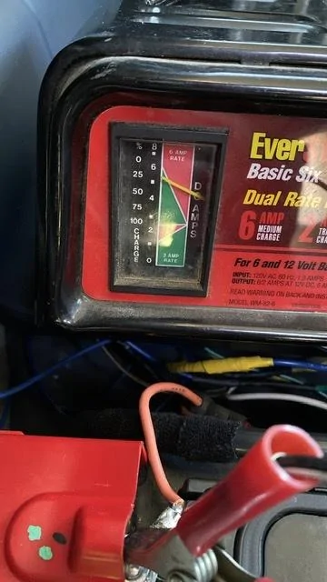

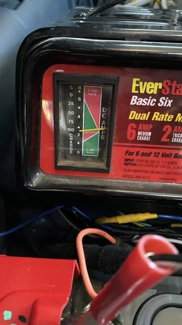

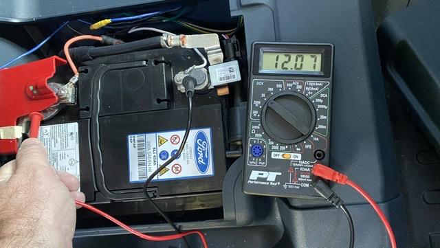

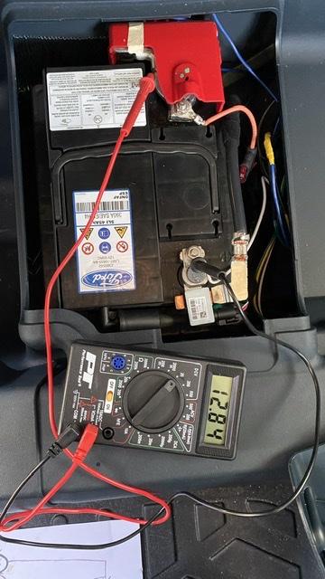

I don't know how much more proof my dealership (Ford) needs. But here it is.
AFTER a 40 minute drive as soon as I got home, like less than 5 minutes after I turned the key off I attached a 6 amp charger. And my stock battery took nearly 6 amps. 52 minutes later the charge rate tapered and the battery was considered 100% and was testing at 12.84 volts no load.
Just sat 14 hours (over night). 14 hours later, 12.07 volts no load.
