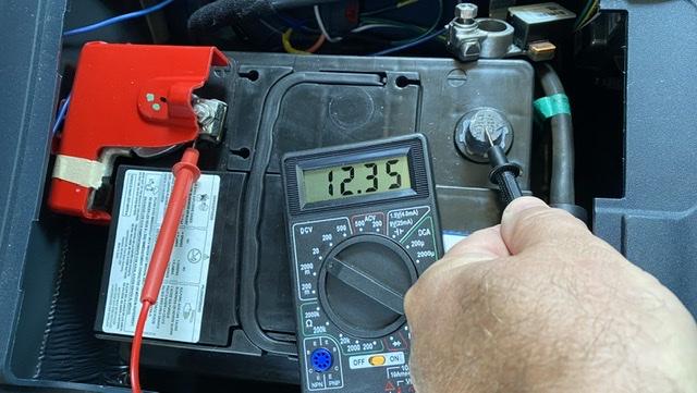

The plot thickens.
Again, mine showing 11.9x this morning.
This time I removed the negative.
Then it shows 12.35.
Put it on a charger. Charger says starting condition 25%.
I will charge the battery and let it sit disconnected a while and see what happens.
