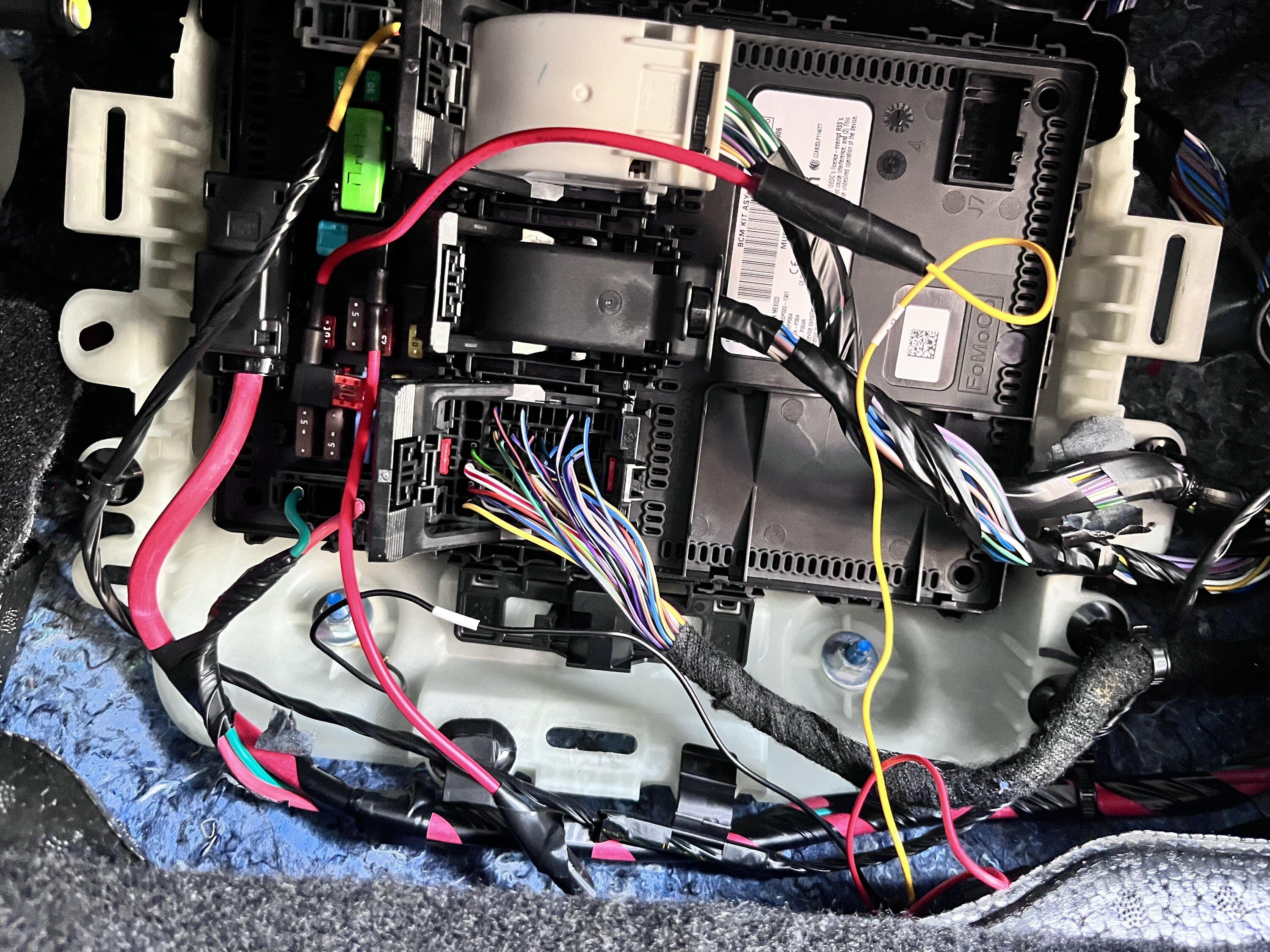

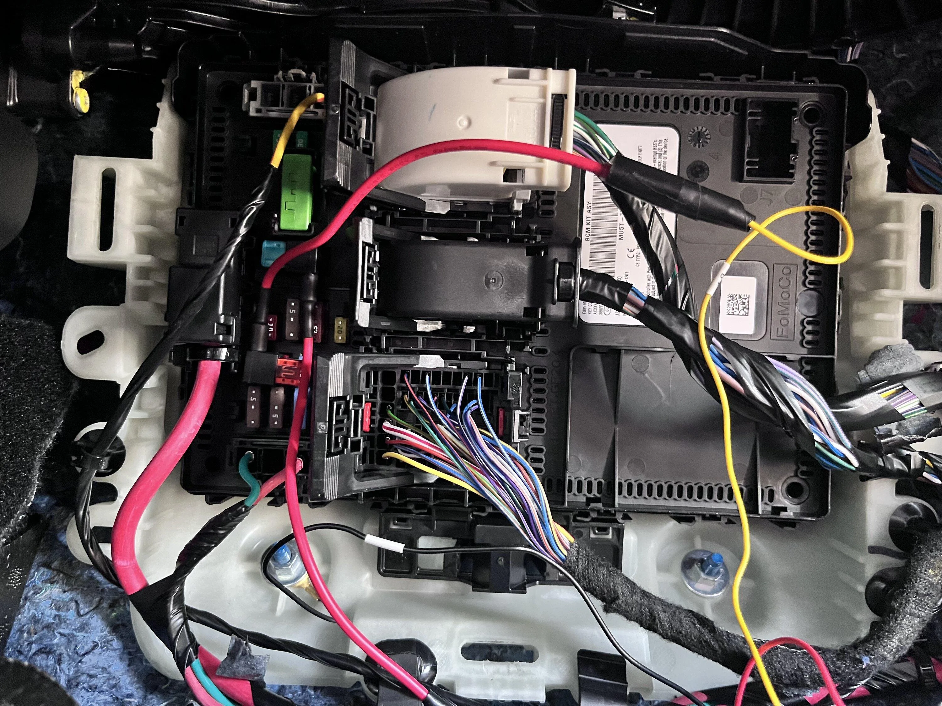

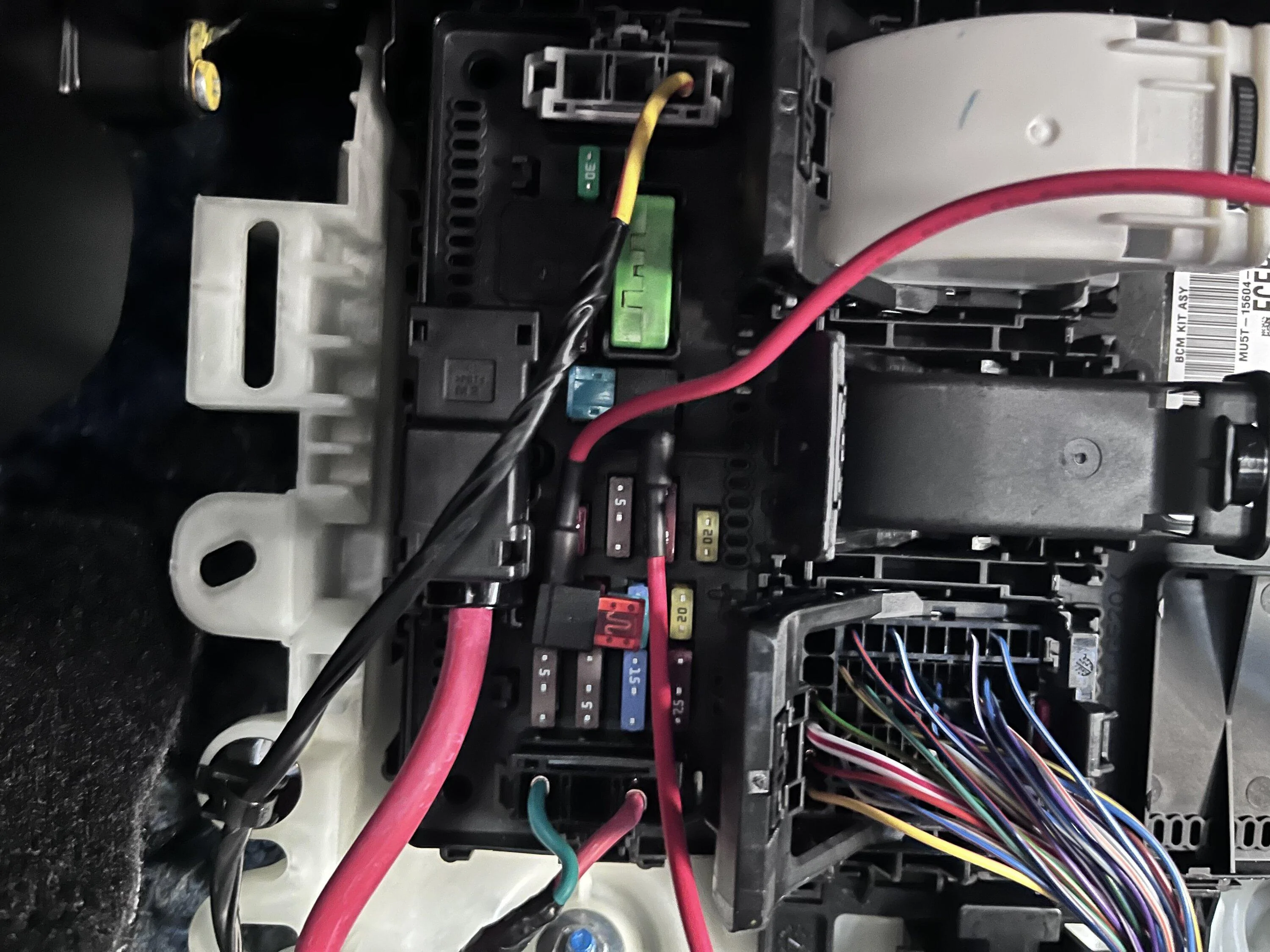

Having an odd issue.
Have my dash cam with accessory and always hot with the fuse jumpers as shown in my image.
most of the time the dash cam will turn on when the truck does. Sometimes it doesn’t.
It’s so strange that it’s not consistently one or the other. Any ideas?

Thanks for the pics those are helpful. So it looks like you're plugged into Fuse #3 for ignition-only power, and #20 for constant power.
My first thought is to check if there's any way to be sure that you don't have the hardwire kit wires plugged into the wrong fuse. By that I mean, possibly having the "accessory" labeled wire plugged into the constant battery fuse tap.
If that's not it, then I might suggest disconnecting the rear camera (if you have one) and see if that affects the failures to (re)boot (from parking mode?). That could eliminate a potential issue with rear camera.
Another thought: maybe also try unplugging the hardwire kit and using the USB cable that came with your device. That might narrow down if the problem is with either the hardwire kit, or how the software is interacting (maybe experiencing a weird condition) with your ignition-off voltage vs. ignition-on voltage from those circuits or something.
EDIT:
Actually--do you use parking mode? Have you checked your video to see if parking mode video is being recorded for the time periods you think it should? Do you ever get "deep sleep" warning messages through the FordPass app due to the truck thinking your battery voltage is too low?
This is a terrible thought, but I wonder if the voltage is sometimes too low in your ignition-only wire because it possibly could have damage somewhere along the line, and that's causing the resistance to be high, and voltage appearing to be low to the hardwire brick that detects low voltage for power cutoff?

All great info, thank you.
I will check those out when I have a bit of time to do the troubleshooting steps for each.
I do know the plug is securely into the camera, so that's not it. I also know that the cam worked fine direct to USB outlet (no hardwire) but at that time I had not yet connected the rear camera. I'll also disable the rear for a bit to see if things change here.
It does have parking mode but I've not received any alerts for low battery via the app nor have there been any "incidents" to track parking mode success of vehicle-off activity. I do wonder if there's something with the parking mode in-line "box" that I may not have done properly - mounting? position? interference? etc.
But for now you've given me some great suggestions for incremental troubleshooting to help narrow down the problem variable.

Quick update
1) parking mode was off. I’ve set it to “on impact” with no success. Guess I should try the time options?
2) the manual shows fuses 3 and 10 to both be 10a. But the manual for the hardwire kit says: “Note: Use an ACC power supply of 15A to 25A. Use a constant power supply below 30A.”
This means my constant is fine but ACC is probably low? Should that matter?
If I remember, the “spare” fuse numbers are not actually hitting power and just hold a a spare fuse? But the radio is 20a so moving to 23 satisfies the tech req
I am blown away at the randomness of working or not so maybe the fuse size being too small is really the issue.
As for when parking mode should record. If it’s on a “time” setting it should record as if the truck is on and turn off if battery is down to a certain voltage?

Just to follow up in case anyone else is a big dummy like me.
I connected yellow as acc and red as hot instead of the reverse which is correct. Maybe too much home wiring lately and seeing red as hot and load vs yellow made me go the other route.
with red as ACC and yellow as hot it joe functions just as it should in every way.
moral of the story - double check colors. Don’t assume. And don’t be a dummy like me.
