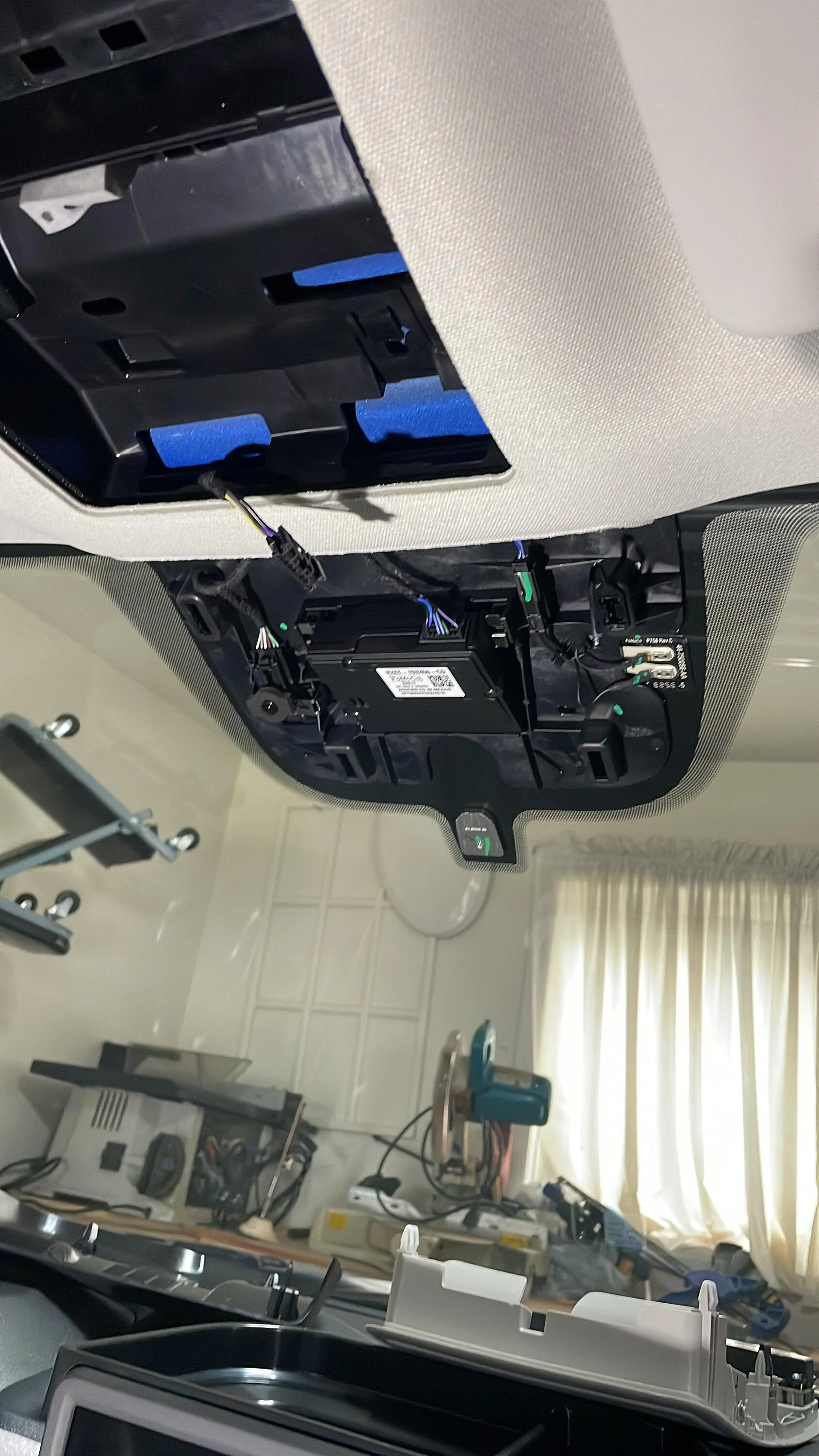

Ford Maverick DIY How-To Video: Hardwire Front and Rear Dashcam 064CABCF-E535-41C7-BECC-DBE5951E304B
I installed a dual usb plug inside the front factory camera housing taped power supply to dome light for it now I have just a short cable to my dash cam

I finally finished my dashcam hardwiring project in the 2022 Ford Maverick. I'm using the VIOFO A129 Pro Duo front+rear dashcam. This process can apply to many other vehicles and dashcams as well. Long video but I wanted to capture some of the various pitfalls as I was going through it. I ran a 18ga 3-wire cable from the fuse box to the cavity above the dome lights/moonroof switch so that I could also easily tap that power for another device (probably auto dimming mirror) in the future when I get around to it. If you only need to wire a dashcam, then you can use the hardwiring kit without the extra 18ga or 16ga power line, that was just my personal desire.
