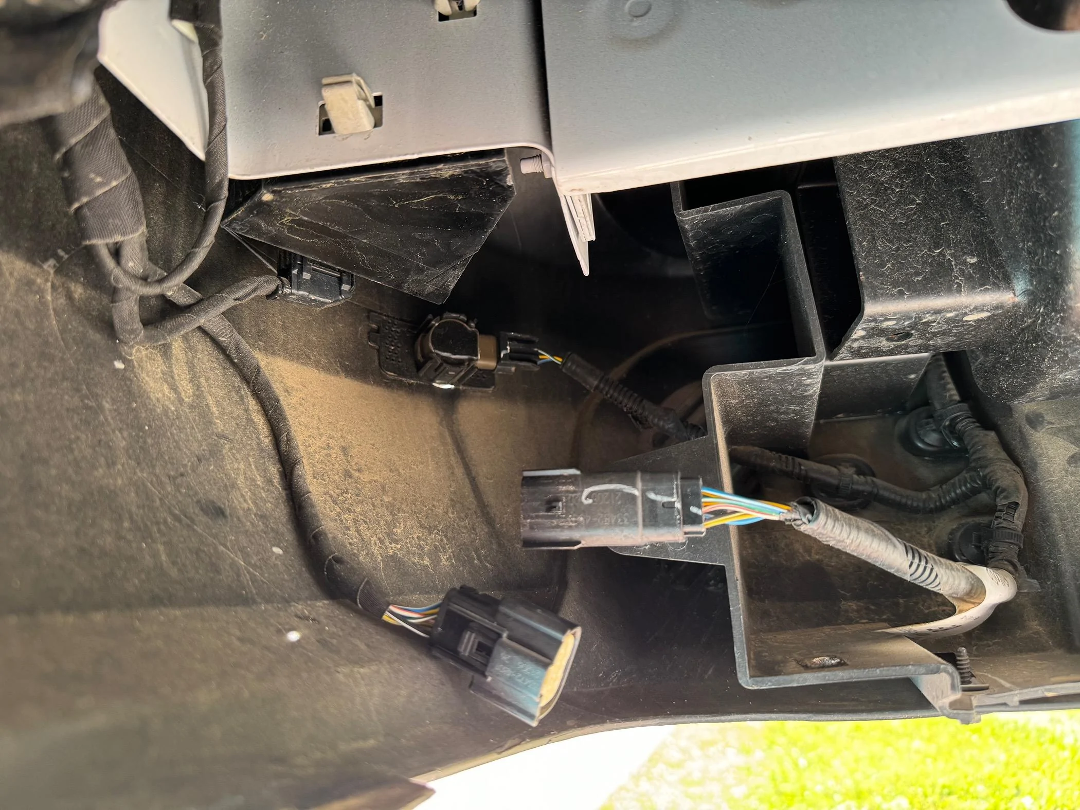

It's super easy to unplug all 4 sensors with 1 connector. I've confirmed that the cross traffic alert system still works.

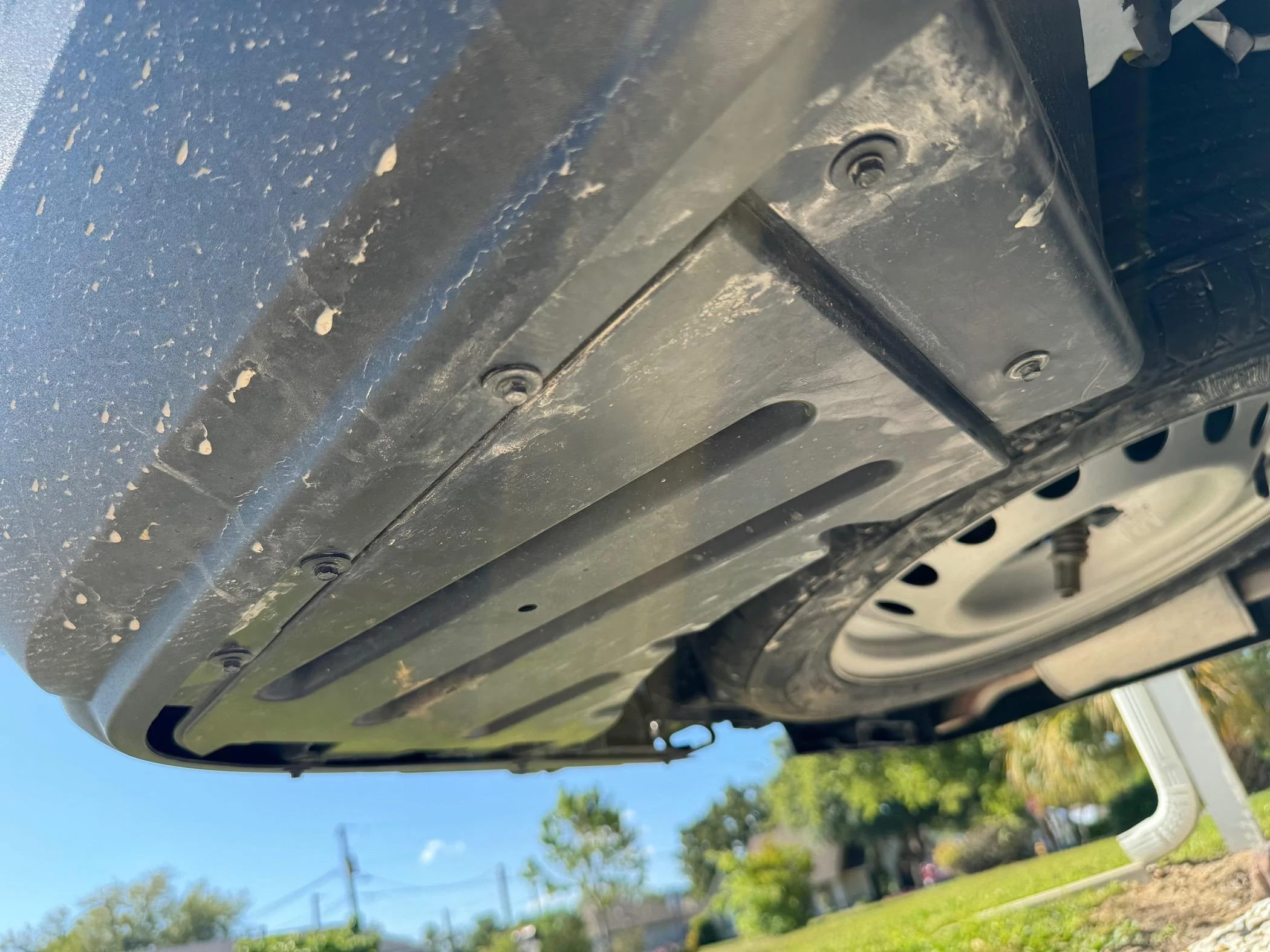

1. Remove the plastic cover shown below
2. Unplug this connector, tape/secure it to something, and put it all back together
3. No more constant warning tone, don't run over anyone.
