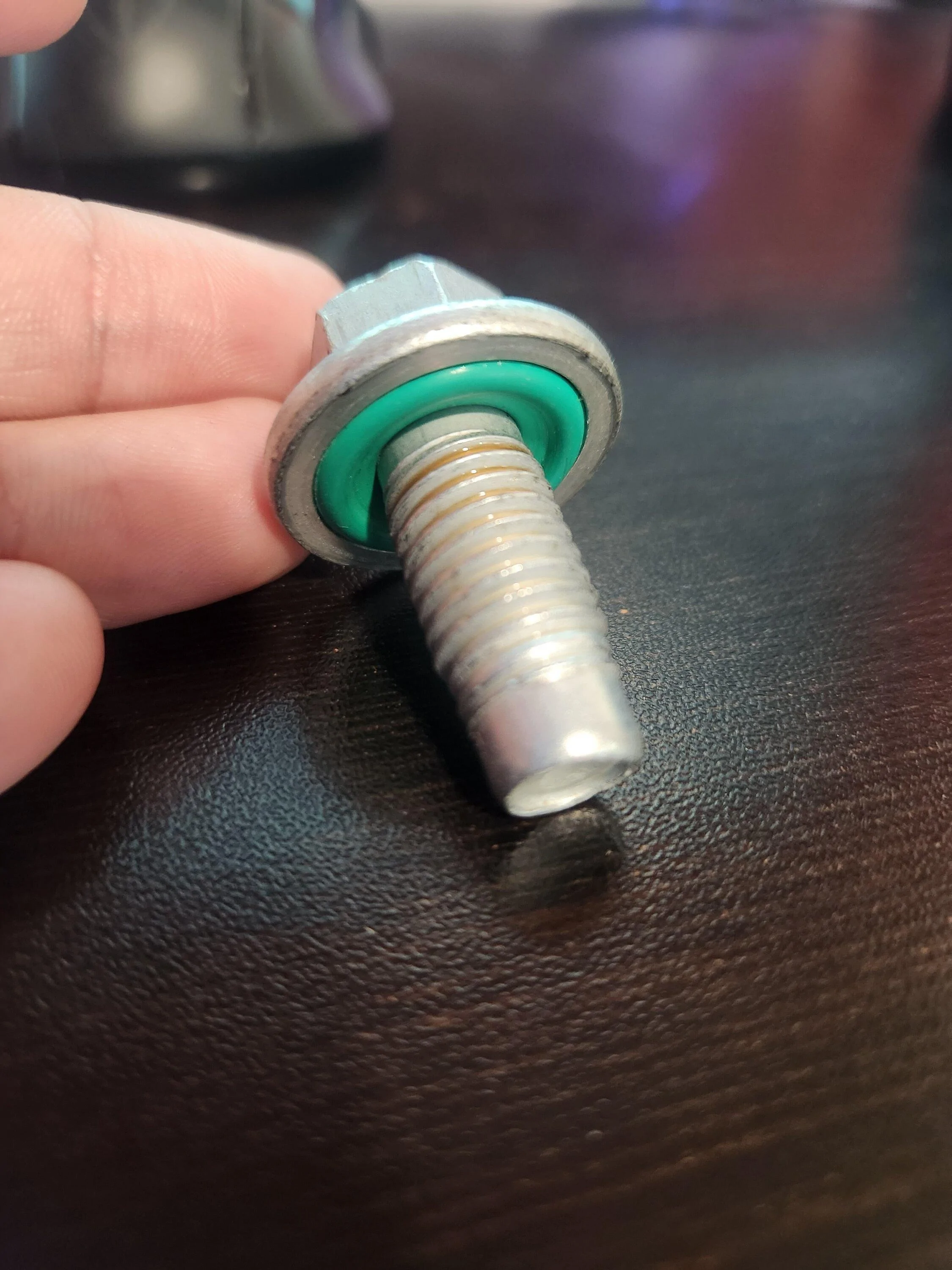

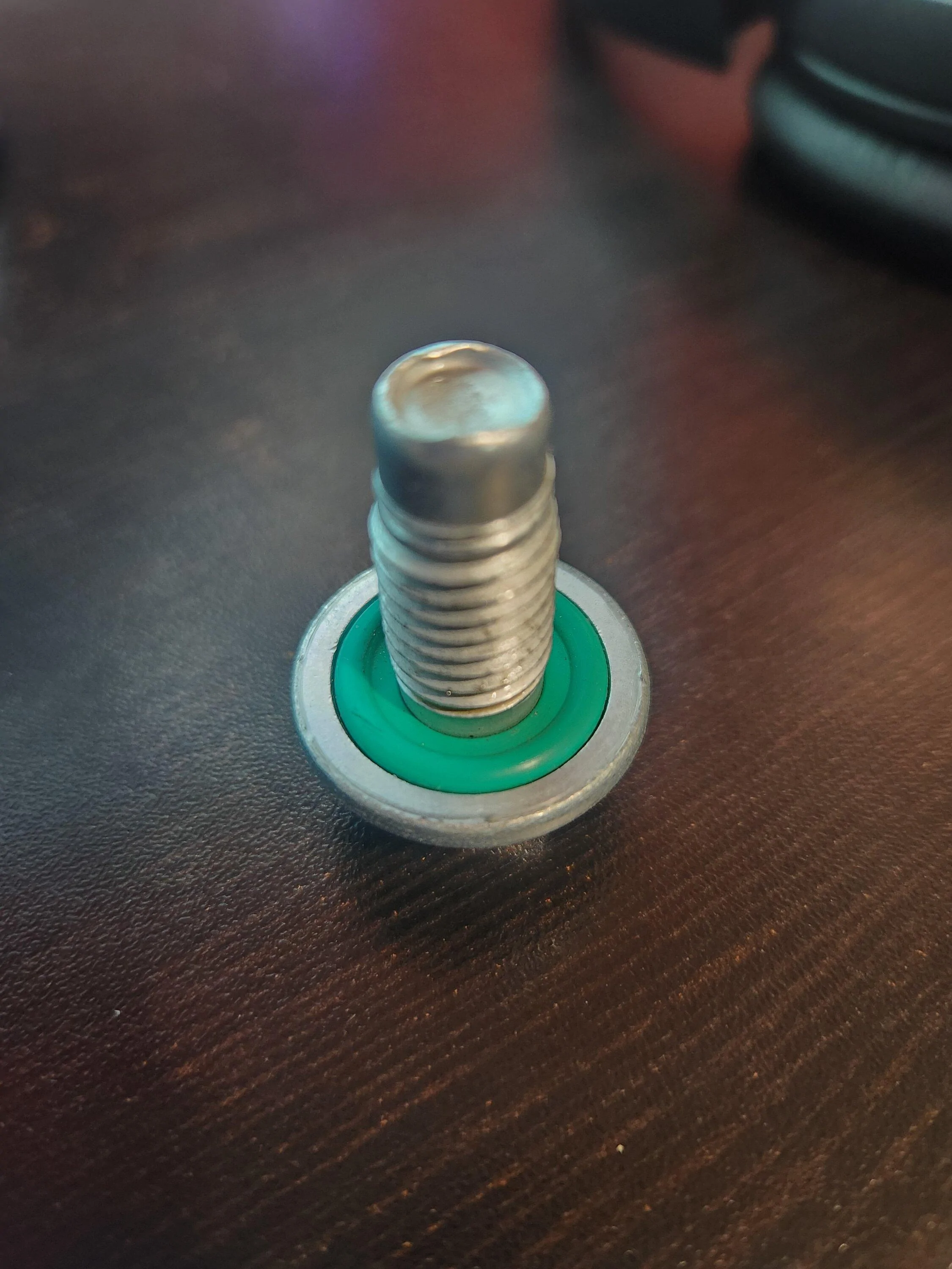

Check thread sizes...make sure your threads are the same and it so it fits. I never consider Amazon to be accurate. See if Rockauto lists thread size for your car. I just had it out and was going to take a picture but did not. It is a nice plug..mine has a green silicone molded gasket and looks a lot like the factory one but has a magnetic tip on the end that works. Buy at Autozone and don't open until you have the old out out and then compare. I think a 2024 would be exactly like a 2023 and it also said it didn't fit my 2023 Maverick..wrong, it does.. Chrome plated
Do a search on 653096 and you will see others used it too. Mine is an Ecoboot. Don't know what a Hybrid size is. I paid just around $7 at Autozone.

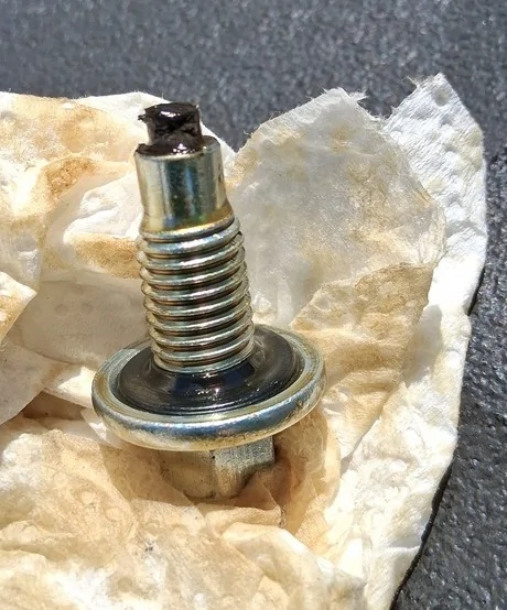

This past weekend I did my first (vehicle's second) oil change and discovered:
Magnetic tip really works, see? Quite a bit of ferrous material grabbed; I won't be overly concerned unless the same amount shows on successive changes.
Ford Maverick DIY Oil Change 178215483476039861
This aftermarket plug takes a 13mm socket, as opposed to OEM 15mm
Seems to have a built-in silicone gasket much like the factory version. Dealer didn't use a crush washer, and no sign of leaks, so I didn't either, just conservative hand-tightening.
