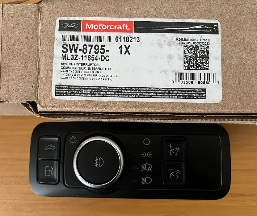

The F-150 switch you listed is. a little
different then the switch I have in my 23 XLT. My switch has the fuel door button and cargo light to the left of the knob, this switch only has the cargo light. I’ve looked for a 150 switch with fuel and cargo light but haven't had much luck. Do you happen to know of one?

Look for one from a Hybrid Escape that has the fog light button.
The SKU for Hybrid is ML3Z-11654-DC

Thanks, looked everywhere but couldn't find.
I've seen them pop up on ebay, which is where I bought mine from
