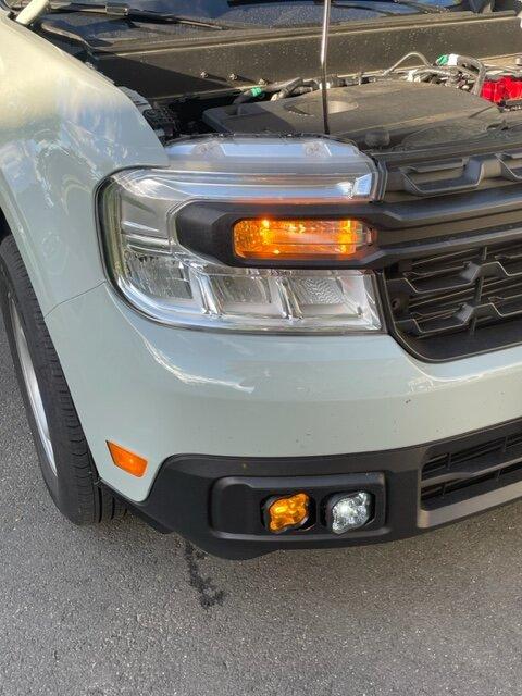

@A.Bursell @Vtec87pr1 thank you for you great write ups. i wound up going with @Justin.23 JJC /ss3 light setup for fog and driving lights combo setup. Thanks to your writups i was able to get the fog lights working however i do have a question i feel like yall might be able to answer. i tried to setup the driving lights using a relay having the trigger tapping into the high beam wire but the high beam wire is hot all the time! i then tried to tap into the high beam signal from the BCM to the Battery Junction box wire and that is always hot too!!!!! any idea how i can find a wire that is only active when the high beams are active?????????? im at a loss this makes no sense....

No, the yellow lights are fog lights that now work with my f150 fog switch. The white/clear lense SS3s are high beam/ driving lights. I’d like to have the driving lights wired with a relay to the oem high beams to come on with the high beams for more light.

I don't recommend having high beams on all the time . But you could used tap the realy to the high beam bulb positive wire .

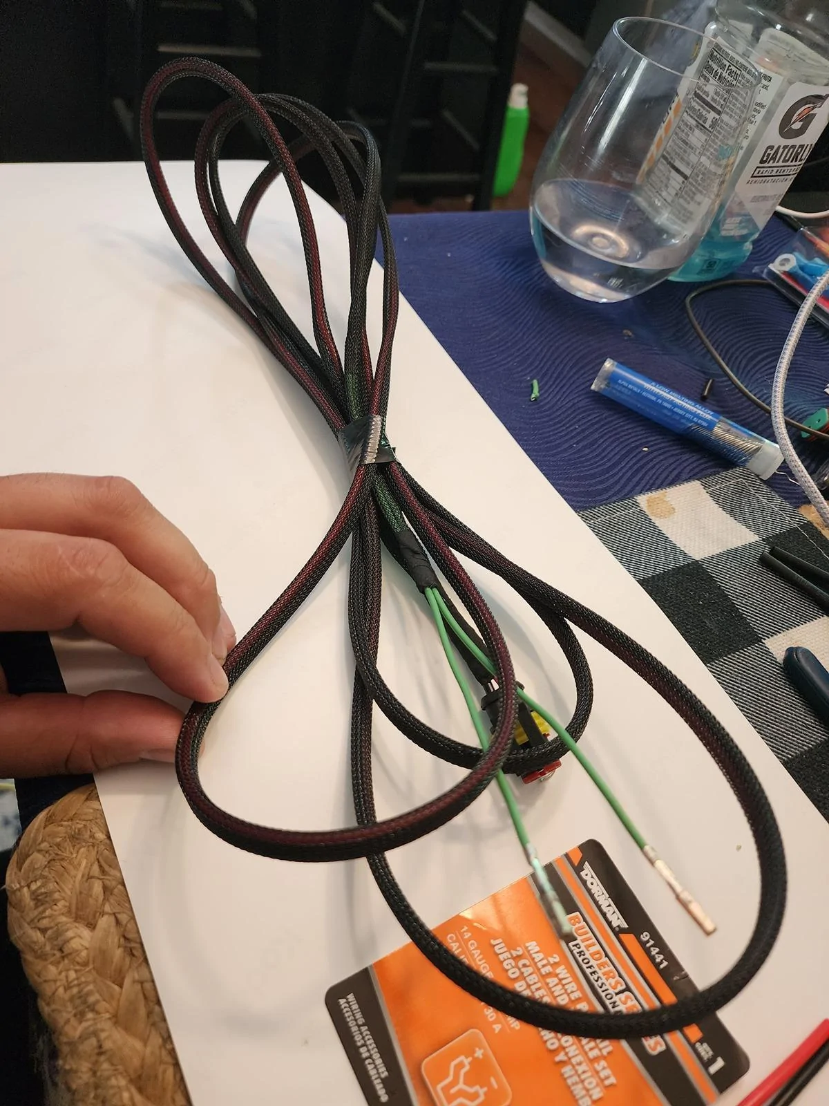

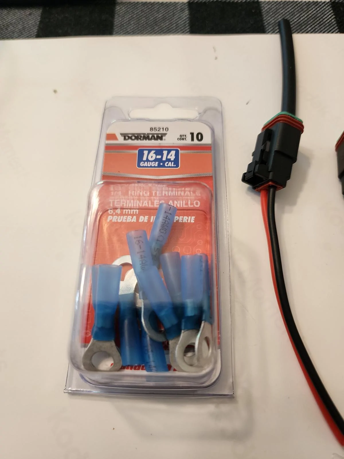

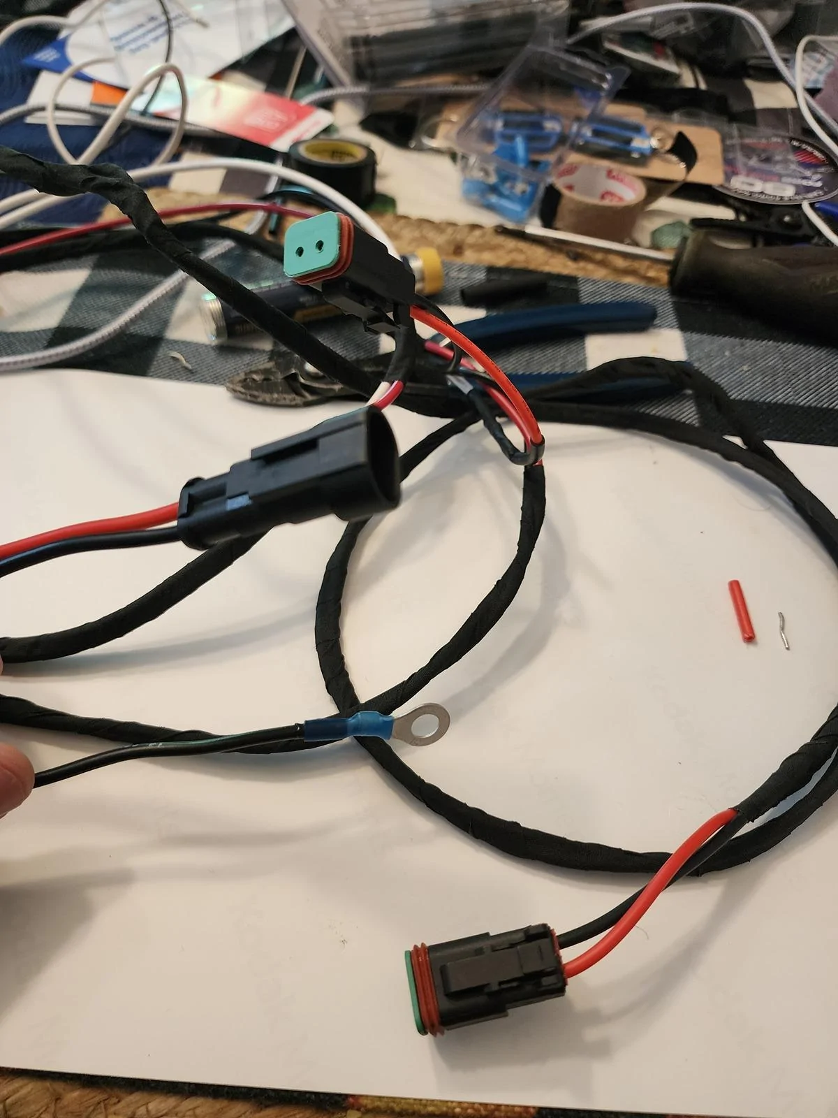

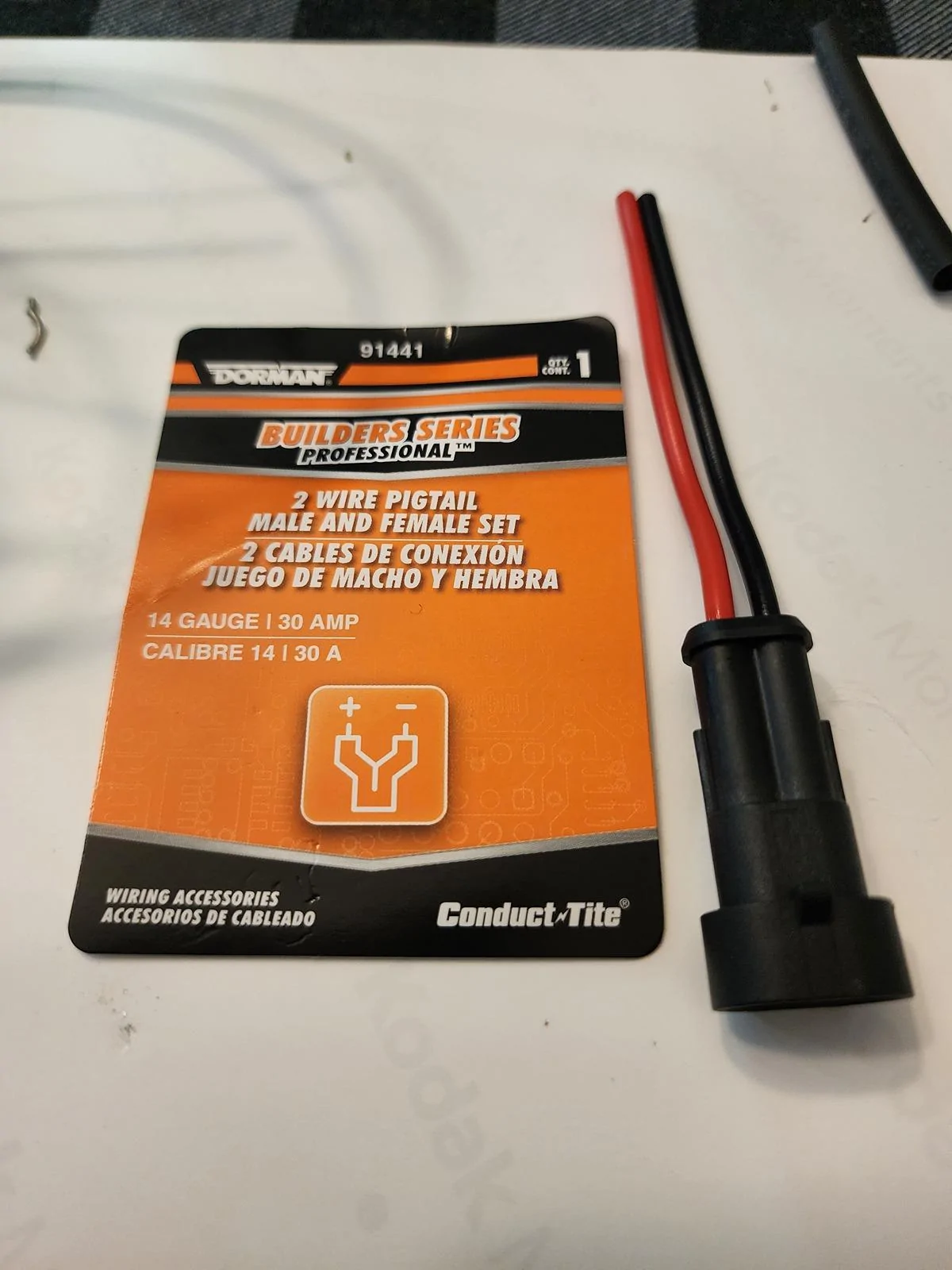

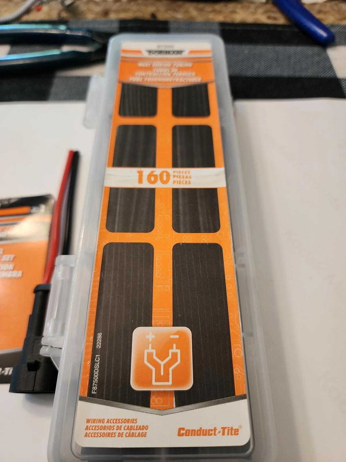

Hi guys . I just want to give thanks to all for the request of wiring and for those that I helped . With their harness.
For the whole harness including the 2 terminals from the bcm to the front bumper I will ask 260.00 this will include shipping . Why the price it's because materials are getting super high. I will try my best to make super easy plug and play other than doing the forscan stuff and adding the 2 bcm terminals. To make it look oem . I will only do this if I get 5 or more request. If not its not worth doing it.
The one simple wire I say simple because you can do it your self. I don't mind doing for 100 dollars including shipping. This wire will go from Bcm to white Triger wire from The diode dynamics . Enough wire so you can trim and hide your self.
Thanks everyone that have help and supported me with my language skills here on the DYI. If I miss something let me know. I might change from expensive insulation to Ford oem vinyl tape.
