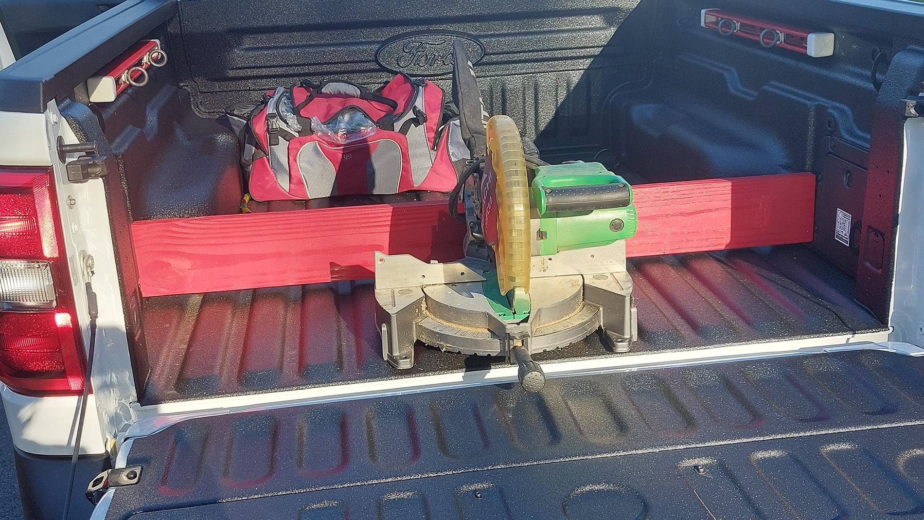

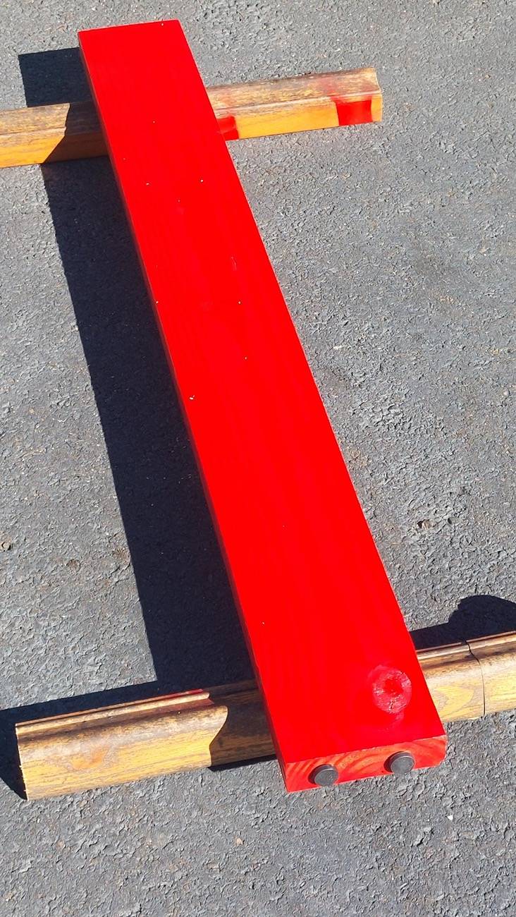

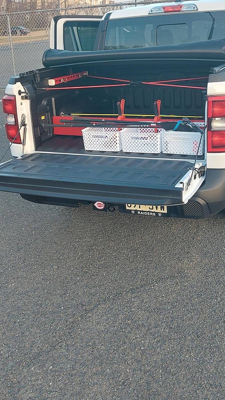

Gotta watch how tall divider is if you put on Tonneua cover, I could not get my foldable golf cart over it without undoing tonneau cover, went from a 2x6 to 2x4 painted divider
and
DIY rails on side with eyebolt (was fun easy project finishing up can of red spray paint from divider)
All off Amazon
1.625" x 1.625" x 24 inches, 12 Gauge, (3 Pack), Galvanized Steel Strut Channel, Slotted.
3/8"-16 X 1-1/4" Shoulder Eye Bolt - Safe Work Load 1,550 lbs
3/8"-16 Cone Nuts, Strut Channel Nuts Zinc Electroplate Finish, Twirl Nuts for Use with Strut Channel (10 Pack) (3/8"-16)
WIKTOPROK 10 Pack Strut Channel Cap for 1-5/8" Strut Channel White Plastic Square End Cap Cover
Anwenk M8 Leveling Feet Stainless Steel Screw-in Furniture Leg Leveler 8mm Adjustable Table
Ford Maverick DIY Bed Divider 20240312_185203
Ford Maverick DIY Bed Divider New_20231013_01
Ford Maverick DIY Bed Divider New-20231013_02

You know, putting these on the end is a good idea. you can cut it slightly short and still adjust it for a snug fit. if the wood expands/contracts from weather you can still adjust.

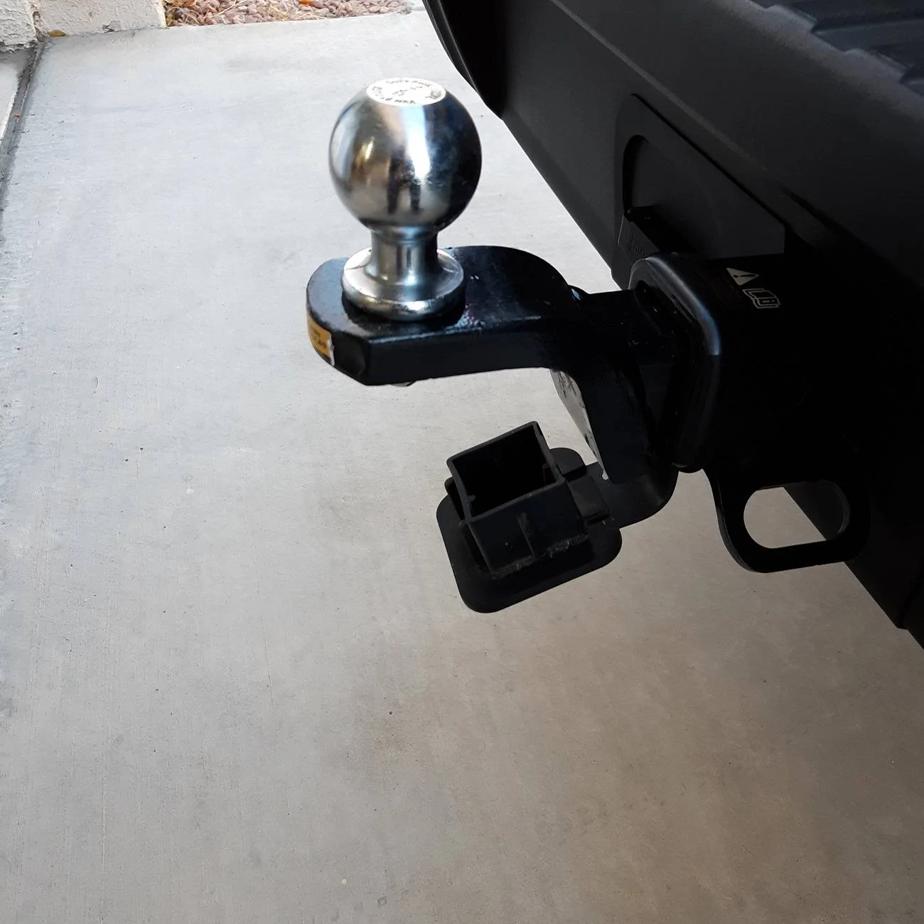

You have a 2" receiver on the back of your trailer and you put the plate there.
(it's not uncommon for trailers to have a 2" receiver. Most use it to hold bikes or extra luggage. Some pull a travel trailer and the travel trailer pulls a boat or jet-ski.)
You can pull two trailers in half the states and half the states you can't.

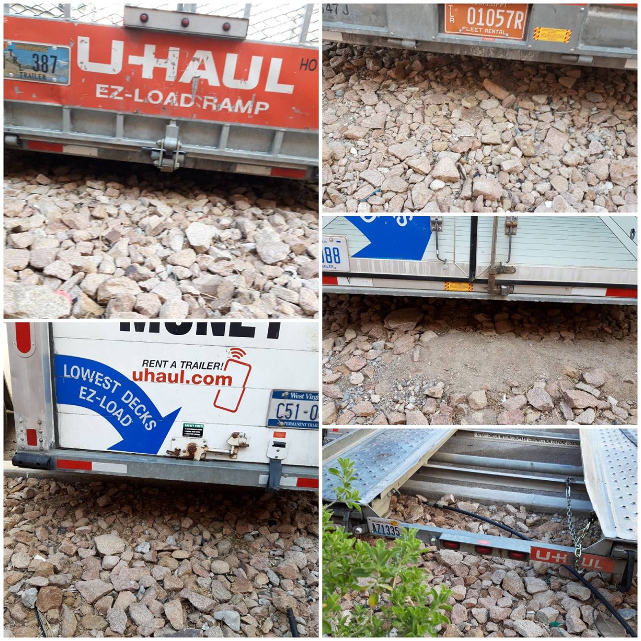

No Northern Tool trailer has a receiver or Harbor Freight trailer or my bike rack.
The most consumer rented trailer in the country U-Haul none of their trailers have a receiver in the back.
Ford Maverick DIY Bed Divider 20250415_085848

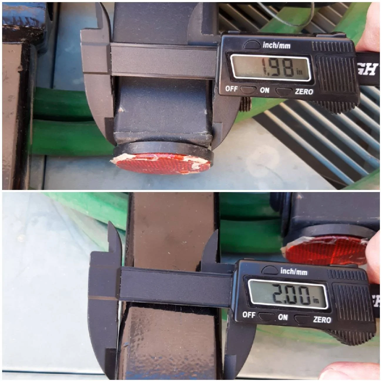

Even if I were to pry out the plug that the reflector is on it's too small to accept the Curt plate Mount.
Ford Maverick DIY Bed Divider 20250415_172356
Ford Maverick DIY Bed Divider 20250415_172108
I'm not saying that trailers aren't out there that have a two inch receiver.
Custom made of course commercial probably.
In my opinion the curt receiver hitch license plate holder is useless.
Having to move your license plate around because you're going to tow something. Especially when the truck has a perfectly good license plate mounting position on it.
