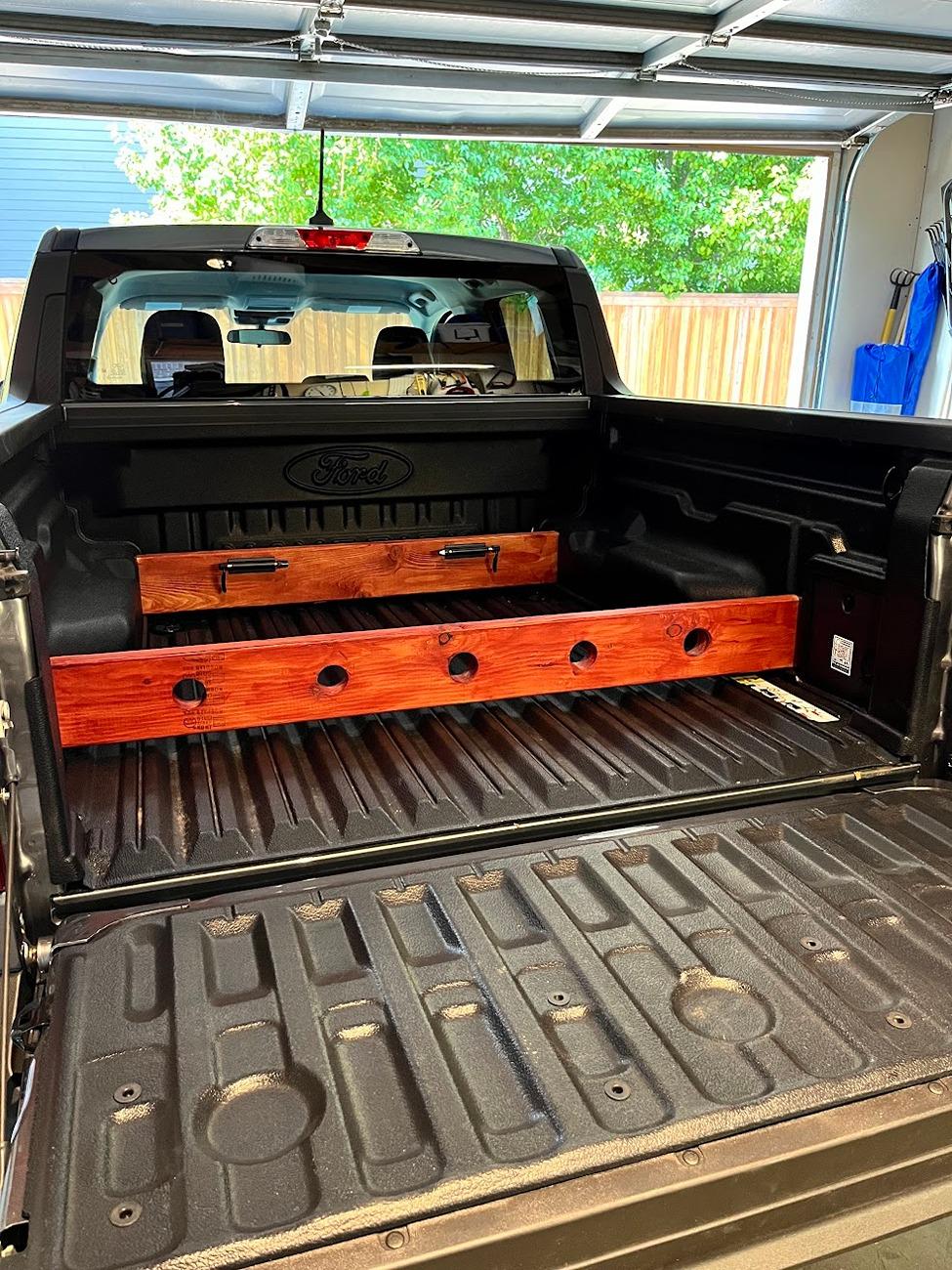

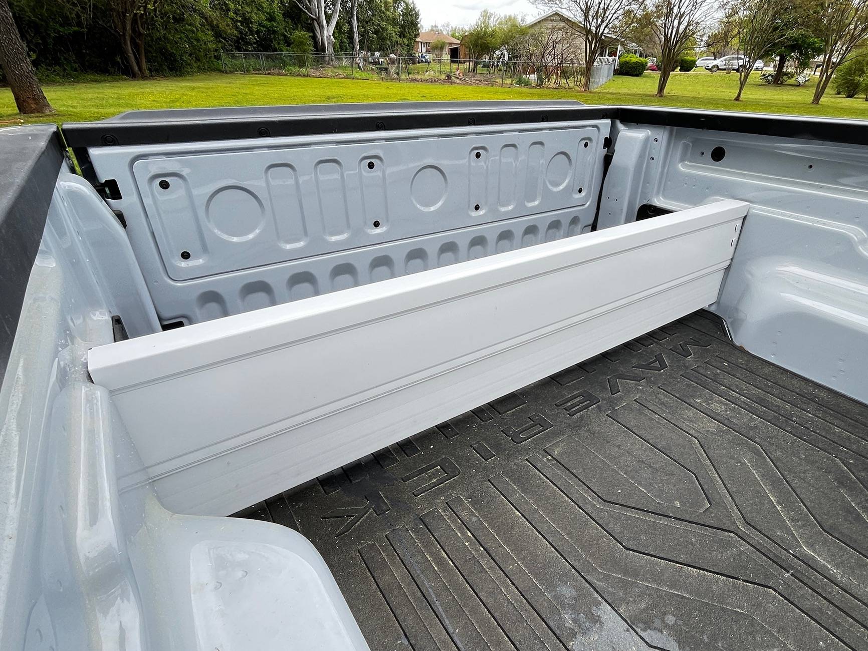

This is my 3rd version. I always need more room. This one is 1-by, so it is light.
Ford Maverick DIY Bed Divider Made From Cedar divider

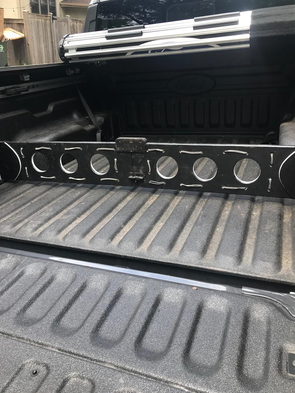

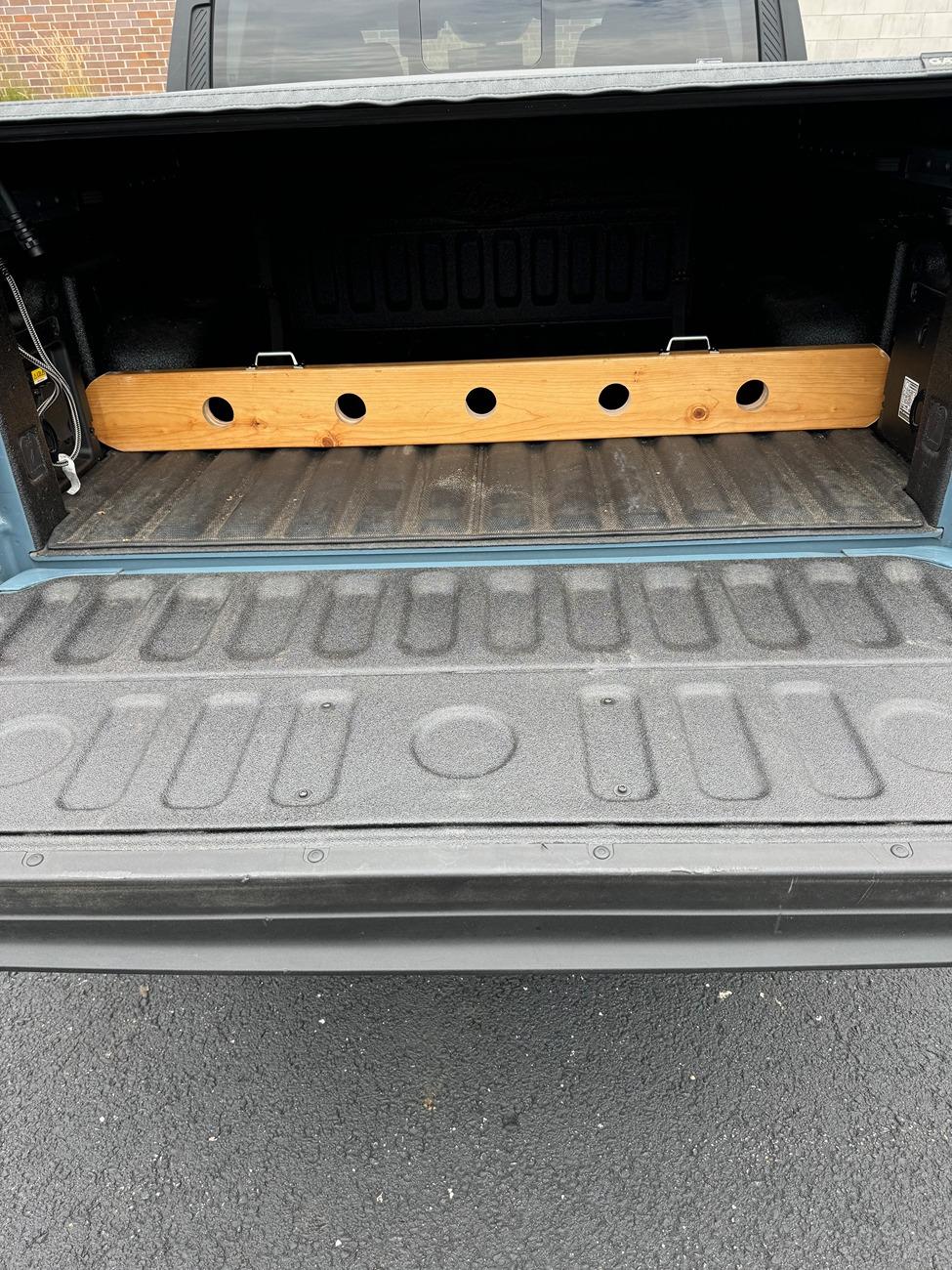

I recently modified my 2x6. I rounded the corners and drilled 2 1/8 holes in it. I also added the handles. The rounded corners really mak it easy to get it in and out (even with the bed cover on) and the holes serve two purposes, one is to lighten the board and the other is to allow you to use bungees to secure things. It is not such a PIA to use now.
Now I need to finish the raw spots with some Poly to call it good.
I like that, although the handles on top might interfere with hauling 4X8 foot sheets of plywood or drywall. Still, looks nice. Nothing like the look of stained wood to dress up anything. Especially if your color is terrain like mine.

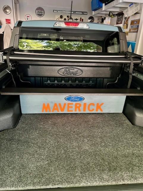

This is what I have been using for over a year now.
2 by 4 across the bottom of the slot. Then another 2 by 4 at the top of the slot, with two little "legs" attached to the back of the top divider and one leg on the front so that it is elevated off the floor of the bed and does not "twist" front to back if pressure/weight is placed on the front or back of the divider. Having it built in two pieces allows me to easily remove it with my toneau cover and rails still installed.

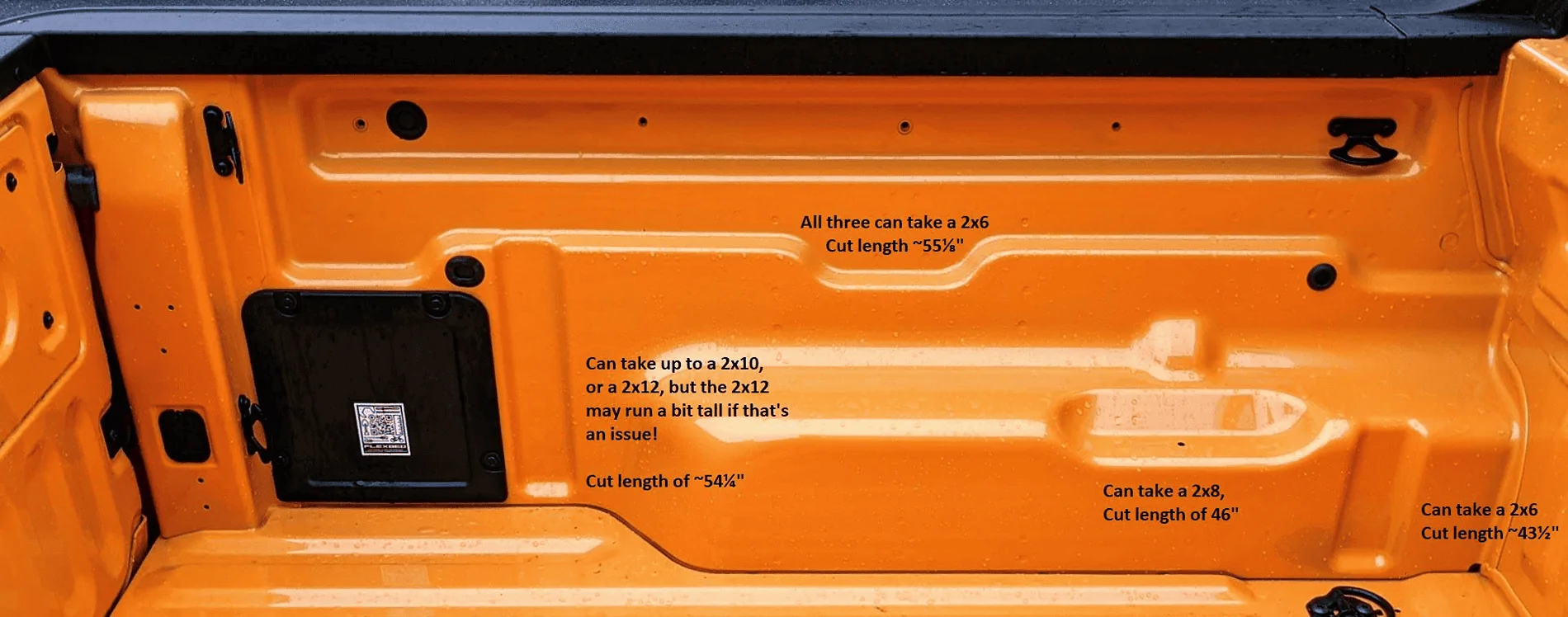

Dimensions for anyone wondering

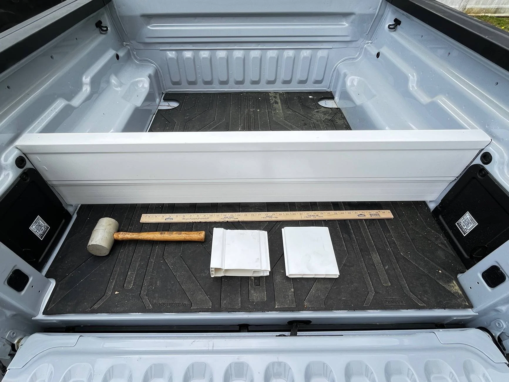

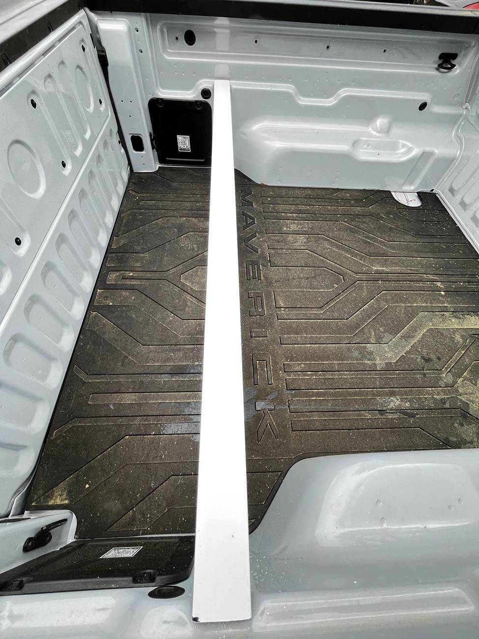

Thanks for the information. I didn’t have the patience to climb into the bed to get accurate measurements for my DIY divider. I will use this for my next project. I had some leftover Vinyl fencing material that does not need painting, is weatherproof, and is very easy to remove.
