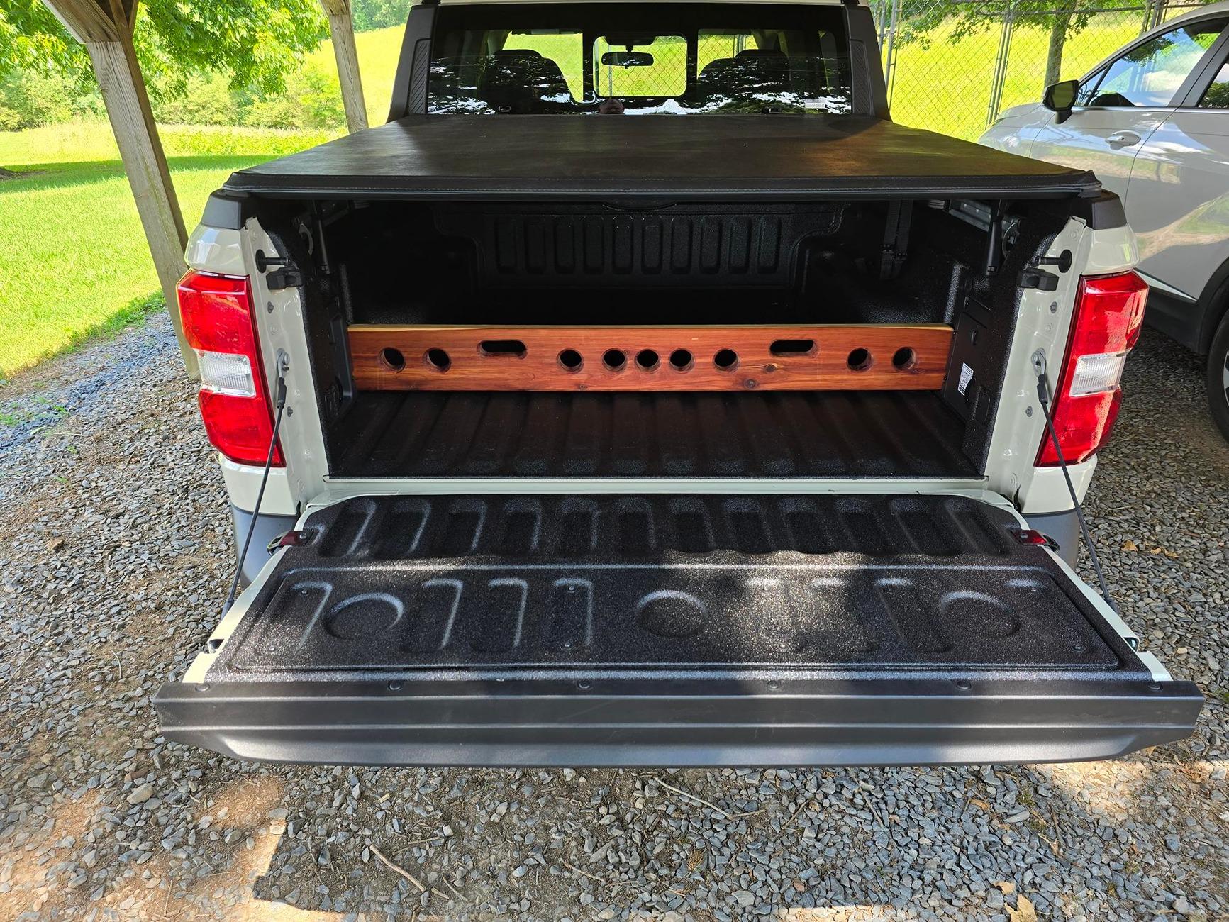

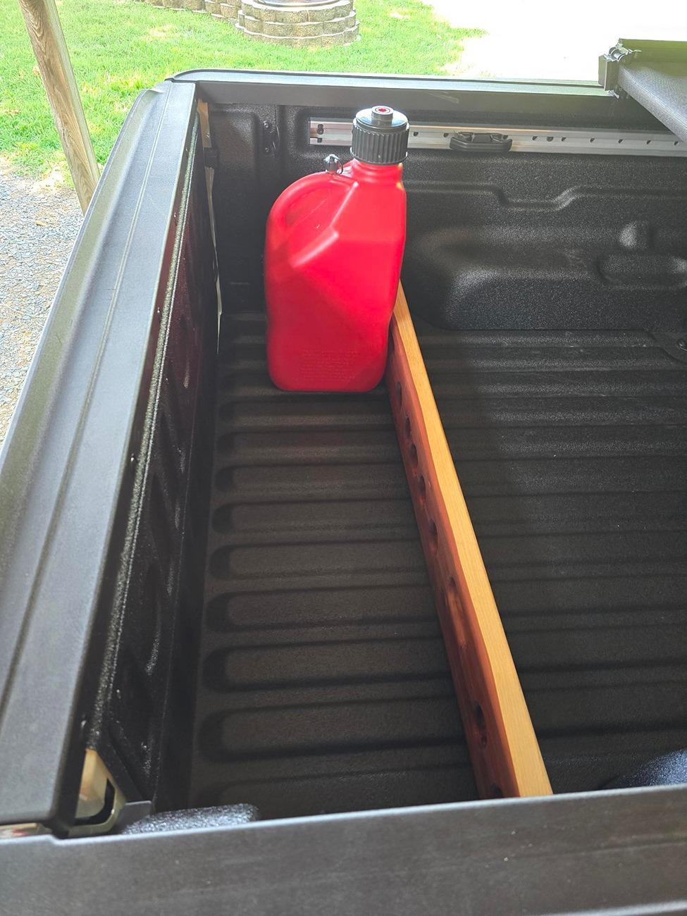

Thought that I would share a pic of my bed divider that I made. It is out of Cedar with holes for tie downs and to reduce the weight.

Ford designed a built in ruler for cutting the bed divider length .......... the bed is 54 1/4 inches, Just stick the board in/over the bed floor and mark it!

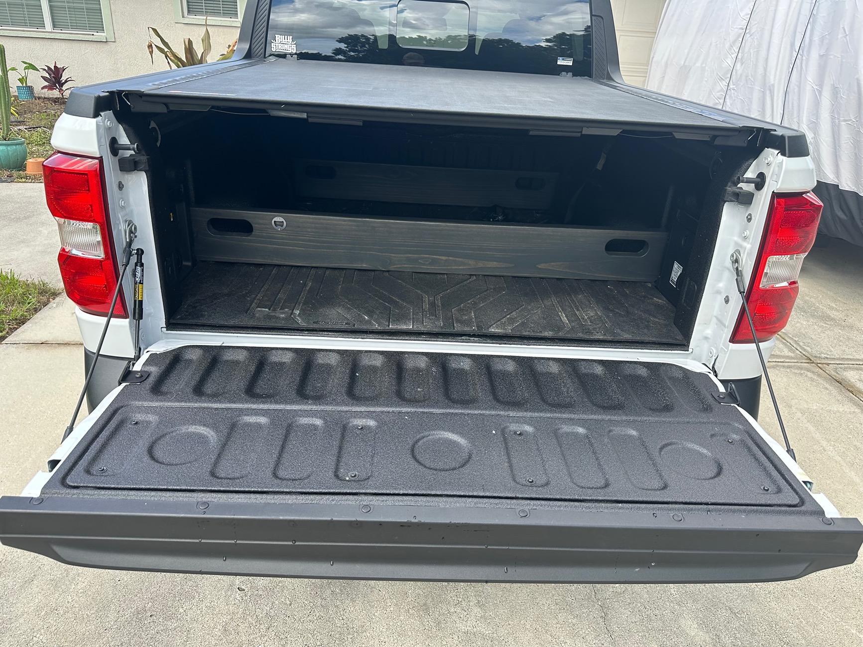

I did something similar without the smaller holes. One up front as well for carrying 4x8 sheets

Yes, plus gives you a place for running a bungee cord through if you need it.

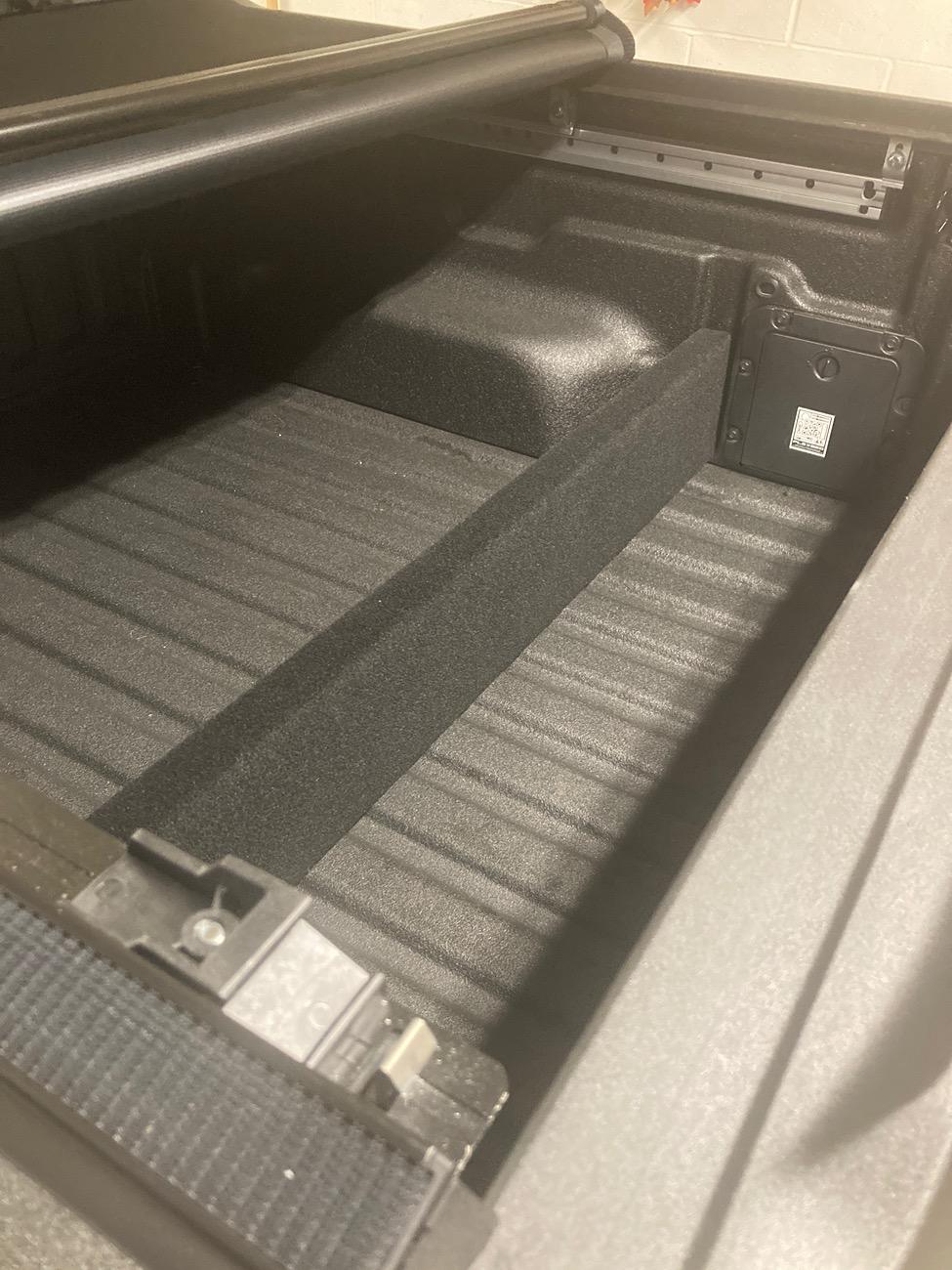

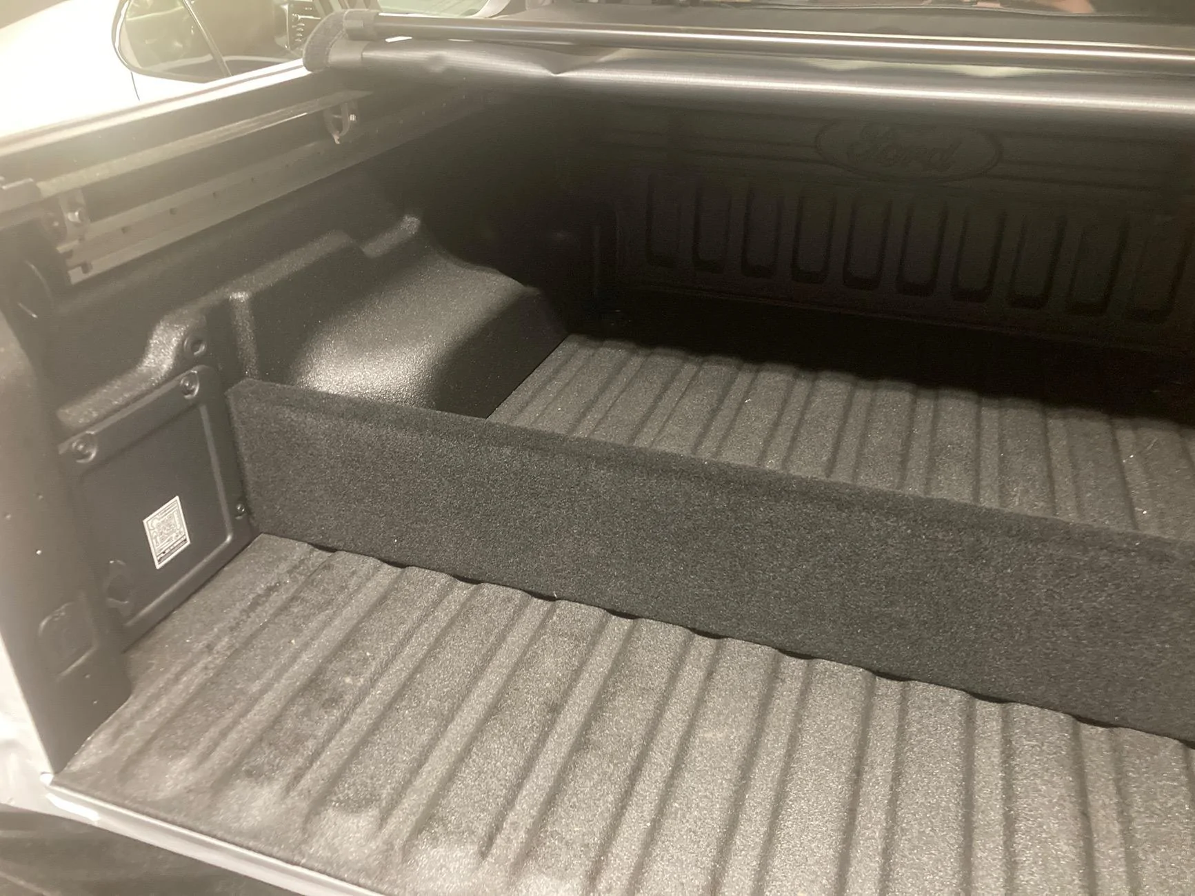

I used a 2”x6” and covered it with automarine carpet. Used 3M spray contact glue to wood and fabric. $33.00 total cost for materials and about 45 minutes of time to cut board to fit the bed contours and cover with fabric.
