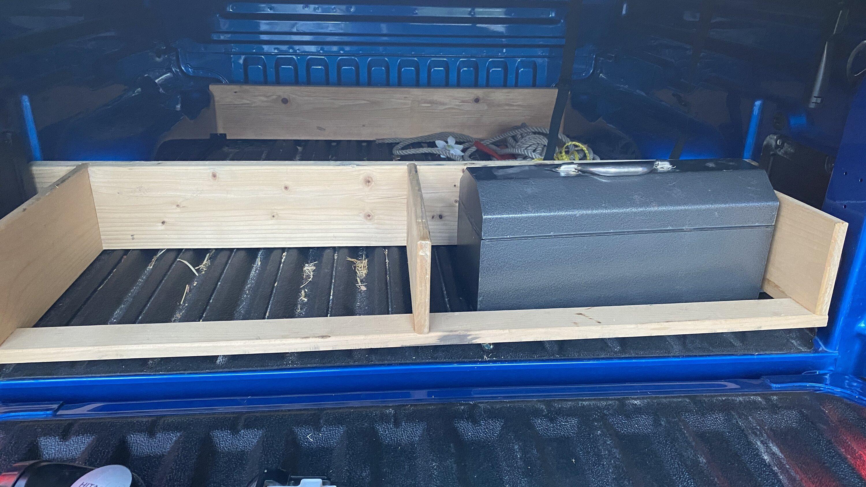

Cool! I did a similar thing but added a center divider. Also put a single cross piece at the front of the bed (near the cab) to have support front to back for carrying 4 x 8 sheets of plywood.
Edit: I have the drop liner for the bottom only. The 2 x 8 was ripped to be 6 1/2" wide to match the wheel wells- for my truck. Same for the "front" cross member.

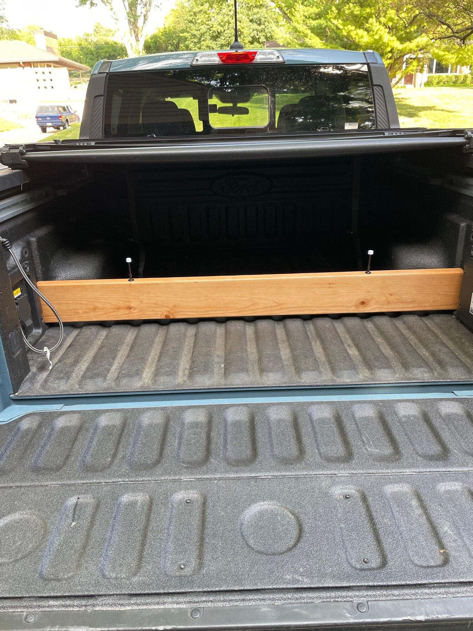

I built one out of a 2x6 and it is a pain in the butt to get in and out. Handles are a good idea and rounding the bottom corners sounds like a good idea too. BTW you can use the "Bottle Opener" Tie downs at the top rear to hang the grocery bags on. I also used some cheap door stops on the top of my 2x6 to hang them from.
