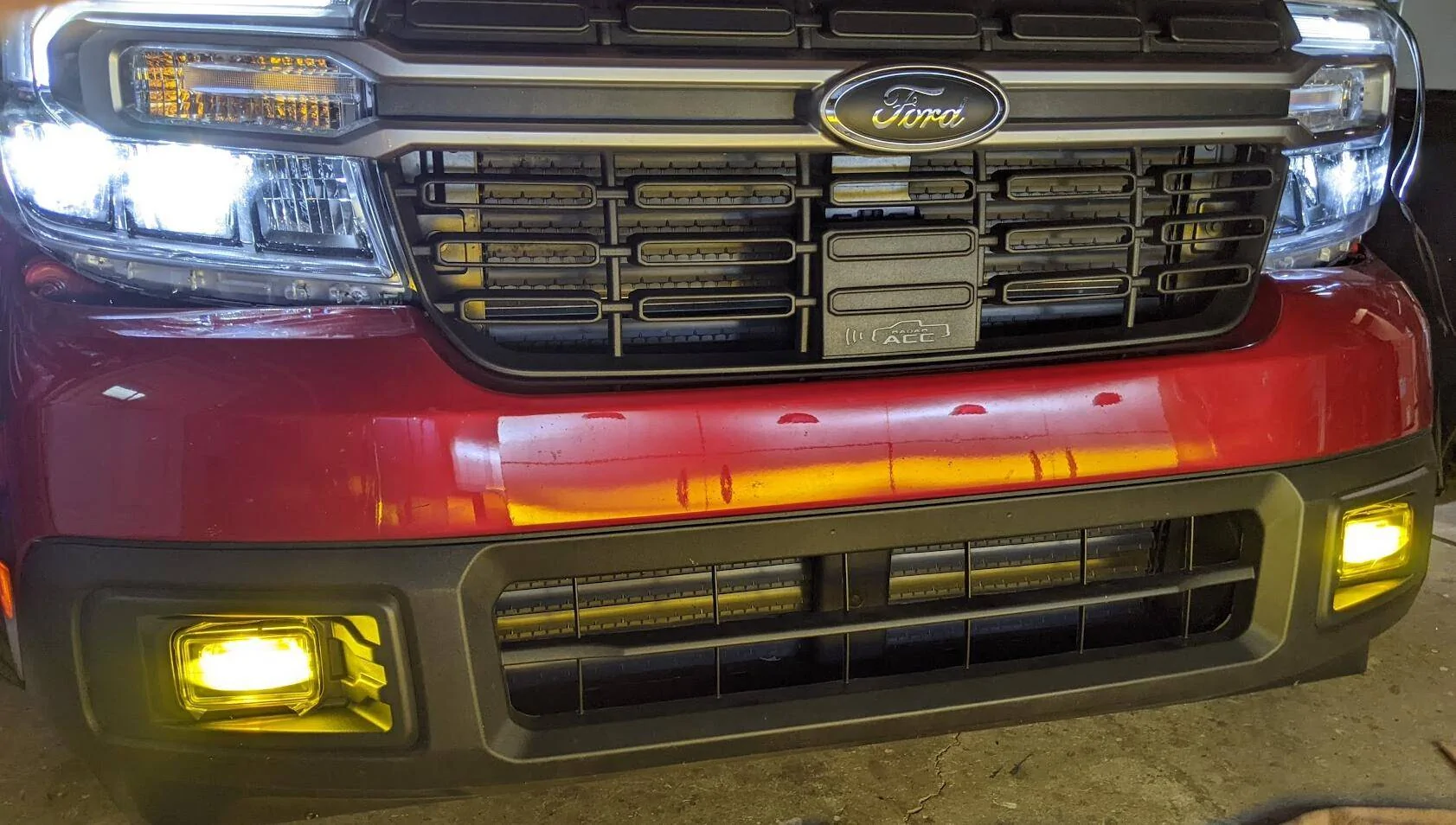

Hi again all! I got my lights installed today and thought I wired everything up according to my understanding from the write-up, but now the fog lights stay on all the time. I drew the diagram attached and this is how I have wired things. The BCM #6 pin is wired to the "S" Switch Input Wire on the DD wiring harness. The "VB" Positive Wire is connected to the batt/post under the hood. The "G" Ground is connected to the factory ground wire under the hood. I did not connect the "DW" deactivation wire or the "BW" Backlight wires to anything, as I didn't want the running backlights when fogs are off. I made and saved all the of the FORscan changes as described as well and the fog light dash indicator does show when the fog light button is pushed on the F-150 hyrbid headlight switch. Do you see anything I may have missed or hooked up wrong?
Additionally, I tried disconnected the "VB" Positive wire while leaving the "G" ground and "S"-->BCM #6 wire connected, and this results in the fog lights not turning on at all under any condition. Any and all help is most appreciate!

Just completed the Diode Dynamics LED Fogs install on 2023 Maverick (non-Hybrid 2.0T). Followed video and printed instructions. Before bumper re-install performed the test and the the LED fogs did not come on. Tested all touch-points:
12V at passenger bumper connector tap (brown/yellow)​
12V at passenger headlight tap (blue/green)​
12V at toggle switch​
Ground connection confirmed on chassis​
Inline fuse good​
Fog DT connectors in tight​
Head scratching.
DD to send replacement cable harness (with included control relay)
UPDATE:
WORKING NOW WITH REPLACEMENT HARNESS KIT 💡💡

Issues still... the FOGS worked as using the harness and switch install.
In parallel did the BCM mods as posted Pin 6 and the FORSCAN IPC and BCM changes... removed switch connections and ran the BCM to the wire harness trigger. Dash OEM Ford FOG button turns on dash indicator and the FOGS come on VERY DIM.
I removed the BCM 6 connection and wired back in the DIODE DYNAMICS switch as the out of the box install and the FOGs now are still VERY DIM.
They get their power from the +12V and ground so using out of the box install using the toggle switch, the lights should be bright like they were.
Thoughts ??

Dim seems like probably bad ground to me.

The +12V is on the battery post per instructions. Used the horn bracket for GROUND as the chassis bolt shown in instructions was buried below.
Oddly is before doing the BCM (green #6 ) wire and programming mod, the FOGS were installed as per the DD instructions and were BRIGHT.....

Are you sure it's not just the backlight that's coming on? Are your fogs amber or white?

The are the WHITE version. Originally wired up per DD instructions and video with switch wires and passenger headlight tap and passenger side bumper connector tap battery post for + 12v wire and horn bracket on driver side fender for ground (easy access) and they were only bright white.
Did the BCM mod of #6 green wire w/ FORSCAN programming of IPC and BCM modules per steps on pages 1 and 2 on this forum post. Used OEM Ford dash switch that has the center push on push off (used on several Ford models with fogs including NEW Mavericks).
Unplugged switch wires and plugged in BCM #6 green wire to the "white" switch wire from relay harness and the fogs were now dim......
Removed BCM #6 wire and reconnected the DD toggle switch wires (the way when the fogs were bright white) and now they are dim... as if wiring harness relay is not feeding full 12+ volts ?

I did the DT connector voltage testing and found 0 volts on the AMBER pins and only 8 volts on the WHITE MAIN FOG pins (explains the VERY dim output)
Will replace the entire harness w/ solid-state relay controller on Tuesday (July 1st) with a tested and known good DD harness.

All issues resolved. Last was poor ground (do not use the horn bracket for ease of access) and the backlight BLADE was bent not making good contact (at all) to the bumper vampire tap.
All is working with BCM programming and OEM Ford fog combo switch
