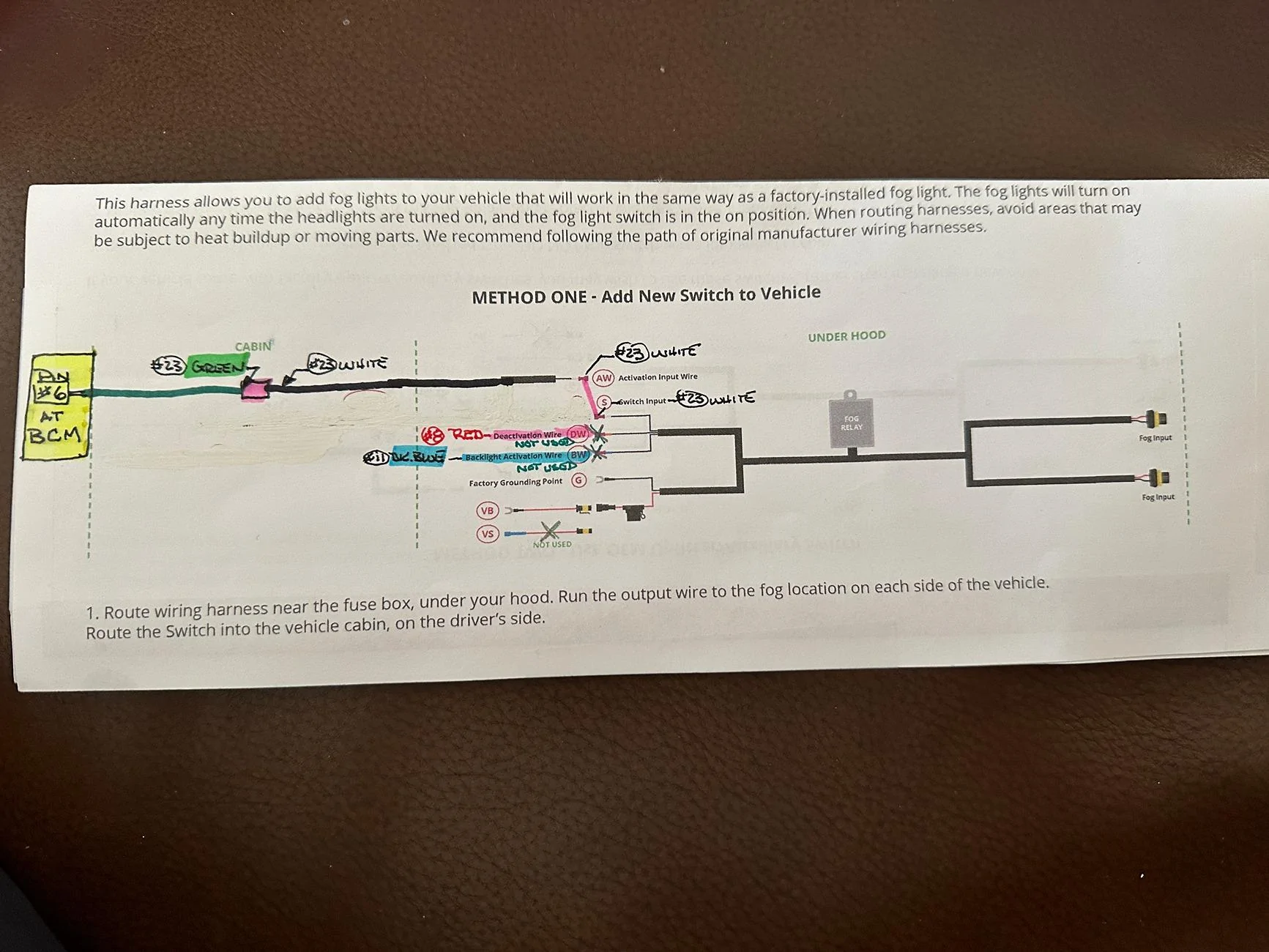

Hi again all! I got my lights installed today and thought I wired everything up according to my understanding from the write-up, but now the fog lights stay on all the time. I drew the diagram attached and this is how I have wired things. The BCM #6 pin is wired to the "S" Switch Input Wire on the DD wiring harness. The "VB" Positive Wire is connected to the batt/post under the hood. The "G" Ground is connected to the factory ground wire under the hood. I did not connect the "DW" deactivation wire or the "BW" Backlight wires to anything, as I didn't want the running backlights when fogs are off. I made and saved all the of the FORscan changes as described as well and the fog light dash indicator does show when the fog light button is pushed on the F-150 hyrbid headlight switch. Do you see anything I may have missed or hooked up wrong?
Additionally, I tried disconnected the "VB" Positive wire while leaving the "G" ground and "S"-->BCM #6 wire connected, and this results in the fog lights not turning on at all under any condition. Any and all help is most appreciate!

There isn't really much you can have wrong if the lights are coming on -- that means ground is good and your power feed is good from the battery. My guess is that you didn't actually connect to pin 6 on the BCM and that you are actually in the cavity across from it. Easy mistake to make. When you look at the wire diagrams, it is looking at the connector from the front - not the back where you insert the contact. I would take another look there. In order to remove the contact, you will have to take the front side red piece all the way off (pry it back and forth), and then you will reach into the cavity with a small pick or screwdriver and gently lift up on the retaining tab while gently pulling on the wire. It should come right out.

You were spot on! I was looking at the pin diagram from the back/wire-in side and it was flipped. Everything works perfectly and as planned now, with the VB Positive + Ground + BCM Pin#6!!! Thank you so much for your help, you saved me another long day in this heat trying to troubleshoot! I had already checked terminal continuity and fuses and was running out ideas. You saved the day, thank you!

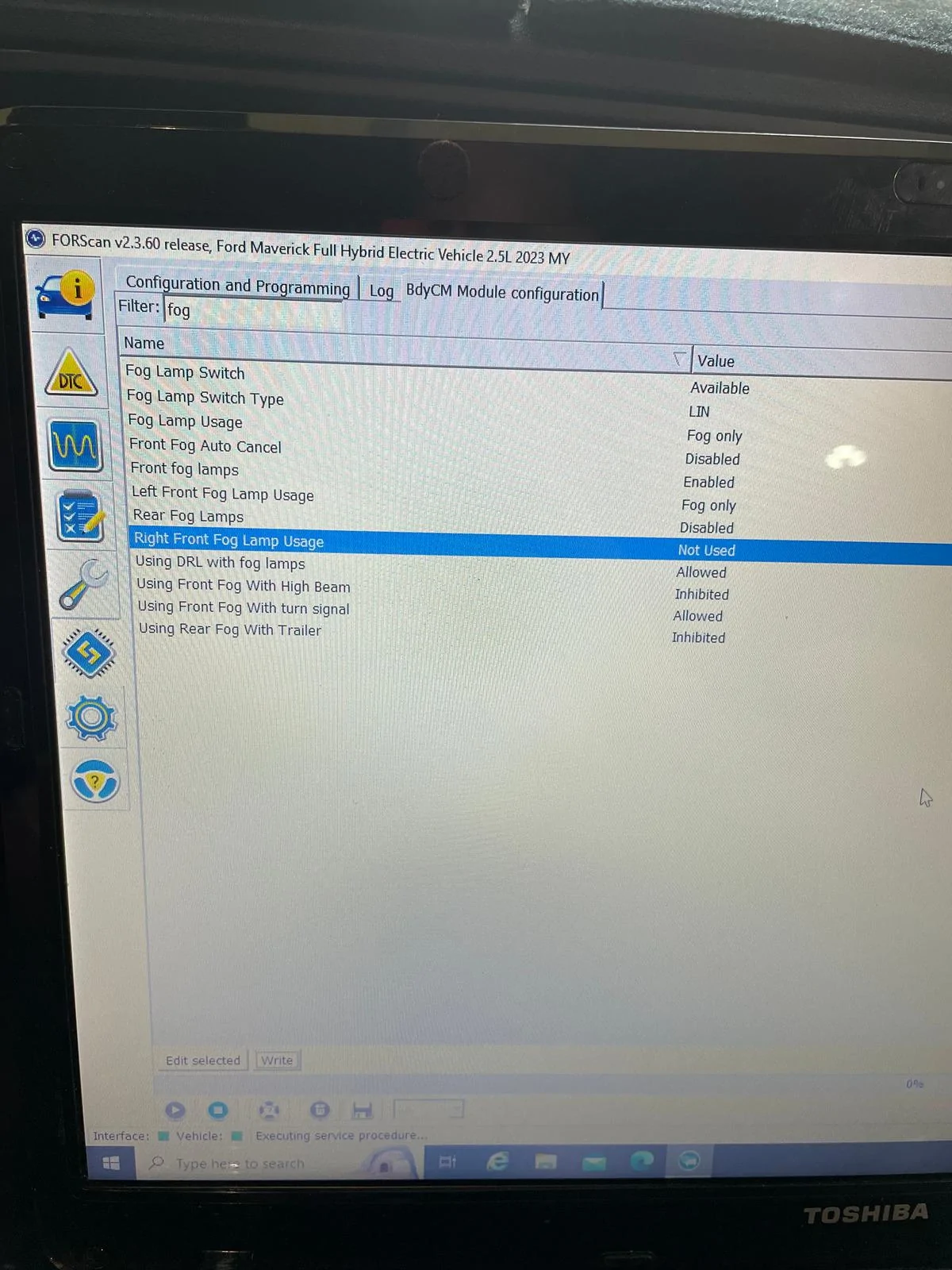

I assisted Larry with the fog light wiring change today for the Diode Dynamic fog light kit. It was initially installed per the instructions received from Diode Dynamic. The toggle switch was wired and placed under the dash. The F-150 headlight switch, (part number in the first post), was installed, but did not allow us to enable the fog light indicator on the dash or be able to use the push button on the head light switch to turn on the fog lights because the power was not being provided by BCM. He was able to find the correct pins and location of BCM connector through researching other posts that are currently active. He ordered two wires with the correct connector pin, (part number in first post), to add to the BCM connector to power the fog lights. Today he wanted to find the way to connect the BCM to the existing Diode Dynamic wiring harness. The wiring changes were minimal. The toggle switch was removed along with the two existing wires connected to it that ran to the switch input line and the passenger side headlight wire harness. The remaining Diode Dynamics wiring harness was left in place. This was convenient because the front grill of the truck did not need to be removed to complete this wiring change. The two pins, pin 6 and 7, at the BCM are power wires for the fog lights. One is for the left fog light and the other is for the right fog light. We only had to add one wire at the BCM connector because we did not remove the Diode Dynamics wiring harness. This allowed the one power wire to apply power to both fog lights through the Diode Dynamics wiring harness. The new wire from the BCM was connected to the switch input wire that had been connected to one side of the toggle switch that was removed. That completed the wiring changes for his fog light install today.
We moved on to the Forscan changes that allow for the fog light dash indicator to work. Two modules are involed in the required changes for his 2023 Ford Maverick XLT. I will list them separately.
IPC Module
Front Fog Lamps (default is disabled) - Change to enabled
BCM Module
Fog Lamp Usage - Fog Only
Front fog lamps - (default is disabled) - Enabled
Fog Lamp Switch (default is not available) - Available
Fog Lamp Switch Type (default is hardwire) - LIN
*Left Front Fog Lamp Usage (default is not used) - Fog only (providing power from the BCM)
*Right Front Fog Lamp Usage - Not Used (We only needed one power input since the Diode Dynamic wiring harness was ran to both fog lamps.)
*We initially used both the left and right option becasue we could not remember which pin we chose to use to send power to the fog lights from the BCM. After we tested that everything worked, we disabled the pin that we did not install a wire into during the wiring change.
The fog light indicator is now working and he can use the push button on the F-150 headlight switch to turn them on or off. The fog lights automatically turn off when the high beams are turned on. The amber back lighting is working correctly. The Diode Dynamic fog lights, custom wiring and F-150 headlight switch give his truck a factory feel.

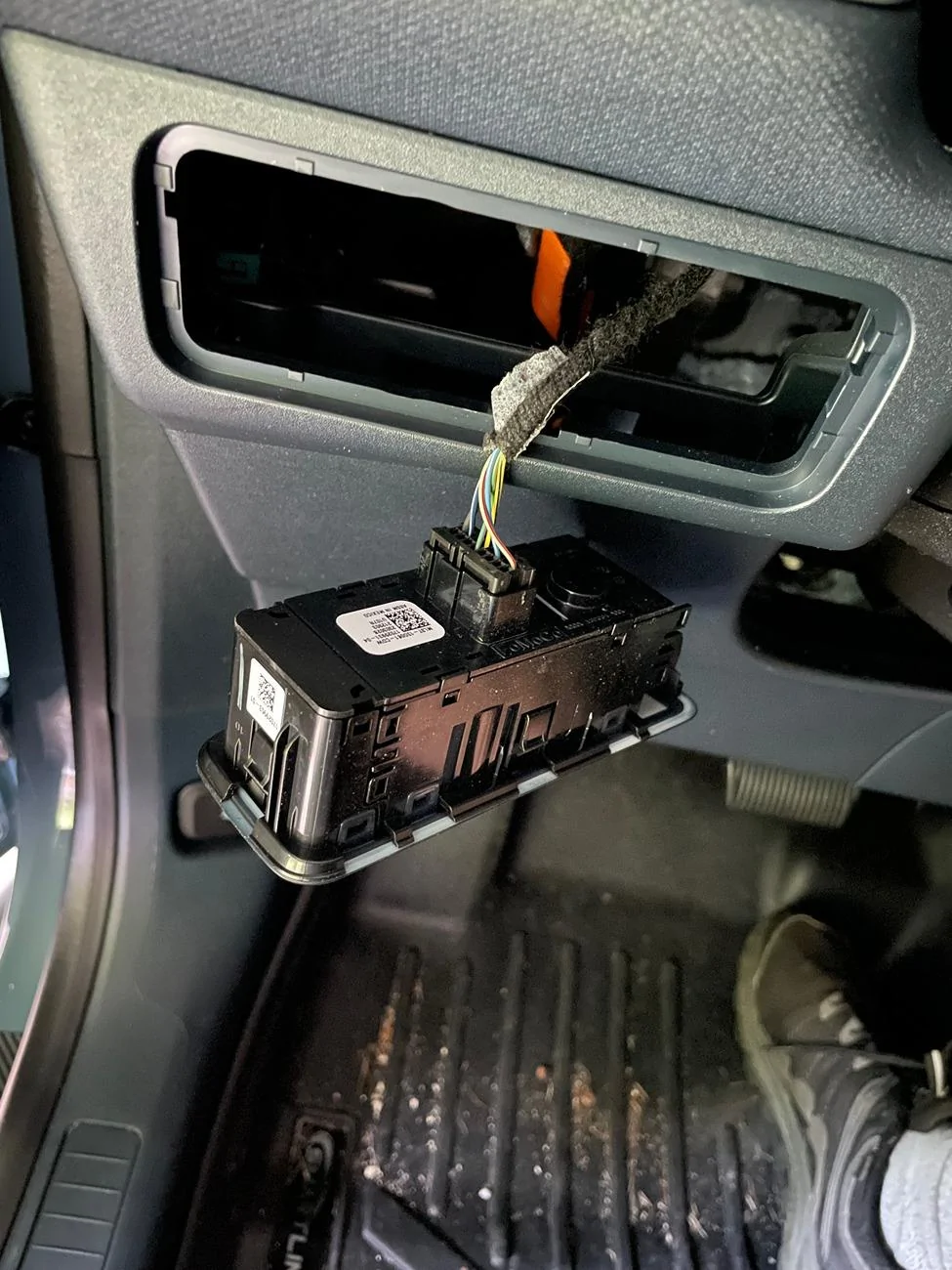

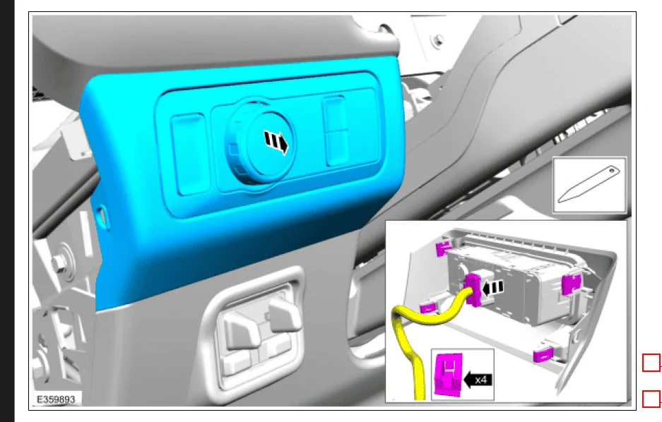

How did you remove the headlight switch unit? Trim removal tool? Start on the left or right? Etc...
there are several clips you have to pop tabs out of. When I did mine, I started at the top and worked my way down. For the lamp controls, there is a tab on eah side to push inward
I used a trim piece remover. There are two clips, one on the left and one on the right. I started on the left and gently worked the tool under the lip of the headlight switch and it released the clip and allowed me to remove the switch from the dash.
Trim removal tools, see Amazon for cheap options. I got the cheapest possible, tabs are located top and bottom center. Gently stick the tools in and pry down and out. Could honestly do it with a butter knife, but plastic tools prevent marring.

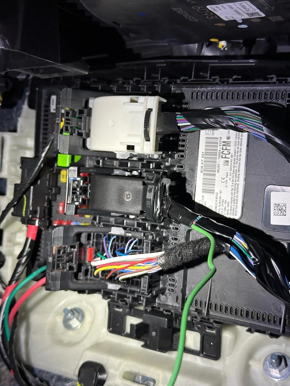

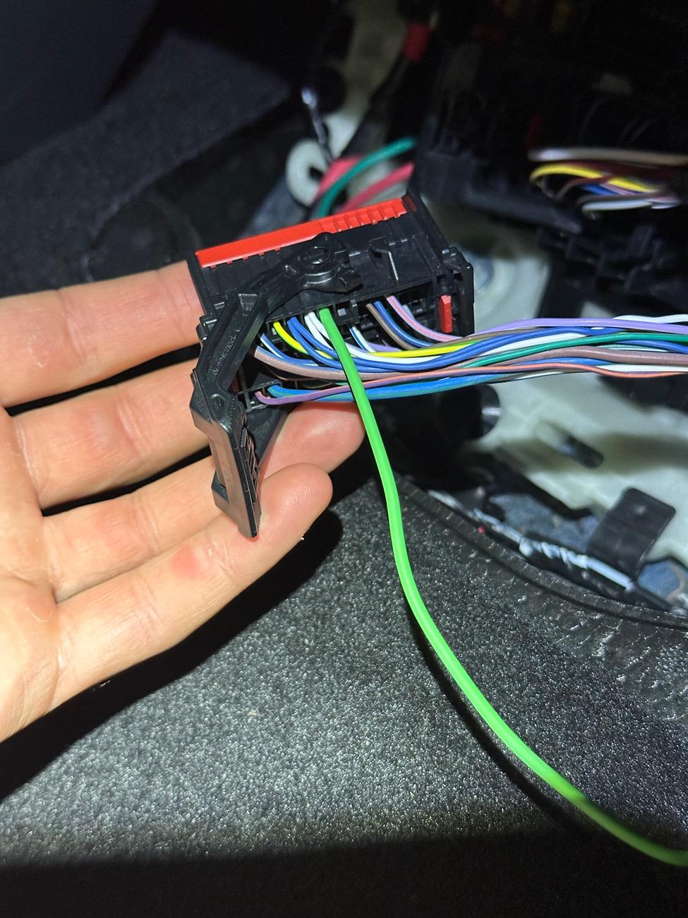

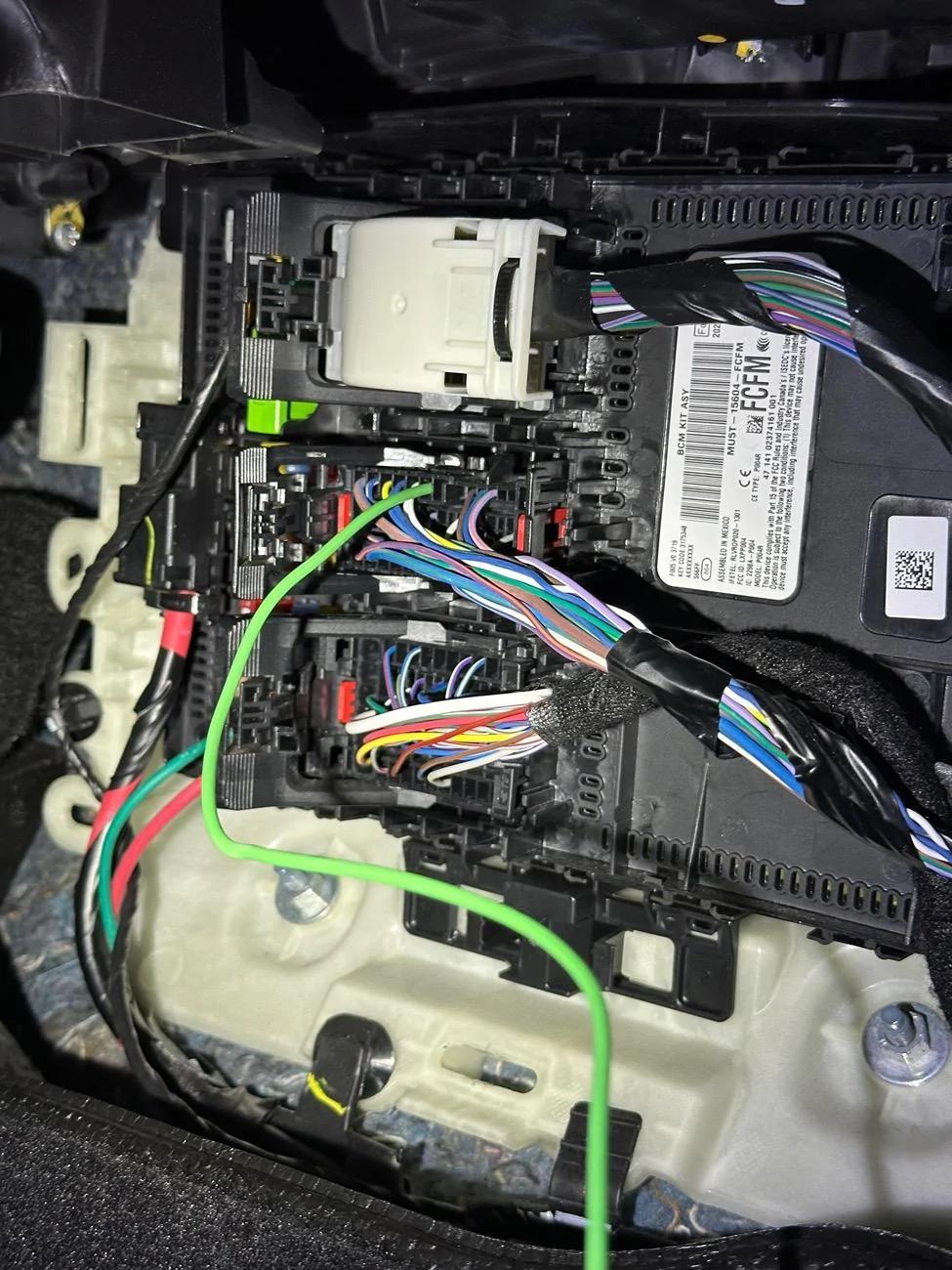

Just ran into this while probing what I thought was pin 6 and flipping the fog switch on and off. Thanks for posting this here! Just finished wiring my switch and pinned the bcm. I’ll attach some pics:
