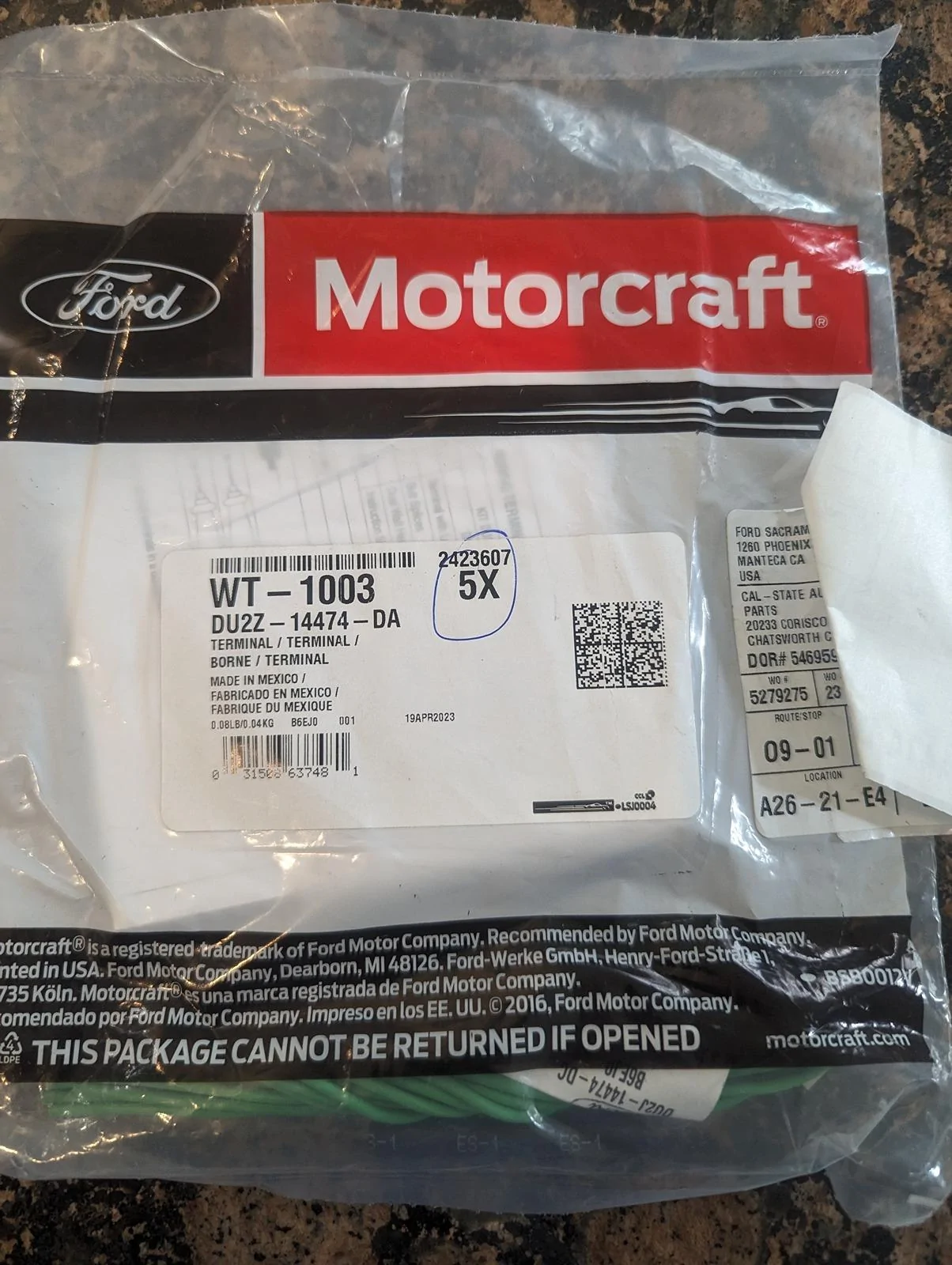

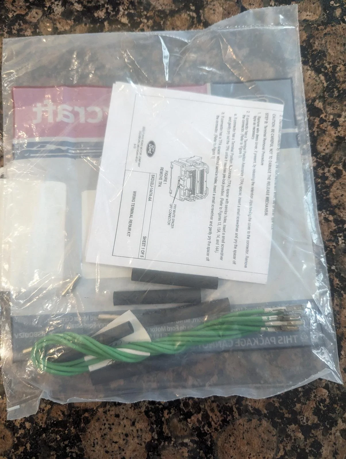

Going to be installing my Diode Dynamics fogs this weekend. Got my F150 switch and ordered the Ford terminals for use in the BCM pin 6 connector. I would like to thank everyone for thier contributions to making this work.
If anyone needs a Ford Termial connector. I am willing to pay it forward by sending you one. Shoot me a DM with your address and I will mail it out.
Ford Maverick Diode Dynamics fog lights Fog Connector

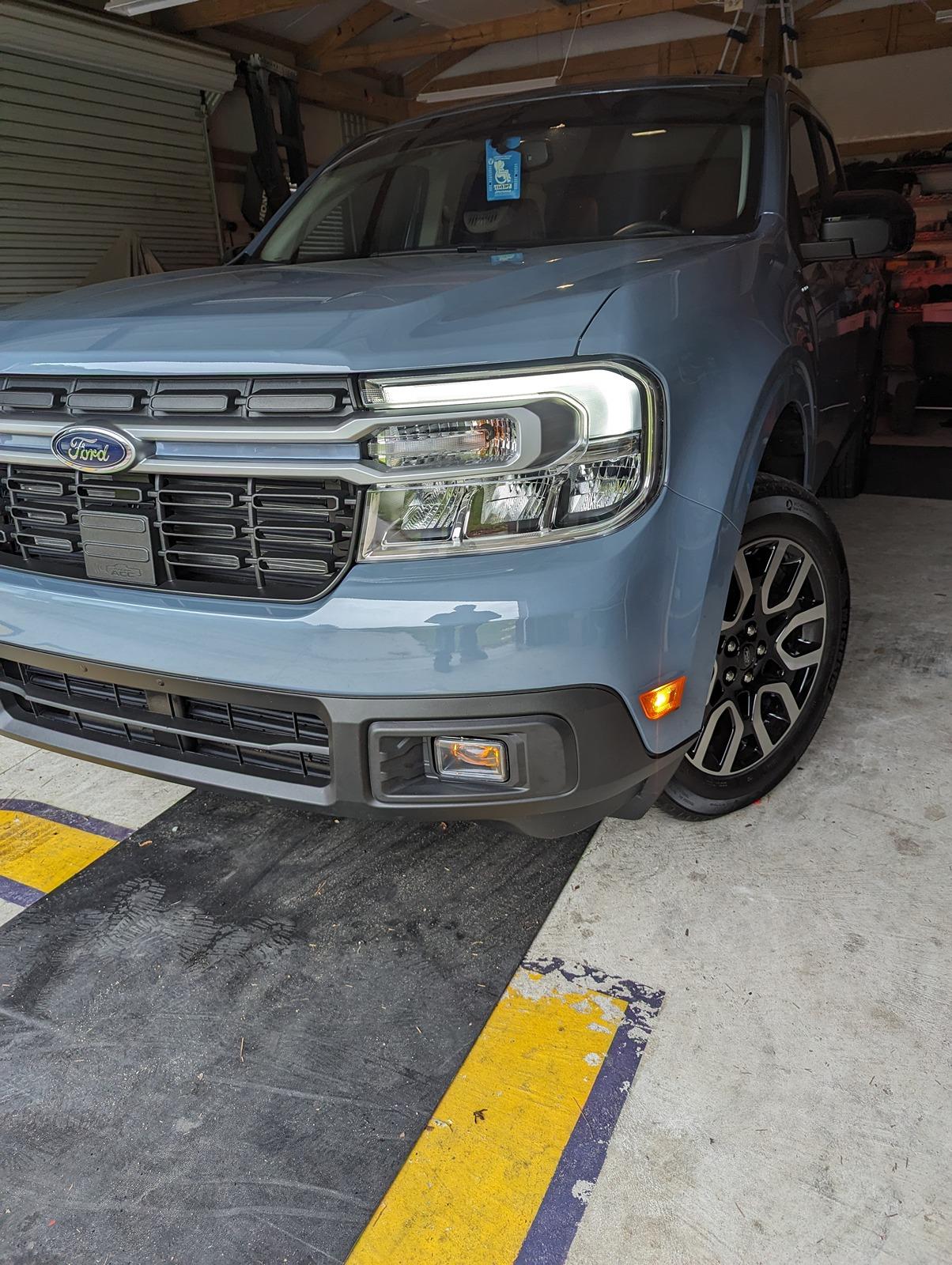

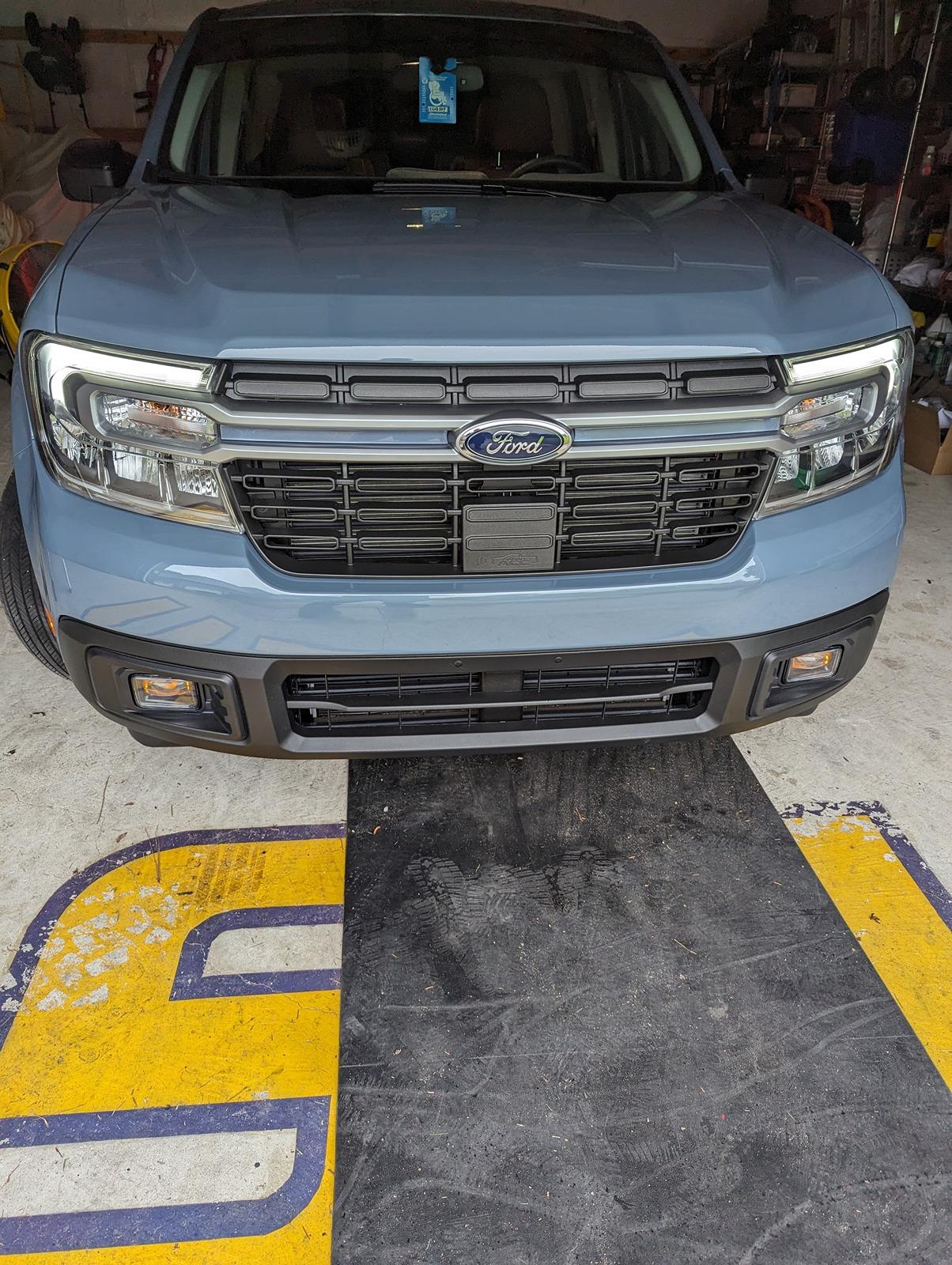

Finally Got time to do the Diode Dynamics Fog light install today. Took about 3.5 hrs. I used the F150 headlight switch and pin 6 on the bcm. Programed with FORscan for left fog.

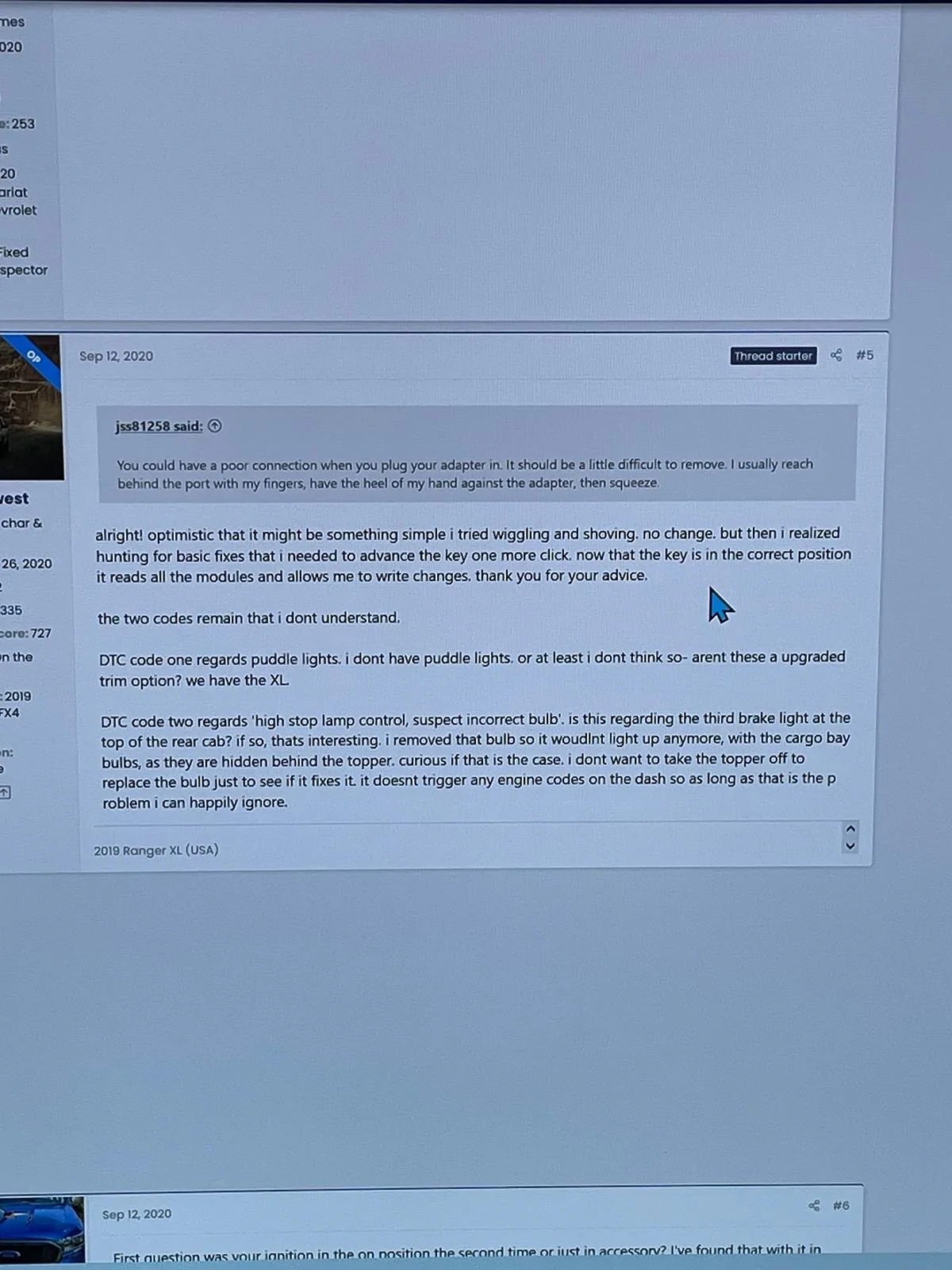

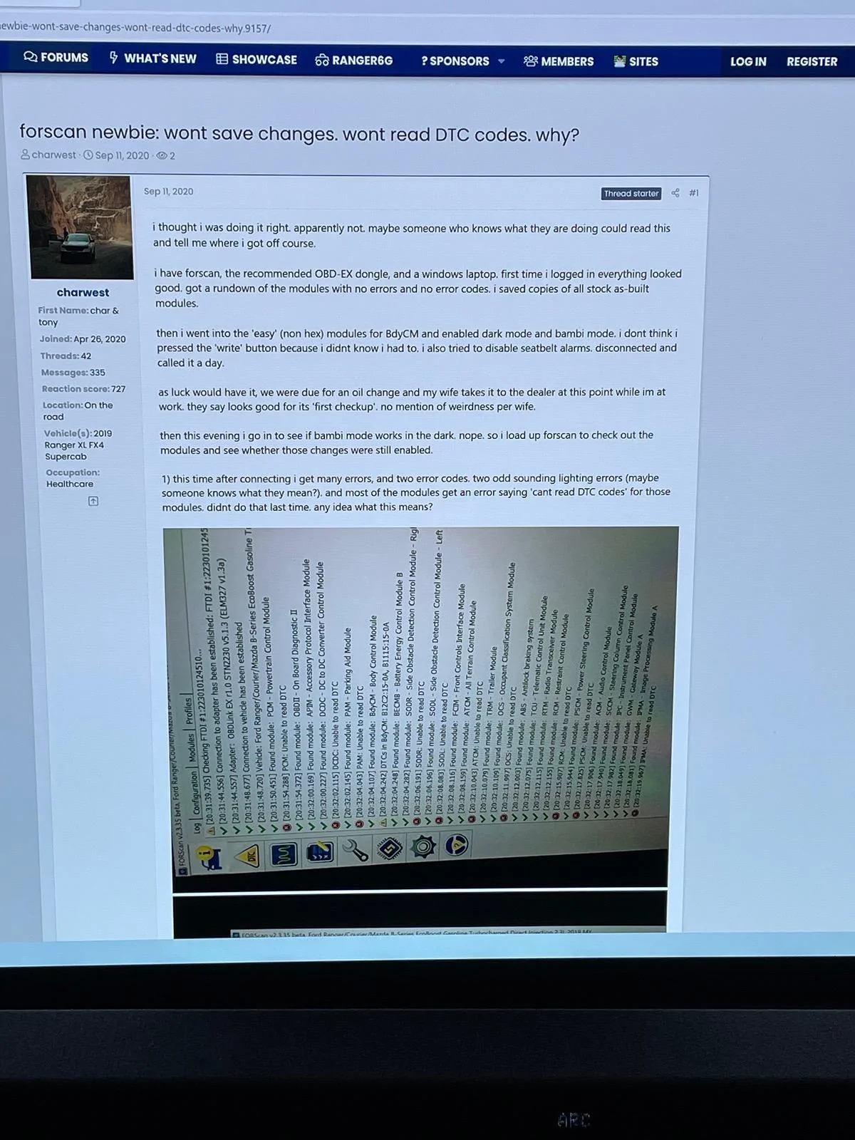

Looks great ,did mine the same way back a few months. Today I had software updates and went back on forscan to reprogram my fogs and having problems getting it set up keeps showing on forscan an error reading DTC my have to contact forscan and hope they can help .

I find it amazing that sometimes it can be the simplest resolution for an unusual problem. We were able to change the IPC settings without a problem. When we changed the BCM module and attempted to write the changes, Forscan disconnected from the truck. I researched this tonight and found the potential resolution. I believe we had the key in the accessory position instead of the on position. When the key is in the accessory position, it is not sending power to every module. It will be tested tomorrow.
We worked on reprogramming the truck yesterday. Writing the required BCM changes worked correctly when the key is in the on position. It is interesting to note that we were able to write to the IPC module with the truck key in the accessory position. I am still inexperienced at using this software and am learning something every time I use it. We are happy that the fog lamps are working again after the recall's were completed.
