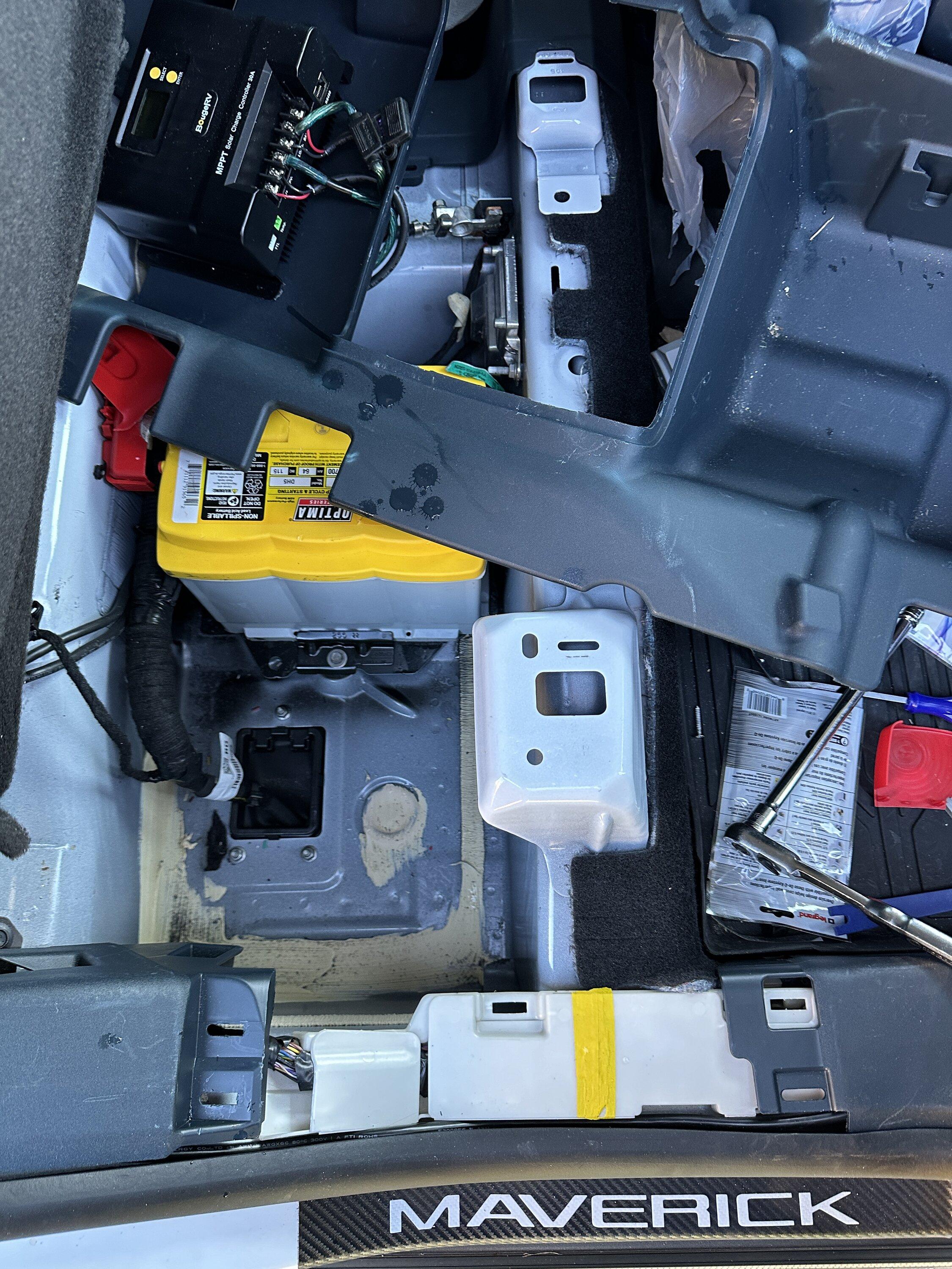

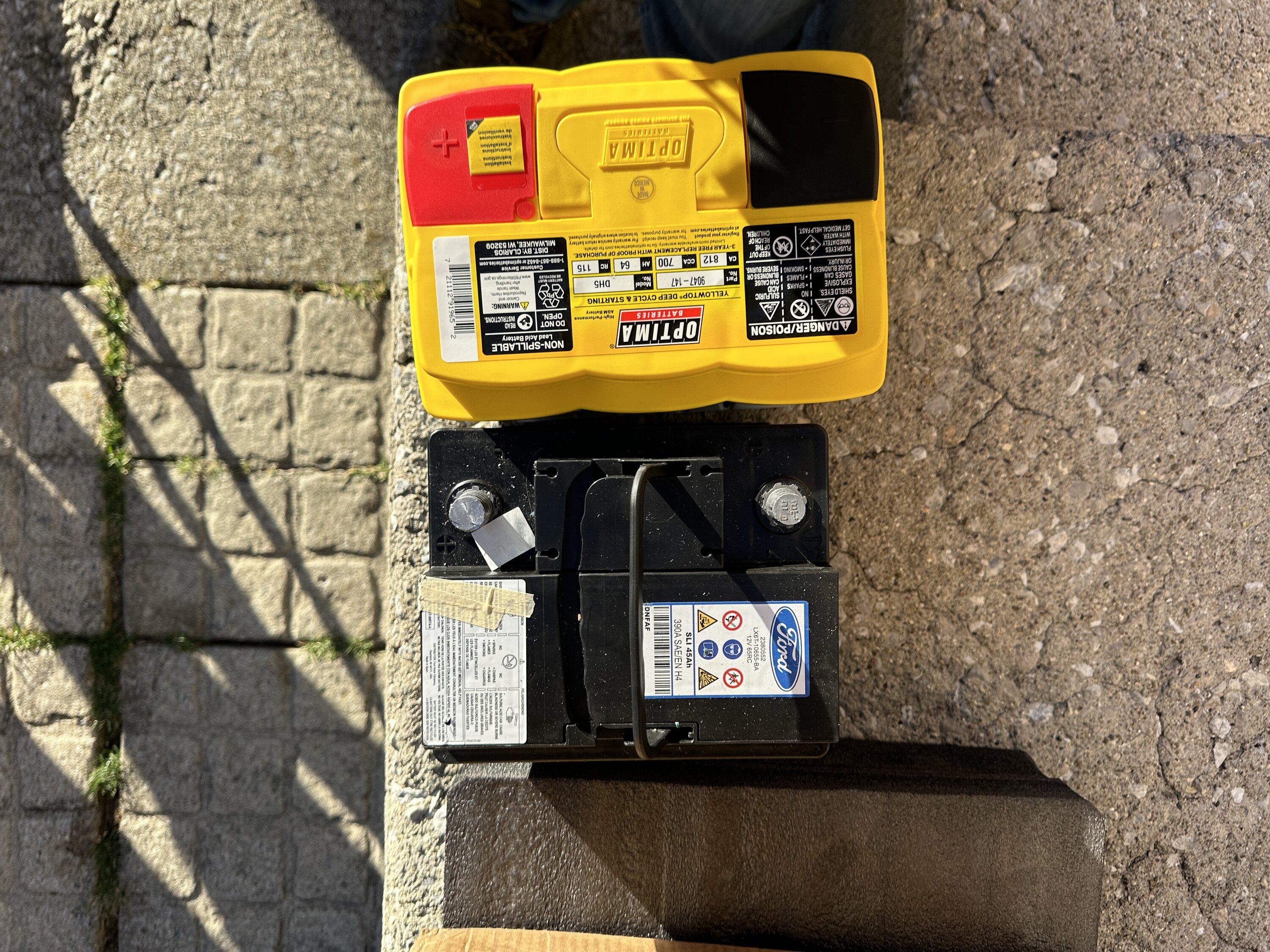

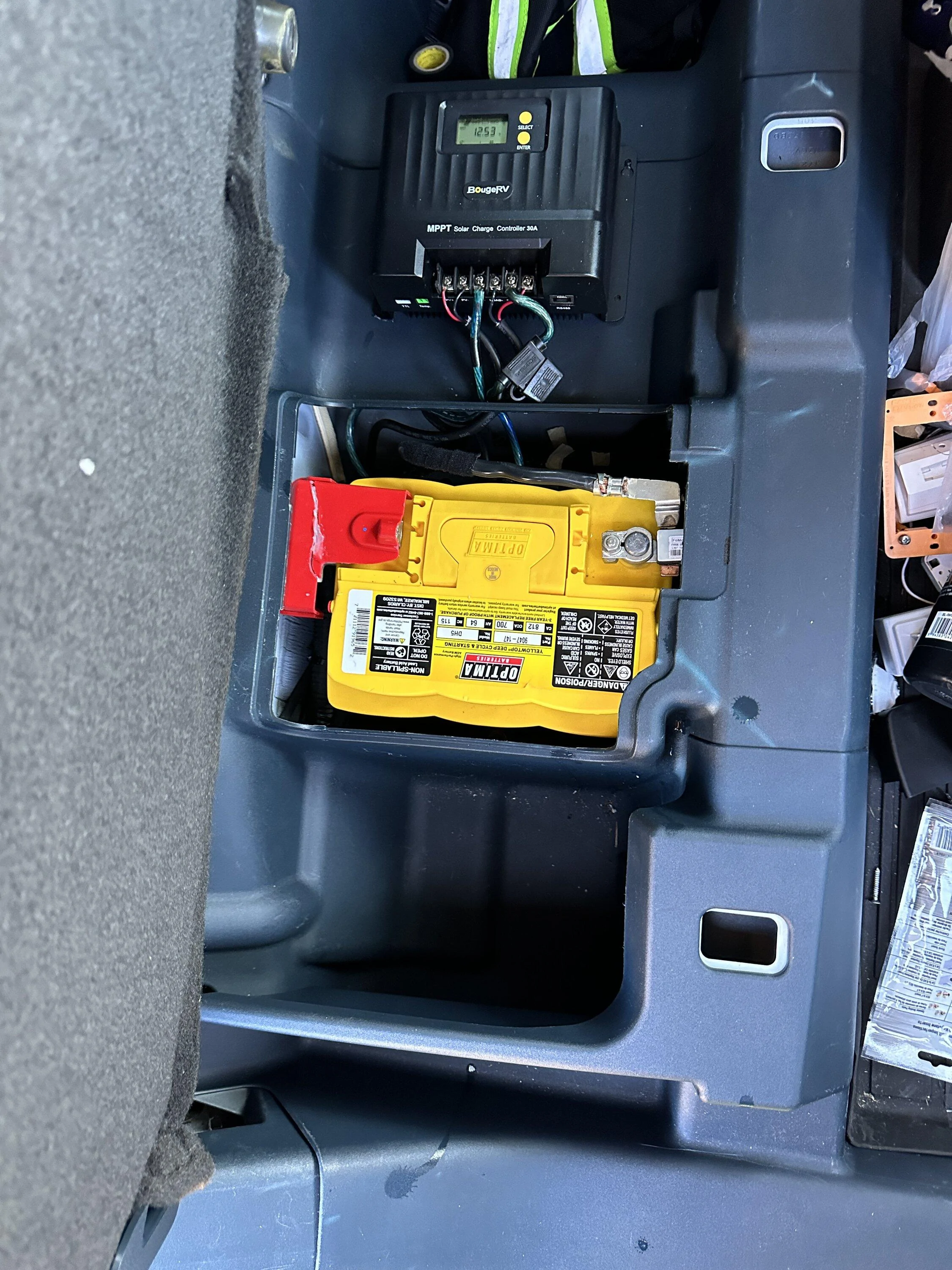

After dealing with Deep Sleep for 1 month, I pulled the trigger on an AGM battery. A bit pricey, but we'll see how it goes after the computer relearns the battery :)
Ford Maverick Deep Sleep Poll Hybrid Owners 20231228_143454
Ford Maverick Deep Sleep Poll Hybrid Owners 20231228_143625
Ford Maverick Deep Sleep Poll Hybrid Owners 20231228_145653
Does the plastic cover still fit on top of the battery after you installed the AGM battery? I noticed that you had to increase to an H4 size battery since they don’t make a T4 battery in AGM.
