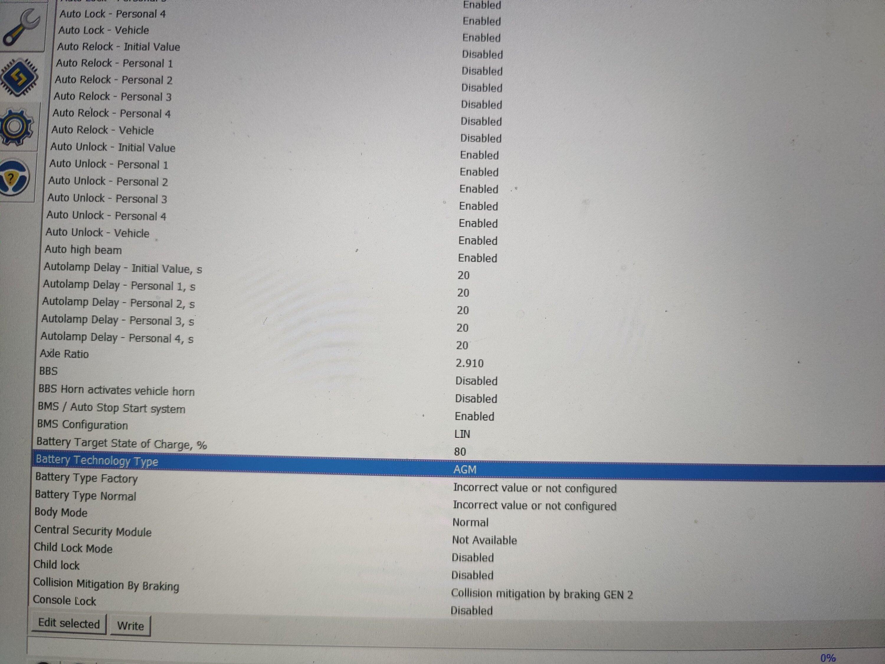

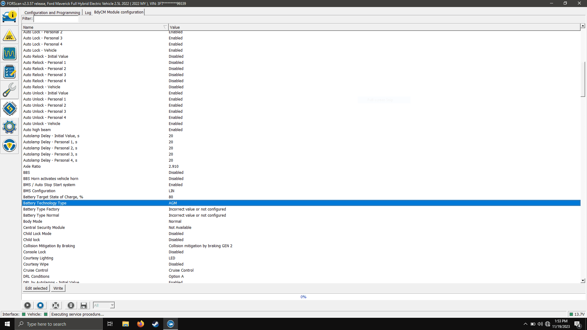

I found something very interesting in FORScan with how my truck is configured. I've dealt with "Deep Sleep" and no start issues frequently in the year that I've owned the truck.
My truck's unmodified Bdycm module information is attached. FORScan reports the Bdycm thinks the factory installed battery in my hybrid is AGM, and reports an incorrectly configured battery type. The battery SOC is also being limited to 80%. The stock battery in the hybrid is a BXT99RT4A, which is FLA.
Is there anyone here with a Maverick hybrid, FORScan, and not having deep sleep issues? Would they be able to check their battery settings in FORscan?

Just checked, 2022 Hybrid, and it shows AGM. I dont have an AGM battery.
Not sure if anyone with a Hybrid has changed this?
If I start getting deep sleep messages again I will definitely change it.

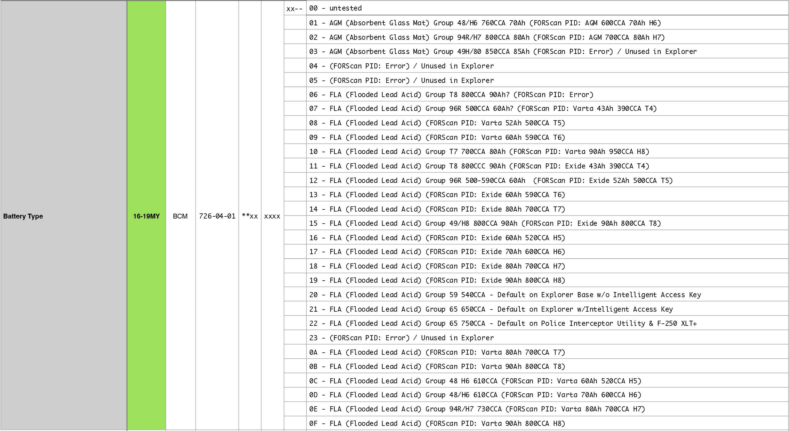

Will do! I've switched to a target SOC of 90% and a battery chemistry of flooded. My battery is already damaged and not holding a charge very well. We'll see if it goes into deep sleep sooner than it has the past few weeks.
One more thing, I looked into the incorrect/not configured battery error. The code in the Bdycm for my Maverick is 726-02-01 0707 0909 0C5C, with the 0707 being the setting for "Battery Type Factory" and "Battery Type Normal". This is the list of battery types taken from an Explorer forum.
Ford Maverick Deep Sleep Poll Hybrid Owners 1700447459815
07 doesn't appear in the drop down list in FORScan, but from this it corresponds to a 43AH T4 size battery, matches the specs of the BXT99RT4A. Strange that while the code pertains to a real battery type, it reports it as incorrect.
