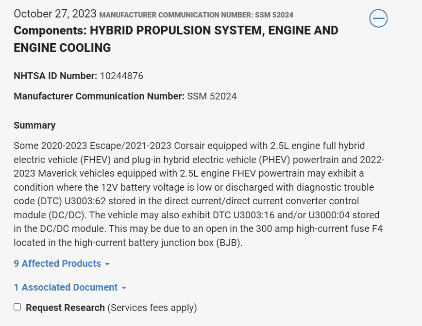

There has been some mention posted on here about 12 volt( low voltage system) battery drain and " deep sleep" messages from Ford Pass in Mavericks, today Ford released on the Professional Technician System accessible by Ford technicians this special service message, this may be something to have your dealer check if you are experiencing the problem of no start or dead/low battery. It does not specify that the mega fuse is being " blown" or popped, from my experience as a technician with some of the other models I have seen this mega fuse actually develop a crack ( typically caused by road shock/vibration)which can intermittently allow the loss of electrical charge to the battery, I've had them where they test good with an ohm/continuity meter laying on a bench but then with a little pressure applied to each end will test open. Ford does listen and research complaints/concerns with their vehicles and typically will give us( technicians) a heads up once they find a repetitive cause. Here is the service message, hope it helps some of you!
May 4 2023 New SSM 51598 2020-2023 Escape/Corsair, 2022-2023 Maverick – FHEV/PHEV - 12V Battery Voltage Low Or Discharged With DTC U3003:62 Stored In The DC/DC
Some 2020-2023 Escape/Corsair equipped with 2.5L engine full hybrid electric vehicle (FHEV) and plug-in hybrid electric vehicle (PHEV) powertrain and 2022-2023 Maverick vehicles equipped with 2.5L engine FHEV powertrain may exhibit a condition where the 12V battery voltage is low or discharged with diagnostic trouble code (DTC) U3003:62 stored in the direct current/direct current converter control module (DC/DC). The vehicle may also exhibit DTC U3003:16 and/or U3000:04 stored in the DC/DC module. This may be due to an open in the 300 amp mega fuse located in the high current battery junction box (BJB). To correct this condition, refer to Workshop Manual (WSM), Section 414-05>Pinpoint Test H1 to verify the 300amp mega fuse condition, replace the fuse upon confirmation it is open. Test and recharge the 12v battery.
This was posted by a Ford Technician back on May 4th. Ford technicians at the dealerships should be aware of a possible cause of the battery drain. If they don't know, I would recommend that the Mav owner get a copy of this notice in their hands.
I think I know what post you are referencing. Unfortunately, that fix might work for some, but not most. There have been numerous posts with dealers "fixing" it only for issue to come back shortly after.
