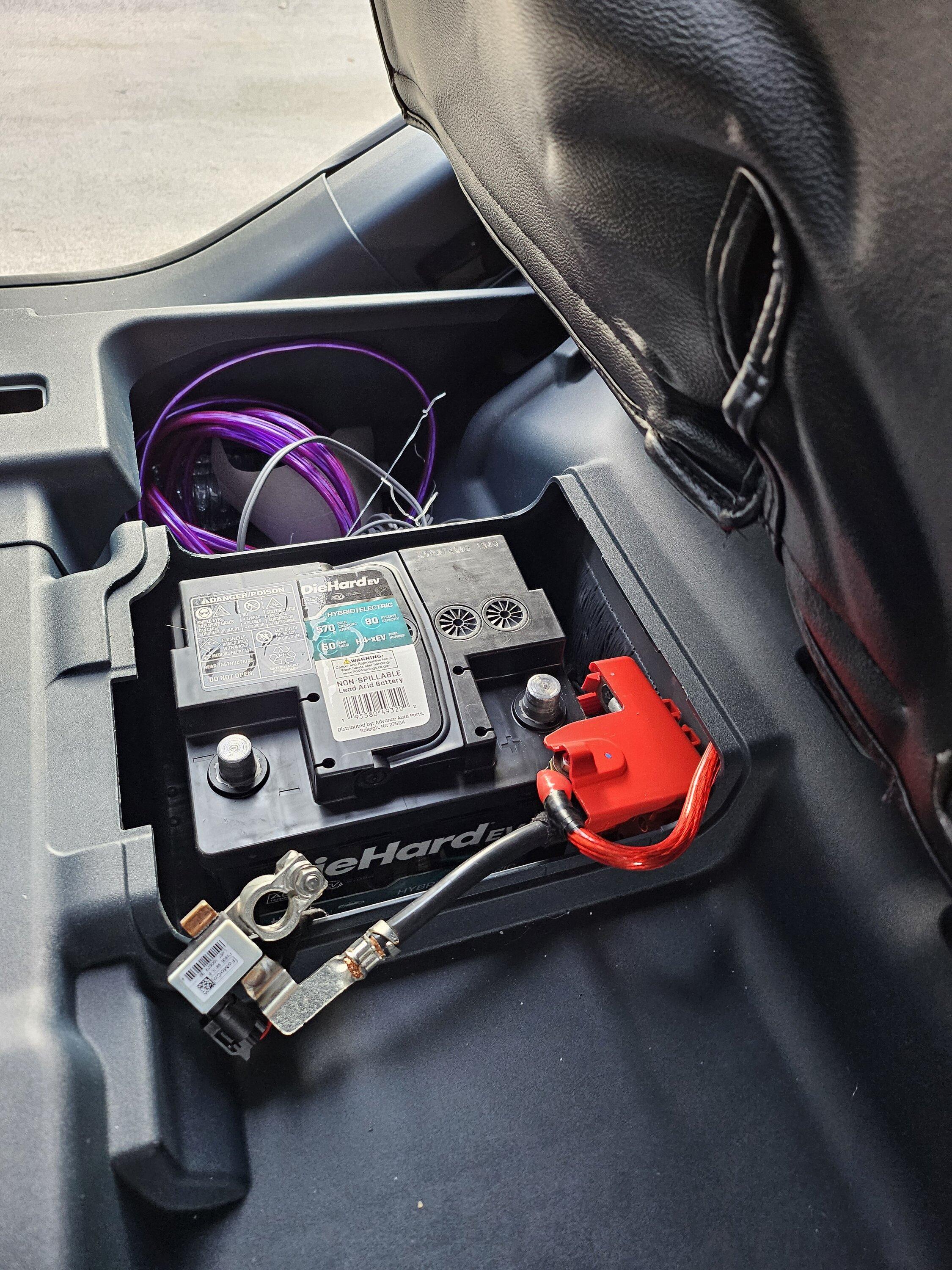

Does the plastic cover still fit on top of the battery after you installed the AGM battery? I noticed that you had to increase to an H4 size battery since they don’t make a T4 battery in AGM.
Yeah, it's almost the same as the OEM battery :)

After dealing with Deep Sleep for 1 month, I pulled the trigger on an AGM battery. A bit pricey, but we'll see how it goes after the computer relearns the battery :)
A quick update on the battery situation.
So far, it's holding voltage perfectly fine, not tanking down to the 11V area after parked for hours. Voltage on the cigarette lighter reads 12.2-12.3V, although Torque shows the voltage a bit higher by .2 (I choose to monitor the voltage through the OBD port).
The Maverick does not appear to have any Deep Sleep symptoms (well, except for FordPass, but that's still an ongoing story), as the interior/exterior light turns on when unlocked. Furthermore, after a short drive, the interior light does not go dead after 10 second, which is a good sign.
After driving around for a while, the voltage stays in between 12.7V-12.5V, again another good thing, since the old battery will drops down to 11.9V no matter how long I drive.
I'll keep everyone updated, but so far, the AGM battery is a huge improvement.

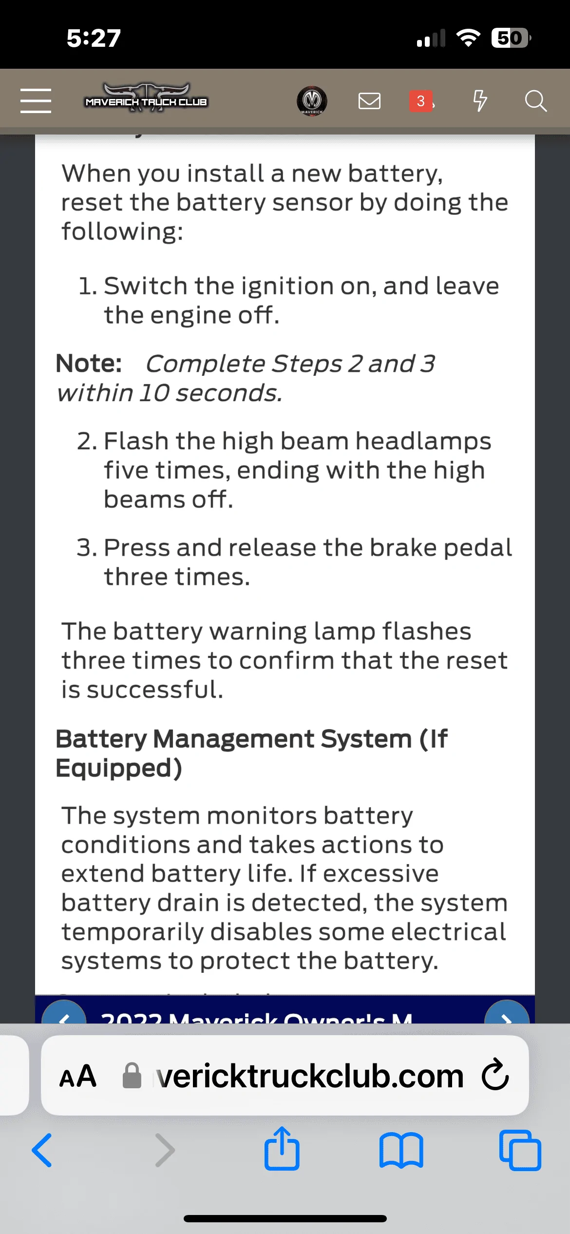

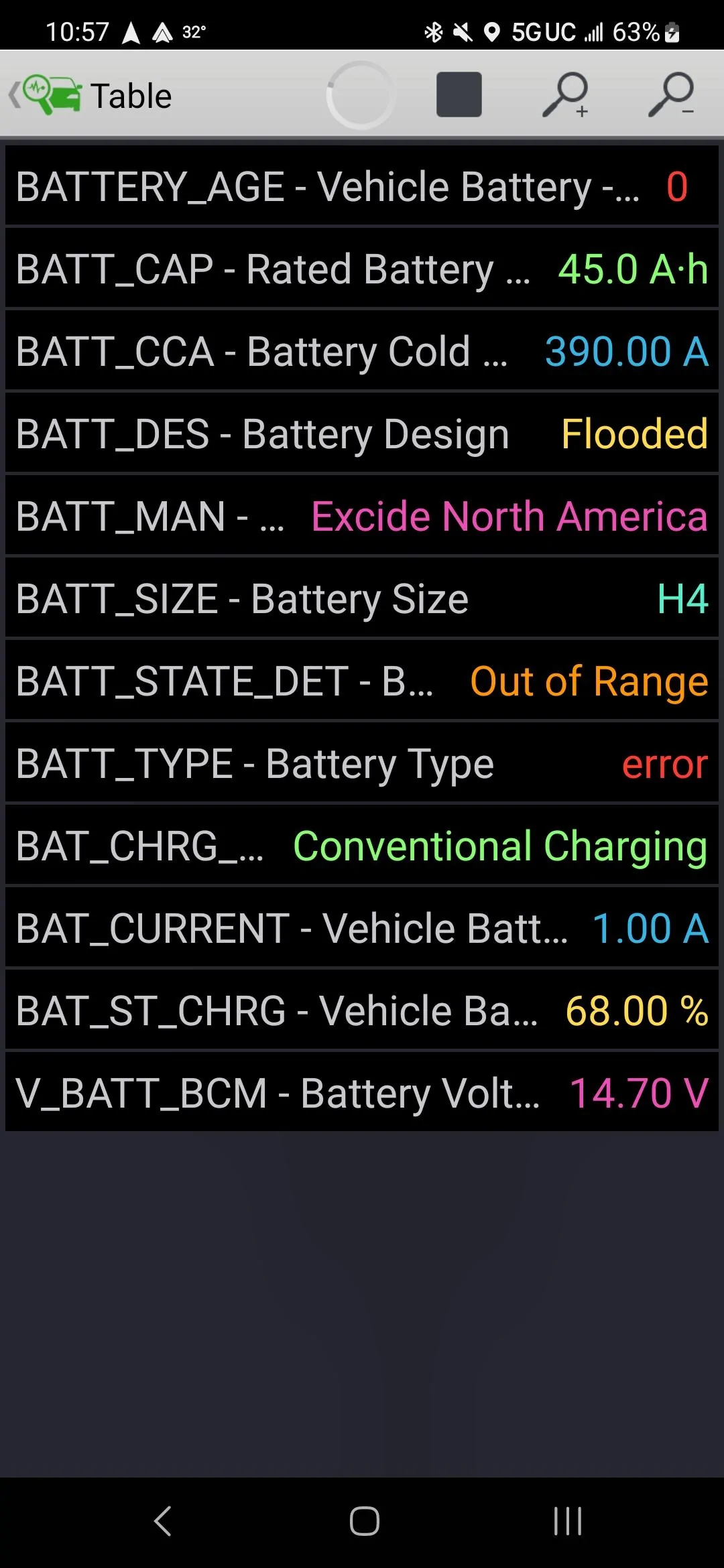

Dumb question, was BMS reset after they installed the new battery? If it wasn't reset the truck complains about the battery level being "Out of Range". I think that impacts charging behavior? In my screenshot below it was only getting 1.00A. Don't think it ever gained any % charge while running around in that state. But I didn't keep it there for long.

The trucks already can't charge their 12V batteries very well, if the dealer gave you one partially charged and didn't reset your BMS so it actually knows to charge it, I could see it going back into deep sleep pretty quick. Might want to fully charge the battery, reset the BMS system, wait 8 hours, take it for a drive. Might help?

This is possible. How would I know if they reset the BMS? Also how would I reset it after charging the battery?

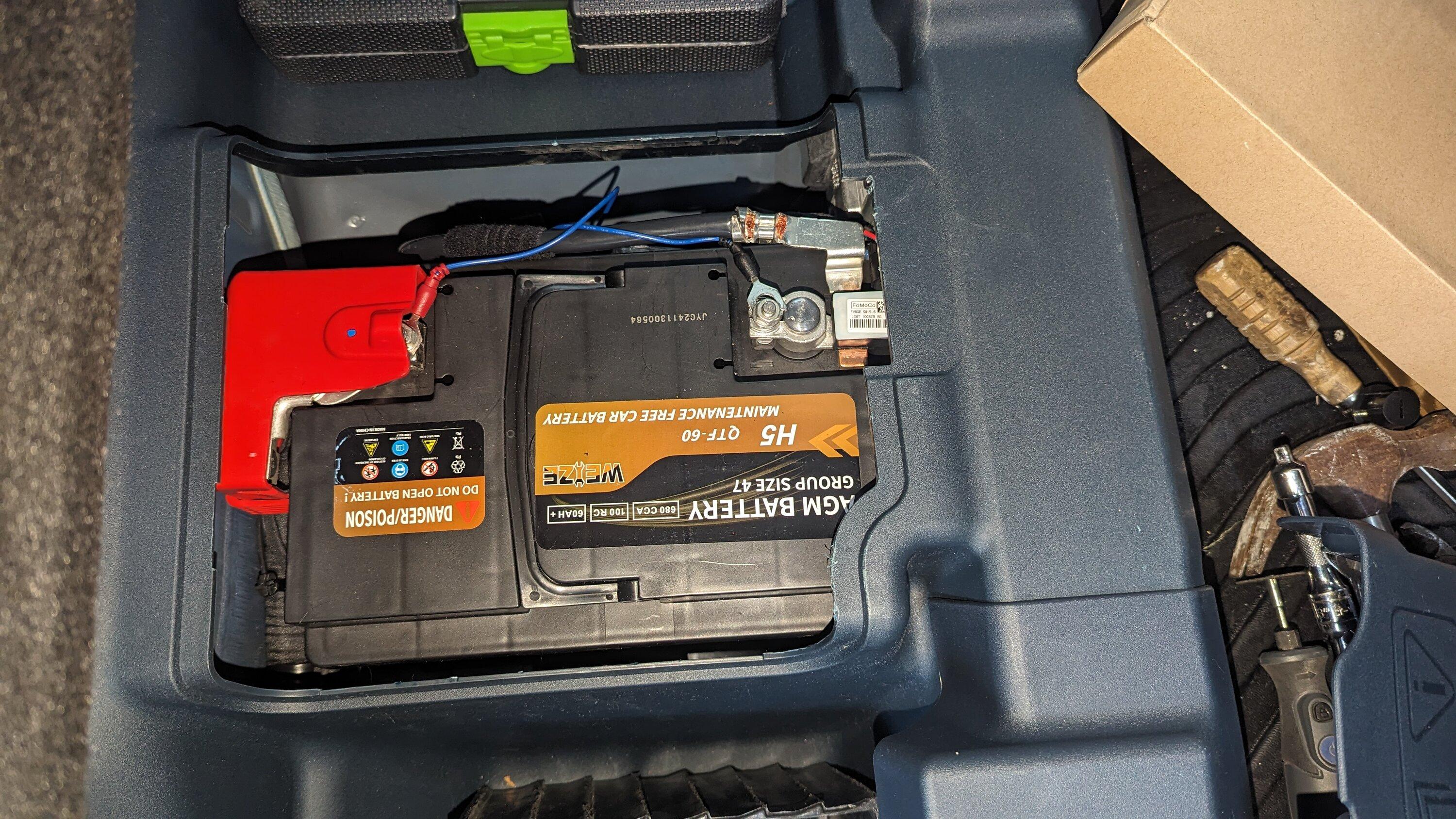

Should hopefully end deep sleeps. So far, so good.

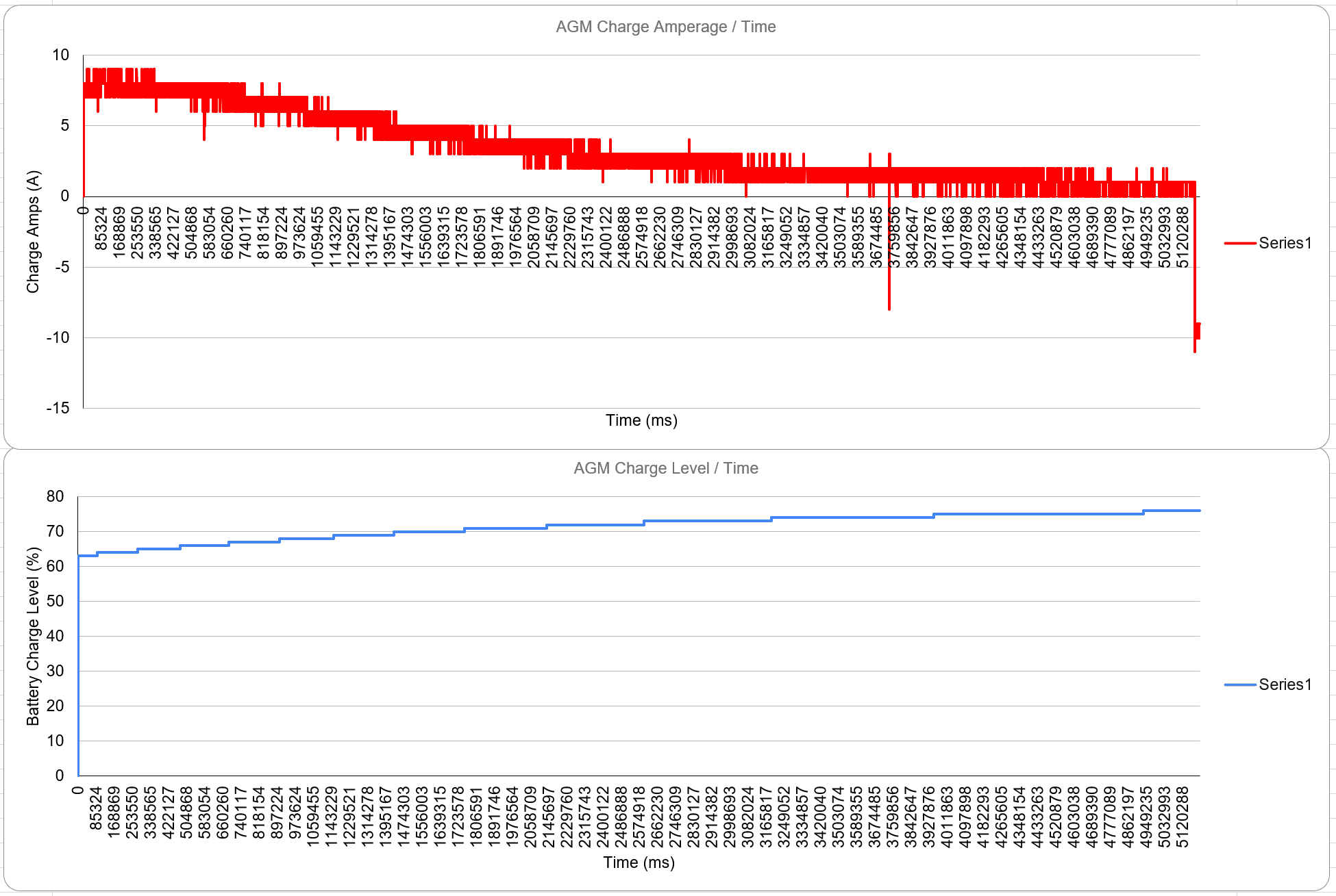

Interesting to note, the tech in the video says his F-150 goes into deep sleep/drains its battery being driven to/from work 6 minutes/day, with the occasional trips on weekends. My commute is 8-9 minutes/day. So driving a modern Ford every day on short trips will not keep the battery charged.

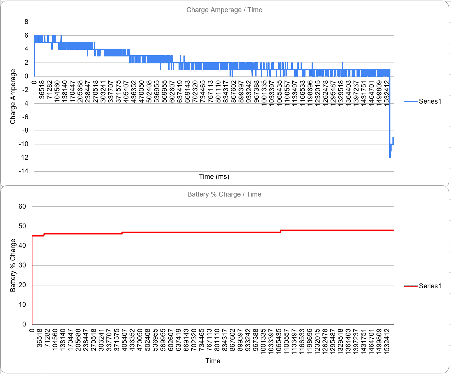

I've plotted charge amps/time on longer trips. On one trip, with my old battery, charging stopped 18 minutes into a 33 minute drive, 0-1A going to the battery. I gained 3% on that trip. That was like my best one too, most of the time it'd quit charging before I made it home, so ~8 minutes of charging/trip. So, with my stock battery, driving the car on longer trips, it'd stop charging midway in. It doesn't charge the whole time.
So, you have to drive it more than twice per day, for longer than 8 minutes each. But the trips cannot exceed 18 minutes or the battery won't continue to charge. Cracked the code guys!
Seriously though, on my most recent long trip, with an AGM battery installed, the system stayed charging for 1.5 hours and the battery gained 13% charge before the system quit charging it. I also gain charge faster and see more amps going into the battery (?) when commuting. Continuing to monitor it in hopes this will be a "real" fix. It has been able to sustain it at ~70%. But with the holidays my driving patterns are all messed up. Need a few quiet weeks to see if it'll stay there.
acapaldi
Andrew
Nov 21, 2022
57
114
Maverick XLT Hybrid
This is an interesting observation. I drive my maverick about 60 miles a day and that could explain why even on my long commute the battery still doesn't charge full.
Aforementioned plot, data recorded on 12/01/23 with Motorcraft FLA battery installed. Started charging at 6 amps, tapered off around halfway in. Started from 45%, finished at 48%. Gained 3% charge. First hit 0 charge amps ~14.5 minutes in.
Ford Maverick Deep Sleep Poll Hybrid Owners 1704166202257
w/AGM battery, data collected on 12/25/23 with Diehard H4 AGM battery installed. Trip as roughly 3X as long. Started charging at 9 amps, tapered off maybe 2/3 of the way in? Starting from 63%, finished at 76% Gained 13%. First hit 0 charge amps ~51.4 minutes in.
Ford Maverick Deep Sleep Poll Hybrid Owners 1704167656882
Same observed behavior, both taper off, but for whatever reason the AGM took longer, and started with a higher initial charge amperage. Despite the FLA battery starting with a lower SOC.
I don't know why/how it decides when to quit charging. I would have thought it was as simple as, "If below target (80%), charge. And give more amps the further below target" Not the case.
This was all highway driving btw, no stopping etc.

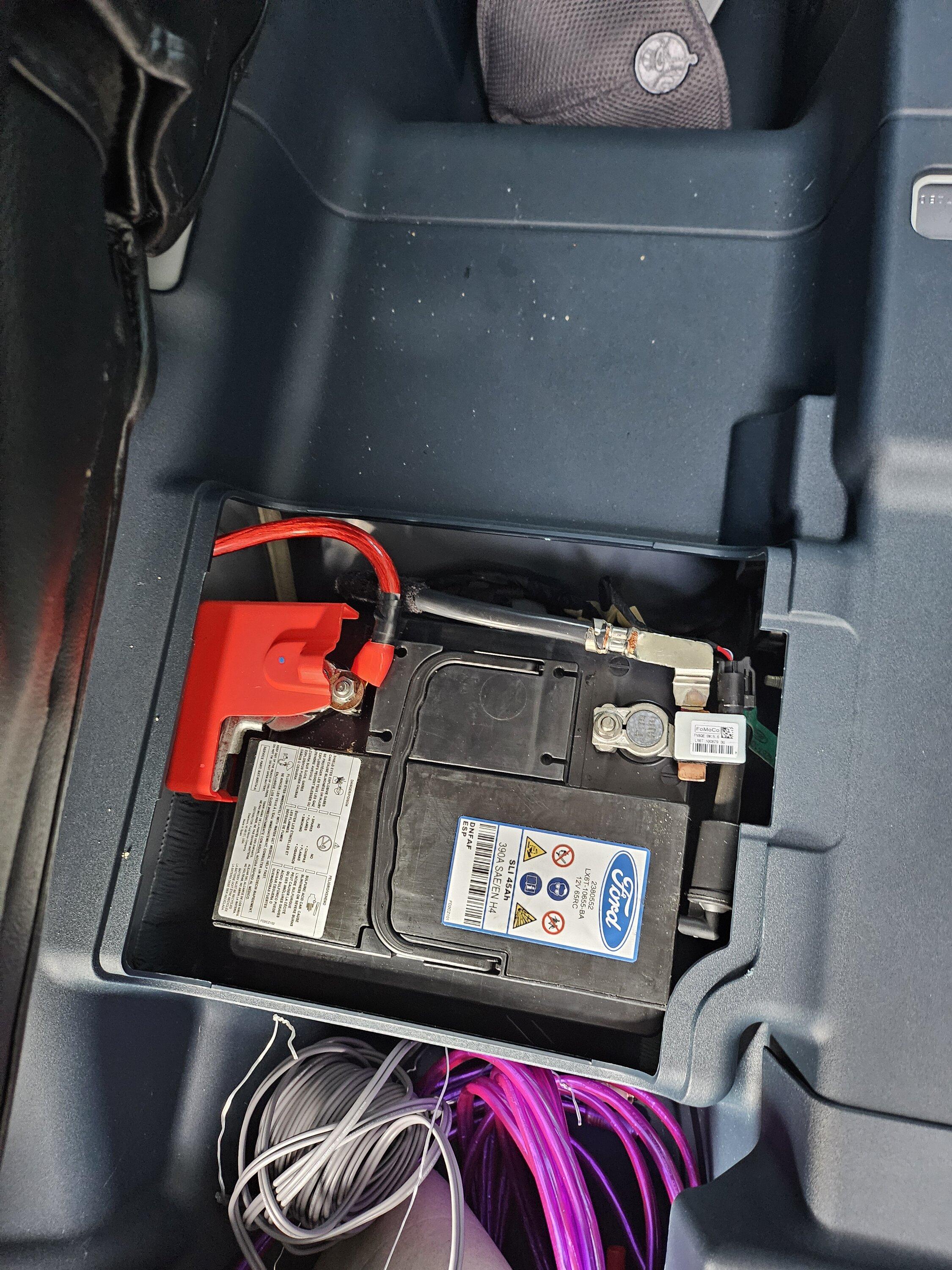

Having pulled my factory battery on Saturday, it's pathetic. I charged it after removal, let it sit for the float charge to dissipate, took a reading. On Sunday I checked the voltage and it was .5 lower with nothing connected or drawing current.
Replacement sat in the vehicle and the voltage was .01 volts lower over the same time, and that was with the typical communications period after having had the ignition on and performing a BMS reset. (I did reprogram the BMS for a 60a battery in an H5 shell, so it wouldn't go crazy with the higher capacity battery). That's also powering the low-draw BT Battery Monitor. (Factory was checked with a DVOM).
