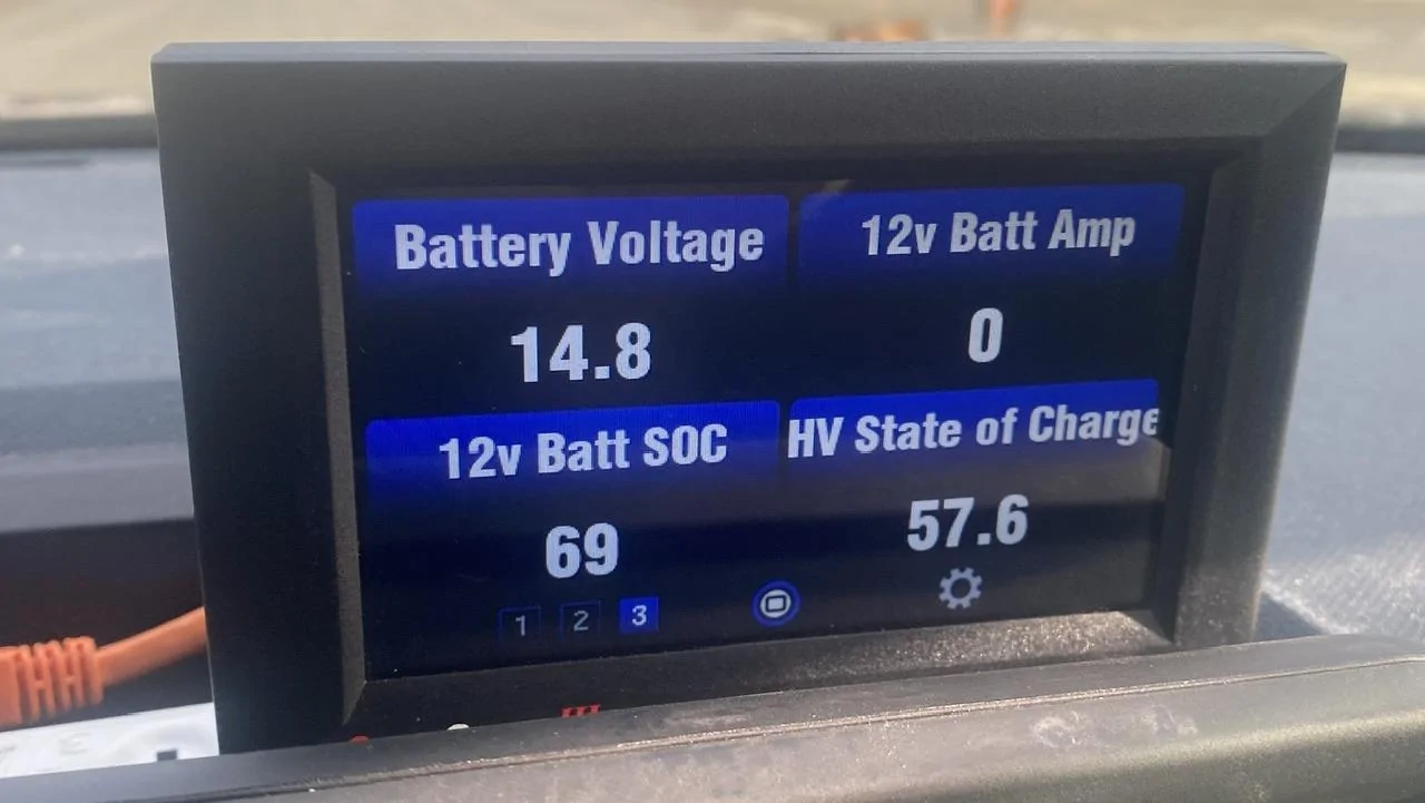

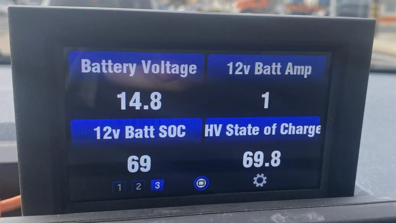

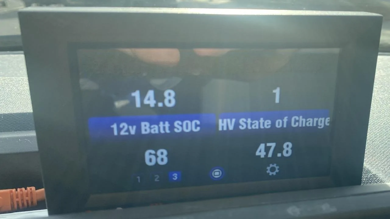

Today:
Ford Maverick Deep Sleep Poll Hybrid Owners IMG_8772
Above : Low (ish) HV battery, just 1 amp going to the 12 volt.
Below : High HV battery, just 1 amp going to the 12 v
Ford Maverick Deep Sleep Poll Hybrid Owners IMG_8777
Bottom: 3 minutes later, zero amps going to the 12v battery.
Ford Maverick Deep Sleep Poll Hybrid Owners IMG_8779
The HV battery is only allowed to be 28% to 72% in special conditions. 30% to 70% in normal conditions. But typical operating strategy keeps the battery about 40% to 60%. I wondered if keeping the HV battery lower reduces 12 volt charging. I've found no such correlation.

Thanks for sharing this data with us. How is your system measuring state of charge and charging current for the 12V battery?
Did you install an aftermarket sensor to monitor current flow in and out of the battery, or do you just have some type of computer that’s pulling this information from the OBD port?
GPSMan
Jul 28, 2022
4,325
5,341
Many
It is a ScanGaugeIII (version 3) in this image above.
It pulls data from the OBDII port.

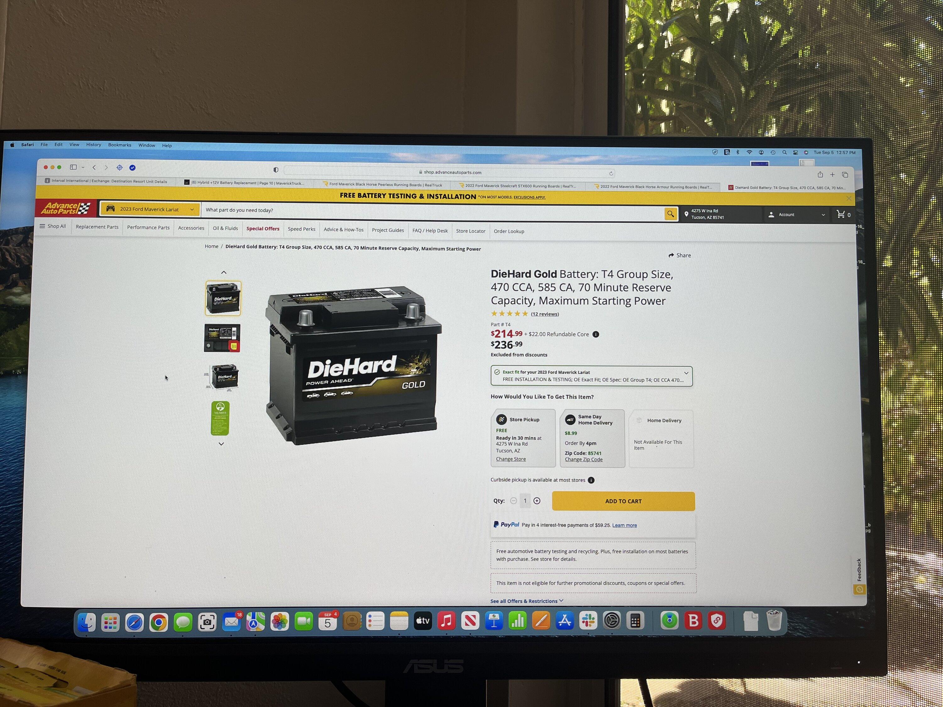

This is the one I installed. Haven't had any deep sleep since, but it's only been a few months. My stock battery didn't start giving me deep sleep issues until about 8-9 months after buying the truck.
I did start locking my truck while in the garage, maybe that helps.
I'm not going to disable Ford pass, that's how I get notifications if my Perimeter Plus alarm has been set.
