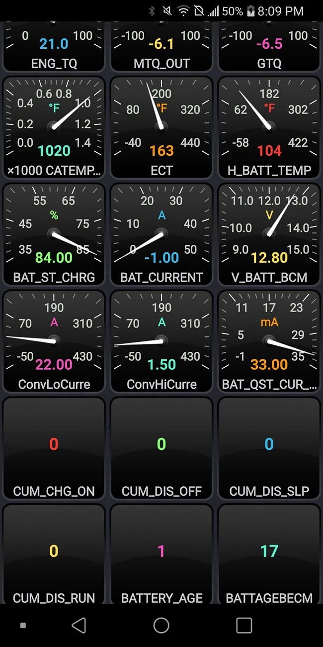

Ya those 4 PIDs are Ah's it appears from the calcs, so very slow changing. One look and not really useful again for awhile.
You should find the 12V battery Amps incoming if not a watched PID - see if you notice the same high 7-9 amps for maybe a couple minutes, 4-6 for several more, and then staying around 0-2 thereafter for a drive.
No wonder a 4.5 hr drive needed to see notable difference!
Finally found the incoming 12v battery amps PID and I can confirm that you are spot on. Starts out at 7-9 for a couple minutes then drops down to 5-6 for a few minutes then drops again to 3-4 after about ten minutes and settles at 0-2 after another fifteen to twenty minutes. It’s no wonder that we have to drive for several hours to truly charge the 12v battery at these stupidly low recharge rates which drop quickly over a short period post start!

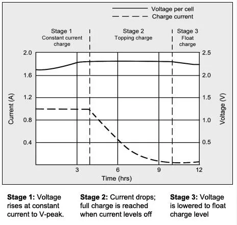

It's like an engineer saw this good tested advice, and misread the time scale.
I guess it's good they caught the need to do the values x6 for all the cells!
https://batteryuniversity.com/article/bu-403-charging-lead-acid

Just FYI regarding Ford's value they call SOC%. It's not the industry definition.
85% is a full charge for their value.
12.75 V per multimeter.
So 80% is likely when it's supposed to switch to float charge, nothing to do with fully charged level. Just lowering the charge to protect the battery from overcharging.
Who knows what craziness made them call full charge 85%.
Their PID only displays tenths, so rounded to 12.8 V.
Fully charge a battery.
Install Negative cable.
Have OBD adapter in and Forscan Lite ready to go.
Turn key to Acc, get Forscan connected.
Read the PID for 12V battery SOC%.
85% is max.
Or in my case - take MM reading at dealership after new battery. Drive home and catch this.
I'd warrant whatever the change to 100% causes - changing to 85% would do the same.
Considering none of the other PIDS for battery like that are actually used, I'd be curious if that max rate really is nothing more than an orphan control item.
Do the scanner PID values for SOC% actually go above 85%, do the amps actually not drop to 1 Amp pretty quickly?
Sadly it seems those that have changed that SOC value have never reported what is shown for the other live values.
