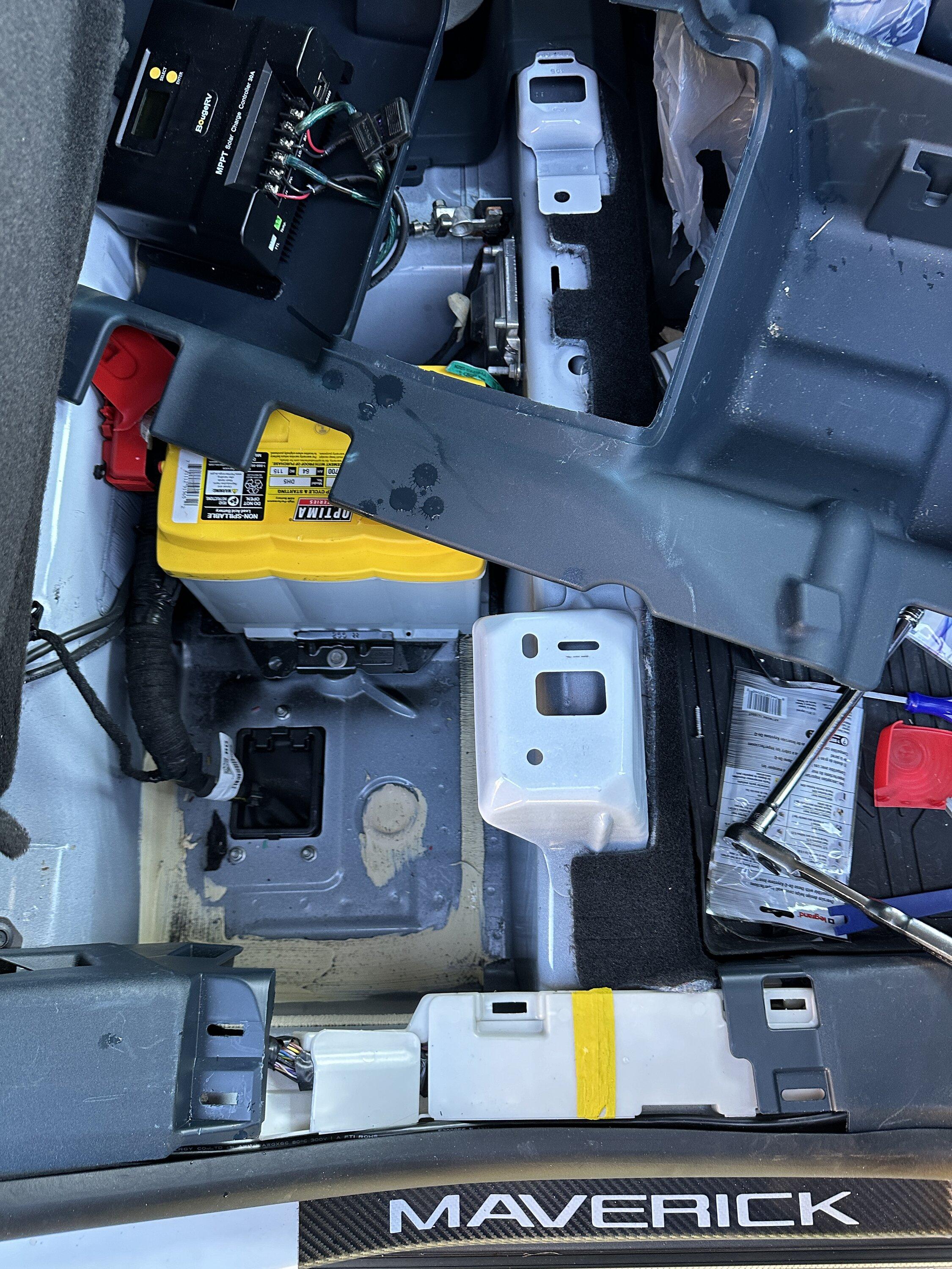

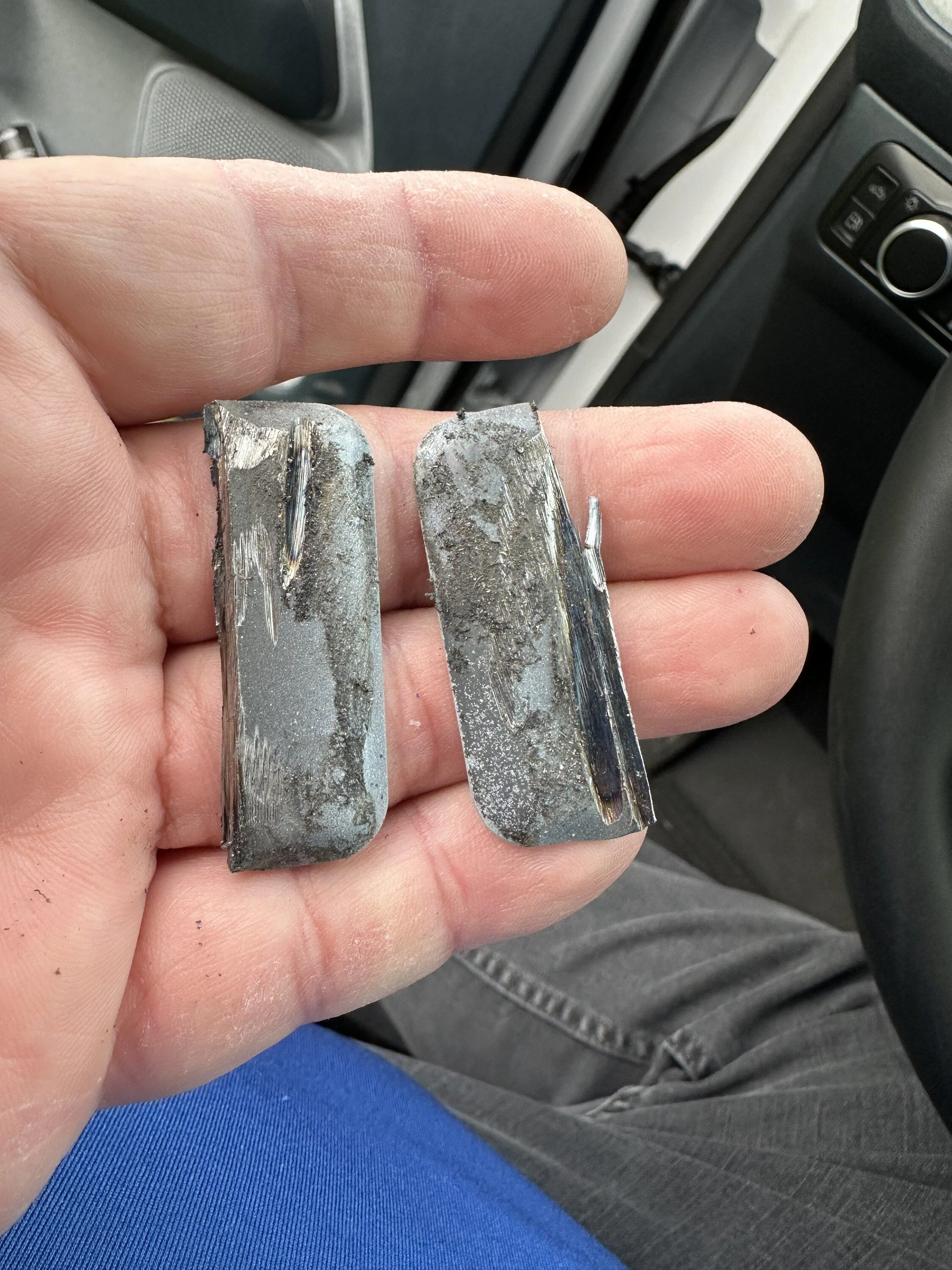

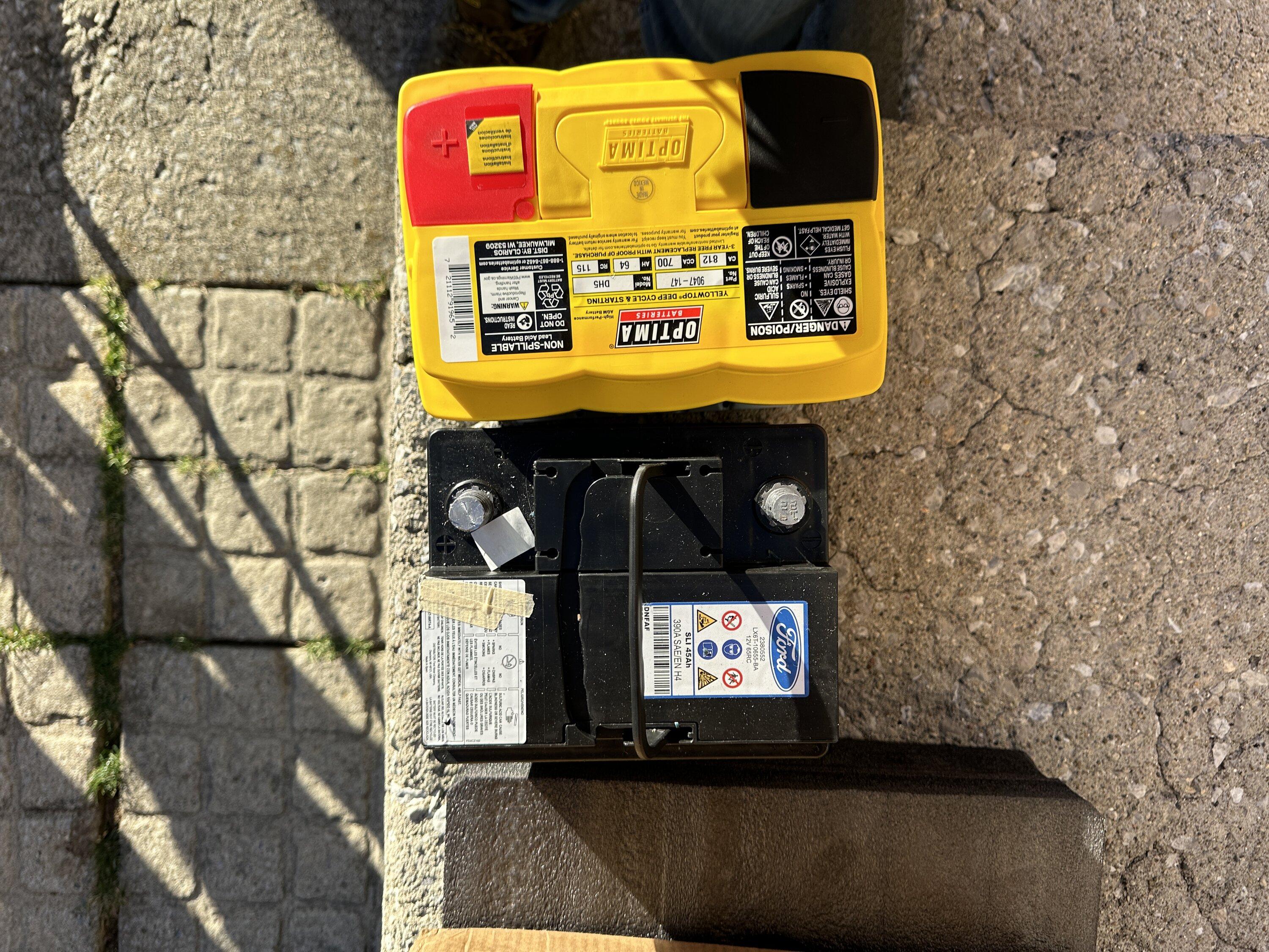

I used a DH5, had to cut off 2 small ears in the tray. Search the forum for tech tye and I have pictures
Wow! Great help! Thank you!!
Not being versed in the world of electricity, I was afraid to buy a battery that would show "not compatible" to my 2023 hybrid Maverick. When I go to purchase another battery (hopefully years from now), can someone explain to me what type/Style/Amp batteries are ok to use in my 2023 Maverick Hybrid?
Per owners manual, mine on page 357, hybrid takes: BXT-99RT4-A
ecoboost takes: BHEF-48H6 (I think known as a Group H6 battery)
This is in the "Capacities and Specifications".
