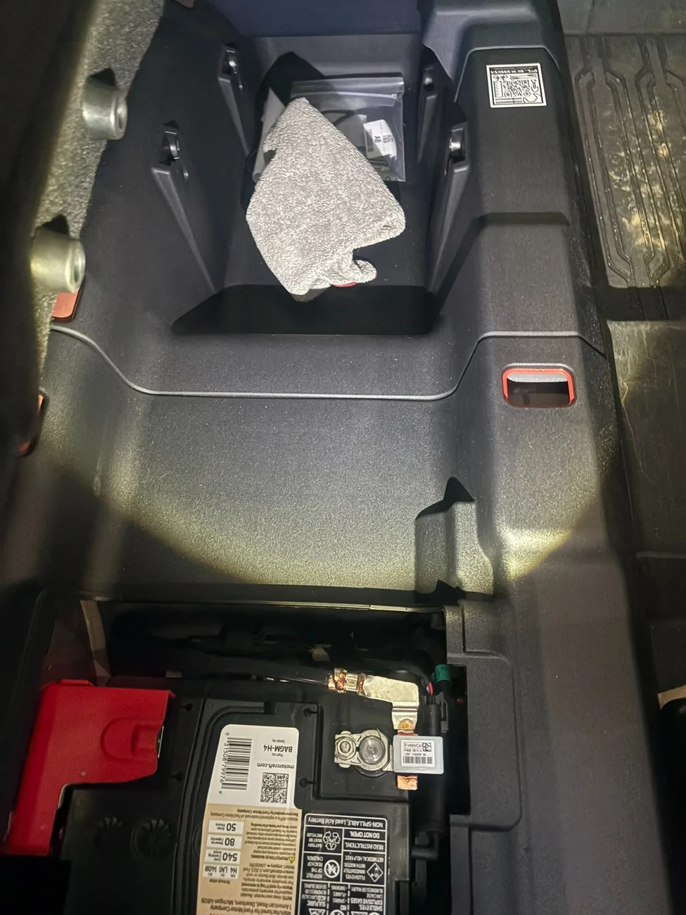

The day after I posted this comment one arrived at our dealership. It did not have a excess draw during the day when I kept checking it. But the battery was almost dead the next morning. So I am going to have to leave the stand to connect it all night and monitor several individual circuits until I see which one woke up during the night. It may take several days to find the culprit. Once I get access to the equipment. The particular equipment that I need to do this test is being used by another mechanic for a different vehicle for a stubborn electrical issue. Usually that equipment goes unused for months. Now two of us needed at the same time
