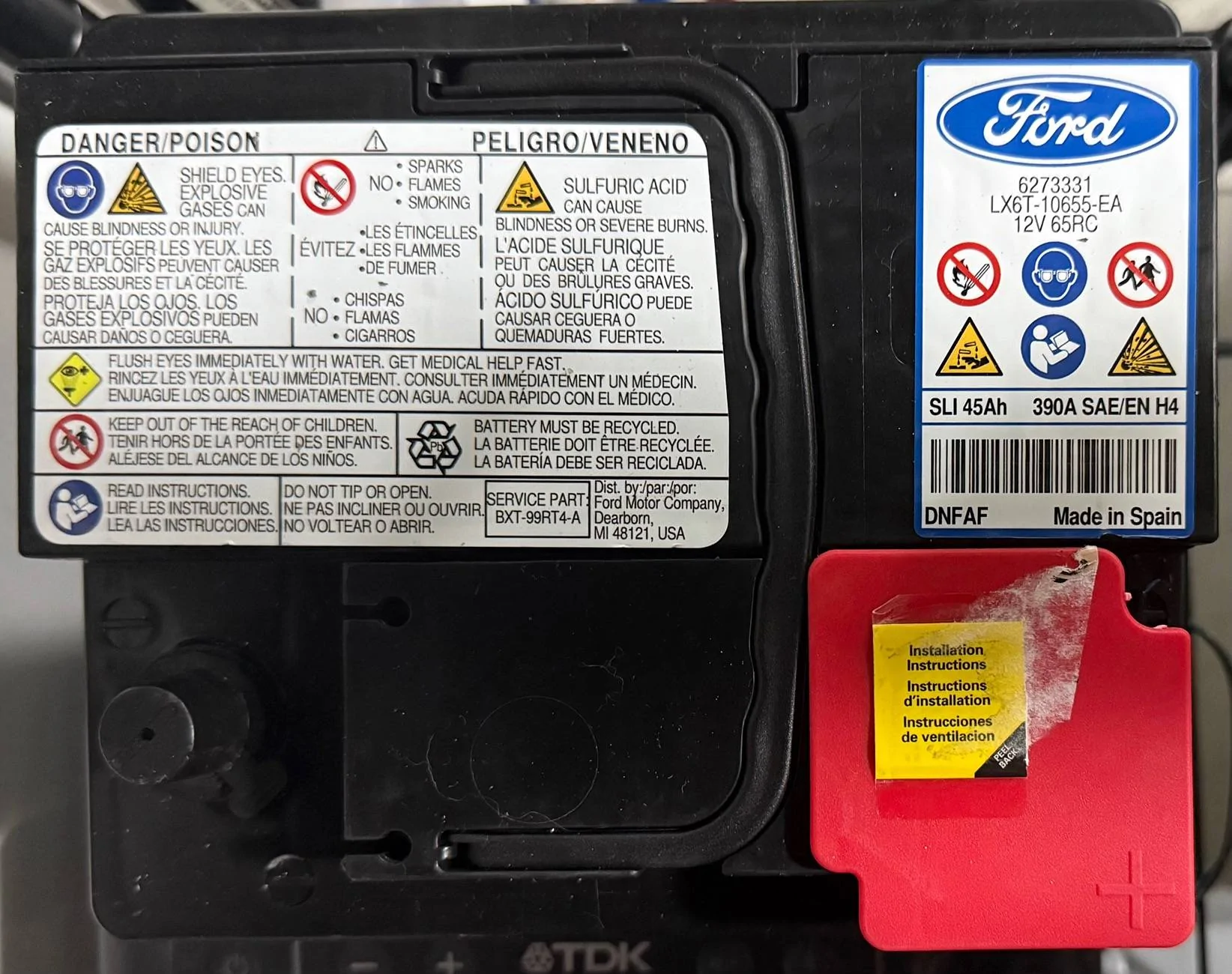

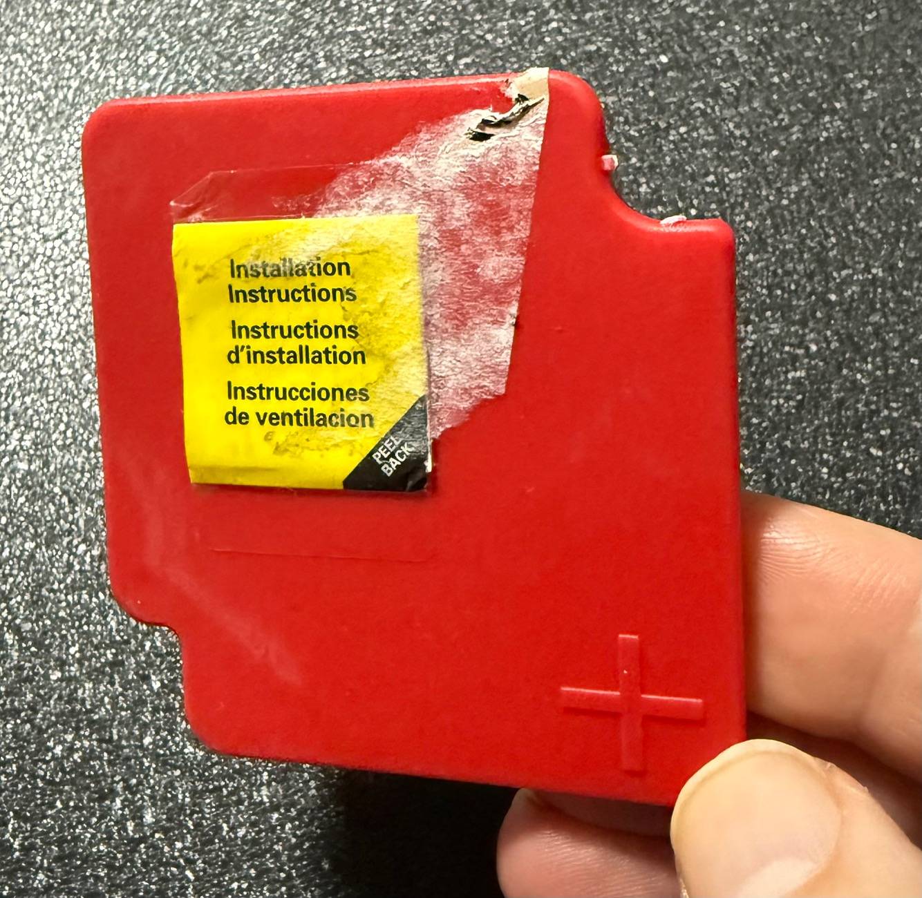

Some of them have both vent holes plugged and you have to open it on the correct side with something sharp.
Breaking off a plug to push into the correct side is much easier.
None of the battery makers know which side your vent tube is on - you will always have to do something.
Or leave it venting into cabin. I'm sure no issues there.
(then again, the current BMS won't have a chance to overcharge it, so no current issue)
I was under the impression that those with both vents "plugged" had pressure relief valves 1.5-3 PSI to help keep gasses within battery and possibly recombining back into water. The plastic plug would keep the gas from escaping from the regulated hole and forcing it out the side with the vent tube. At least on the battery specs of the two I researched.
I saw a couple videos of batteries with those cap areas removed and saw what appeared to be that relief valve. I imagined the vent hole plug on the cap was for taking care of that not-normal event gases if it did occur.
These sealed ones require that valve.
So 1st it would have to burp to matter.
2nd the cap would need that vent hole open and attached to hose to get the gases under the truck.

Good to know. If I do buy a AGM don't get AC delco. I don't want to have to break things off to use vent whole, I assume other batteries this is not necessary ?
I am not sure why you would avoid a well known battery company because the tiny easy to loose vent plug is molded into a part that stays on the battery until your ready to install it?

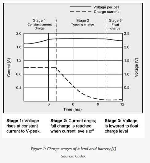

12 v Charging curve pretty much sucks, same with HVB topping out around 70-72% max…..would really like that to be around 85%, no?! Bill P
I'm pretty sure the curve matches this very closely.
Only the Ford programmers misread the time scale and used Minutes instead of Hours.
