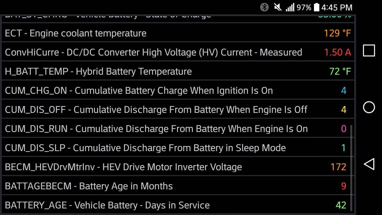

OBDLink MX+ dongle readings at truck startup and shutdown. Great software package with access to all kinds of interesting and some obscure PIDs specifically identified for Ford Maverick. No Forscan changes. Driving patterns were unchanged during the winter with no extra idling. Absent a long duration drive ( which are very infrequent), SOC hangs around 65% -68% during this spring season so far; winter was lower by 10% to 20%. The 35% low winter SOC was unusual and not typical of readings (below zero weather and not driven for three days) ACDelco LN1 (H4) AGM. Resting voltage ranges from 12.6v to 12.8v.
So do you have these 4 PIDs shown below about charge/discharge available perhaps?
Curious where they have gotten to since 8/24 with your new battery - I'm assuming you did a BS reset at that time? (would show in BATTERY_AGE, not sure how the BATTAGEBECM is reset, or if that is the HVB)
Mine are now 16 charge, 14 discharge off, 3 discharge sleep. (come on BECM, make the charge at least match the discharge!)
I’m not monitoring the four PIDs you mentioned but, I’ll take a look at what’s available. I was following hybrid battery age but I replaced that measure with a hybrid battery PID for amps and volts. I also follow hybrid battery temp. Charged the AGM for three days prior to install and did the BS reset, at install, then let it sit locked for 12 hours. The 12v charge is simply inadequate against the drain !!! Even the faster charge and slower discharge on an AGM is challenged by the Mav!!
Ya those 4 PIDs are Ah's it appears from the calcs, so very slow changing. One look and not really useful again for awhile.
You should find the 12V battery Amps incoming if not a watched PID - see if you notice the same high 7-9 amps for maybe a couple minutes, 4-6 for several more, and then staying around 0-2 thereafter for a drive.
No wonder a 4.5 hr drive needed to see notable difference!
