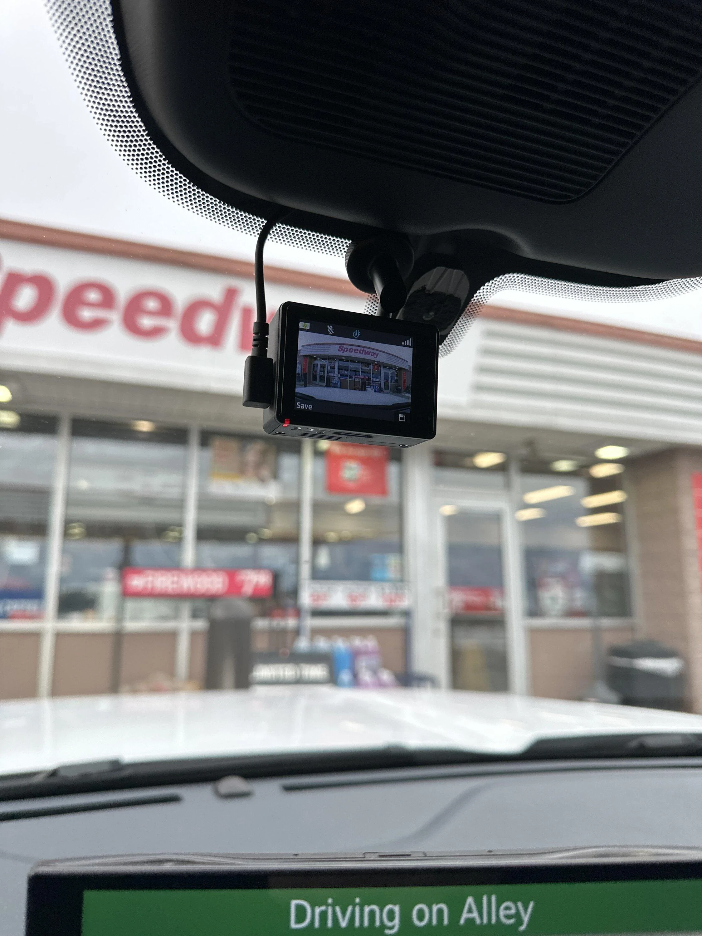

My mini 2 broke last week, went to look at video and nothing but snow. Upgraded to a garmin 57 as the wire harness fit

It def links to the phone better when I go to download a video. Also I know it’s working as it has a 2” screen to verify the image sensor is working. The picture is 1440 instead of 1080 which is a little sharper. Has all the same commands as the mini 2 such as “ok dashcam, take a picture”
