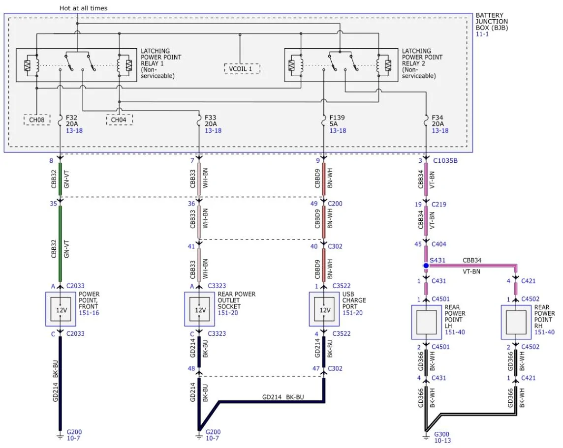

What relay is the 12v flex bed on?
Might throw an extra battery back there. It will only be connected when the engine is on to charge.
Replace the Relay with a push button bypass version. If the main 12v is dead, pop the hood and push the relay a few seconds. Spare battery will jolt the system enough to start.
Latching Relays are integrated into the Battery Juncton Box:
