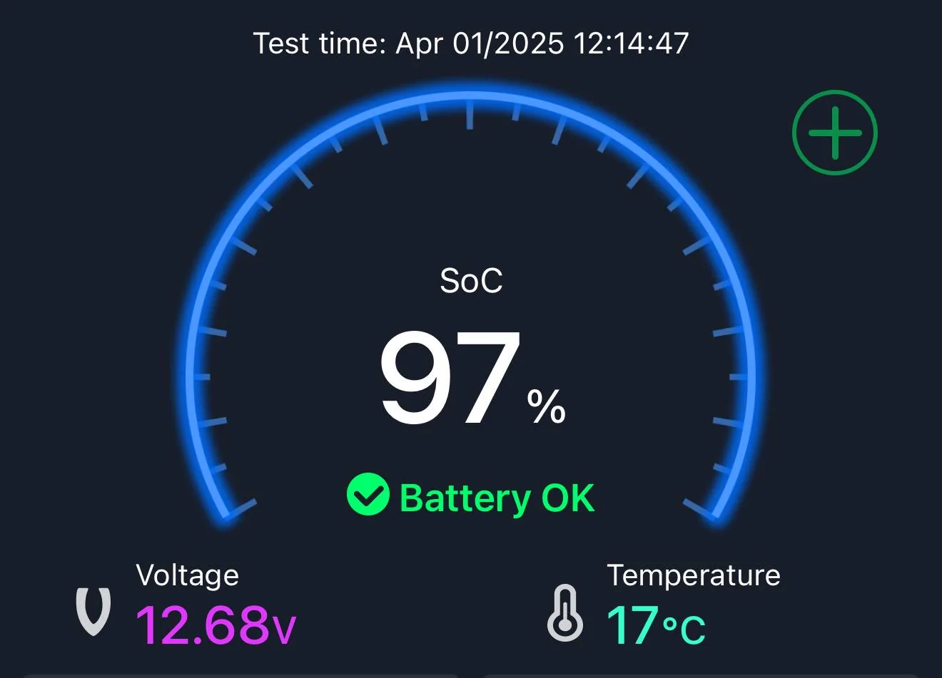

This is the status a few hours after taking the truck for its first decent run since changing the battery from the OEM battery to an AGM. I have not changed anything using FORScan. I am not sure why it is showing 97% if the BMS maxes out at 80%. Maybe it’s because the BMS was just reset and is relearning or more likely the BMS uses a different way to estimate the SoC compared to the app I am using.
So it's been a few hours since truck was "started"?
Also is your app checking for AGM soc or a standard flooded battery?

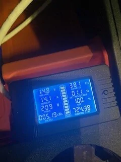

And installed a volt amp meter to see what going on with the battery while I am driving the truck or when I look thought the window when the truck is off.
I did not change the "percent of charge" since most of the time is was charging at 15.0 volts.
I checked the DC to DC converter, and there no problem putting out current, my test showed 85 amps.
Now since it has warmed up, the charging voltage is down to 14.8 volts
I will be looking into the powerpoint time out.
There is a drain on the battery, but that normal for the electronics.
The picture was taken after starting up after sitting overnight.
After 15 minutes current charging the battery drops to less than a couple amps.
The battery is the factory flooded battery, and load test fine, I have seen my amp meter show 40 amp at 15 volts.
Still doing research.
Your post reminded me I had not let the app know the battery had been changed to an AGM from a Flooded Cell. Making the Change did not make any immediate difference but I will look at the data over the next few days. I can see a much different decay rate on the V and SoC graphs.

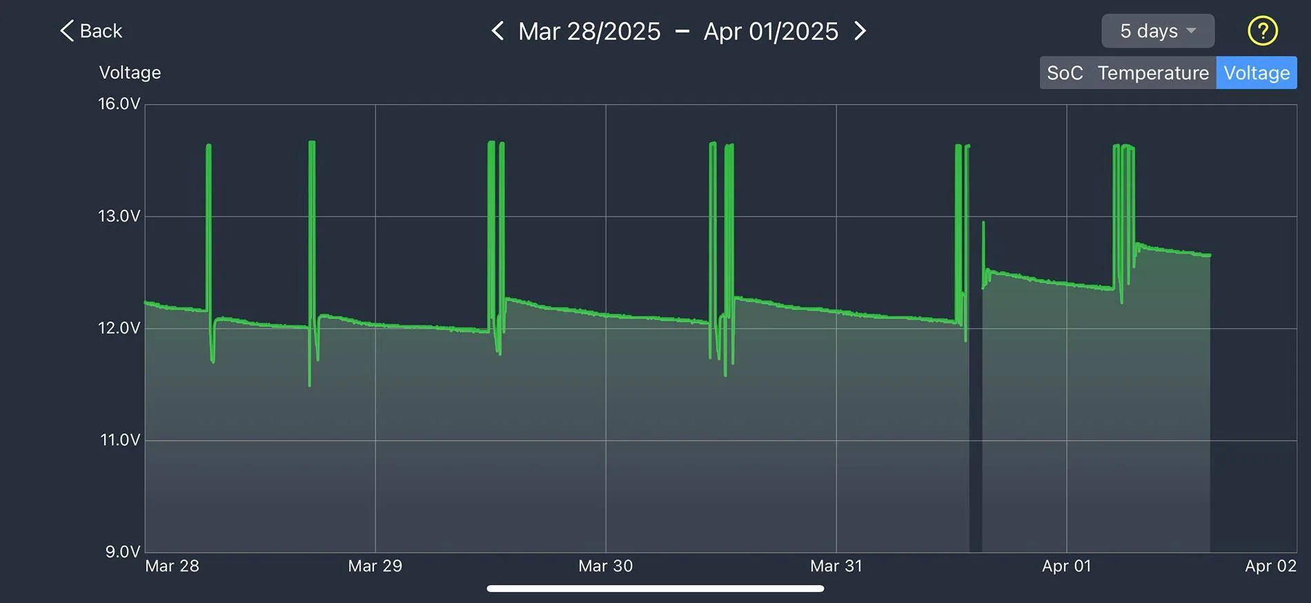

From that AGM stats from @MakinDoForNow - appears your device estimate isn't too far off.
That 80% setting, appears to be more a limit to the constant current charge, than overall charge allowed or what it'll report. My truck scan data reported 85% after a charge, and relearn overnight.
A couple posters with AGM's have reported their V & SOC% and while eventually it does come down over months, the BMS system is more than willing to allow it higher, even if the amps drops majorly after 80% on a drive, just like usual.
You did the BMS Relearn though with truck locked overnight? Besides the BS reset you mentioned.
Ya, I'm convinced the system's method of SOC% is very different than straight voltage.
Doesn't appear to be a good system either.

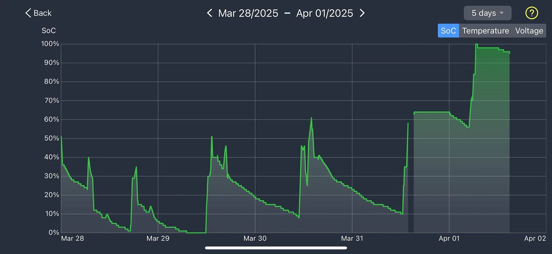

…You did the BMS Relearn though with truck locked overnight? Besides the BS reset you mentioned.
Yes, I reset and locked and left it until the next day.
The AGM does appear to hold the charge much better than the OEM battery. The SoC did come down to mid 60% after a quick run to and from dinner last night. I am about to go for a longer drive so I will see what it does now that it is close to the low end of the operating range.

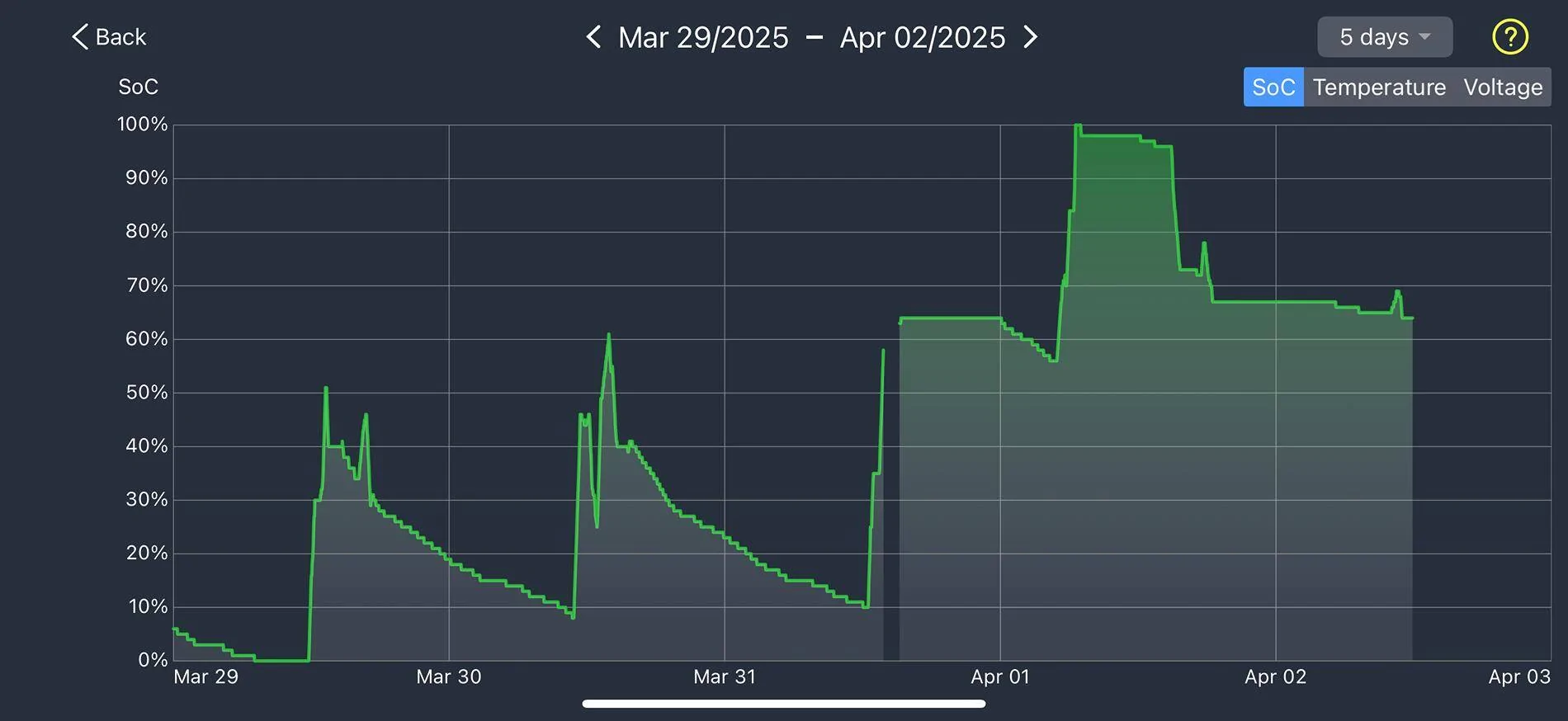

After a recent 4.5 hour drive, my AGM went from a 44% SOC to 84%. That’s the highest I’ve been able to charge the AGM thru driving. Installed AGM August 2024 and it performed well thru the New England winter. Even went as low as a 35% SOC and still had dome lights and start power.
Curious on this upon review.
What's giving your SOC% readings - OBD scanner data of what truck thinks it is, or a battery tester or charger or other means?
Before turning key to On or being driven?
Did you make a Forscan change to the mythological 80% charge figure?
Did you drive less in winter, or about same plus extra idling perhaps?
Thanks for extra info, your 84% caught my eye.
OBDLink MX+ dongle readings at truck startup and shutdown. Great software package with access to all kinds of interesting and some obscure PIDs specifically identified for Ford Maverick. No Forscan changes. Driving patterns were unchanged during the winter with no extra idling. Absent a long duration drive ( which are very infrequent), SOC hangs around 65% -68% during this spring season so far; winter was lower by 10% to 20%. The 35% low winter SOC was unusual and not typical of readings (below zero weather and not driven for three days) ACDelco LN1 (H4) AGM. Resting voltage ranges from 12.6v to 12.8v.
