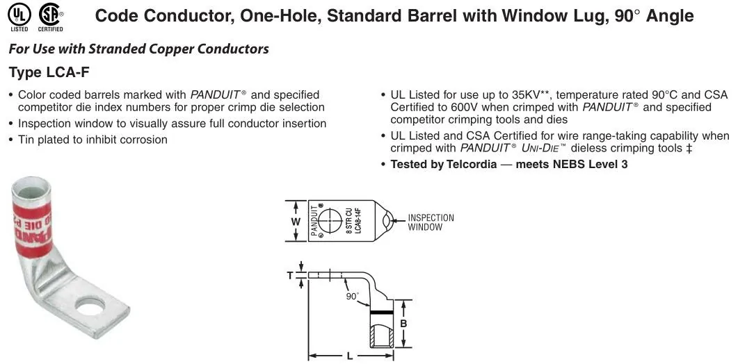

Wondering what gauge the wire is that has the problem lug and the stud size, M10?
If I had to I'd use the hydraulic crimped lugs.
I have a few Panduit 90° lugs for 1/0 with 3/8" stud on my backup batteries.

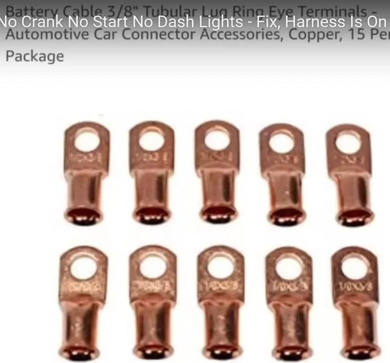

I paused his video & squinted, looks like 3/8 stud, 1/0 Copper Lugs he used.

That series of videos is ~8 months old here. Multiple threads here of those who had the entire harness replaced but continue to experience the deep sleep and/or no start issue..
Also discussed is that it’s not generally advisable to put a CU terminal on an AL cable...
