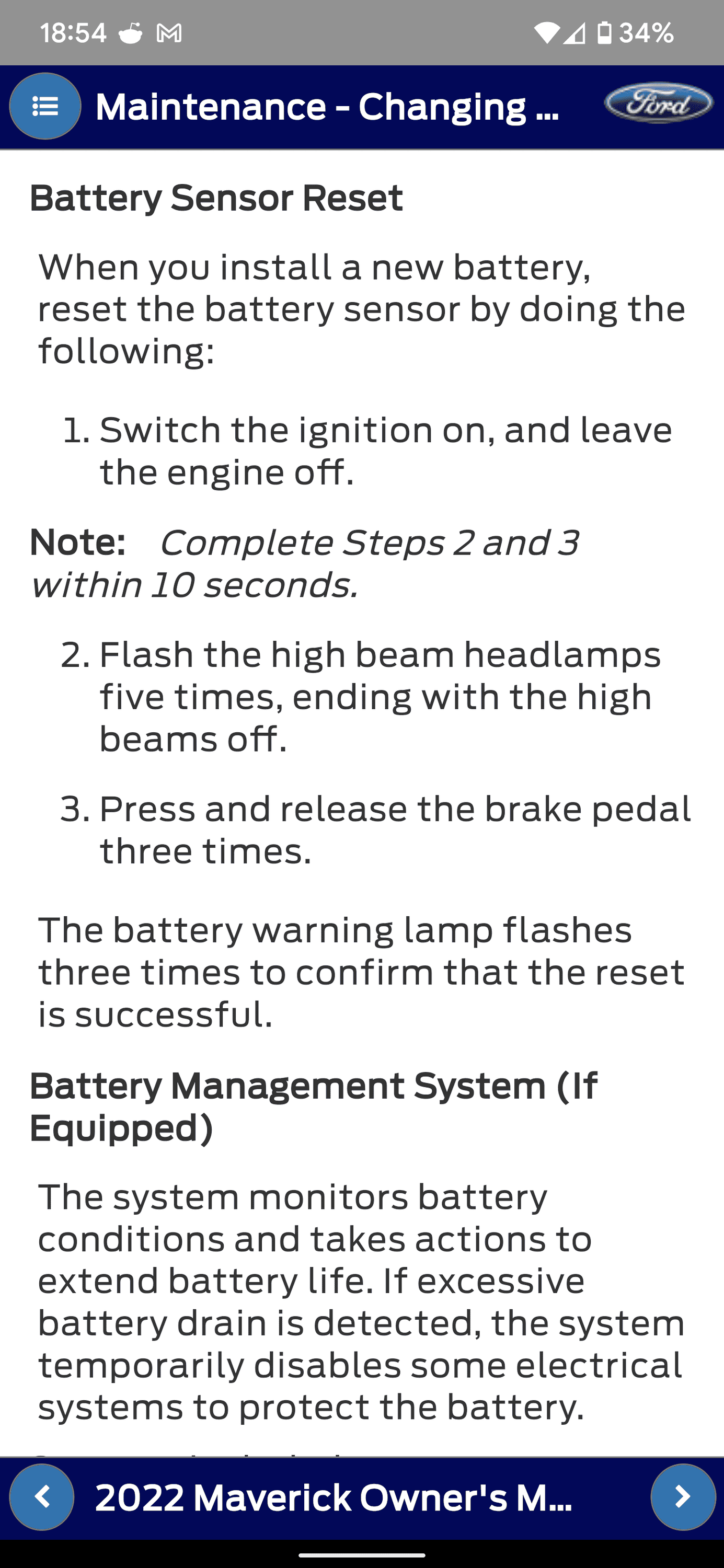

Have you tried resetting your BMS? I was getting the deep sleep regularly on my Maverick. I reset the BMS on January 16th and haven't gotten deep sleep message since.
I have not but will give it a try.
Just a note that after that section in the manual that shows how to reset the BMS, there is the following paragraph:
After battery replacement, or in some cases after charging the battery with an external charger, the battery management system requires eight hours of vehicle sleep time to relearn the battery state of charge. During this time, your vehicle must remain fully locked with the ignition switched off.​
So be sure you do this when you are done for the evening, so it can sit the full 8 hours. (And don't forget to lock the doors, even though many of us don't normally do that when we park in our garages...)
