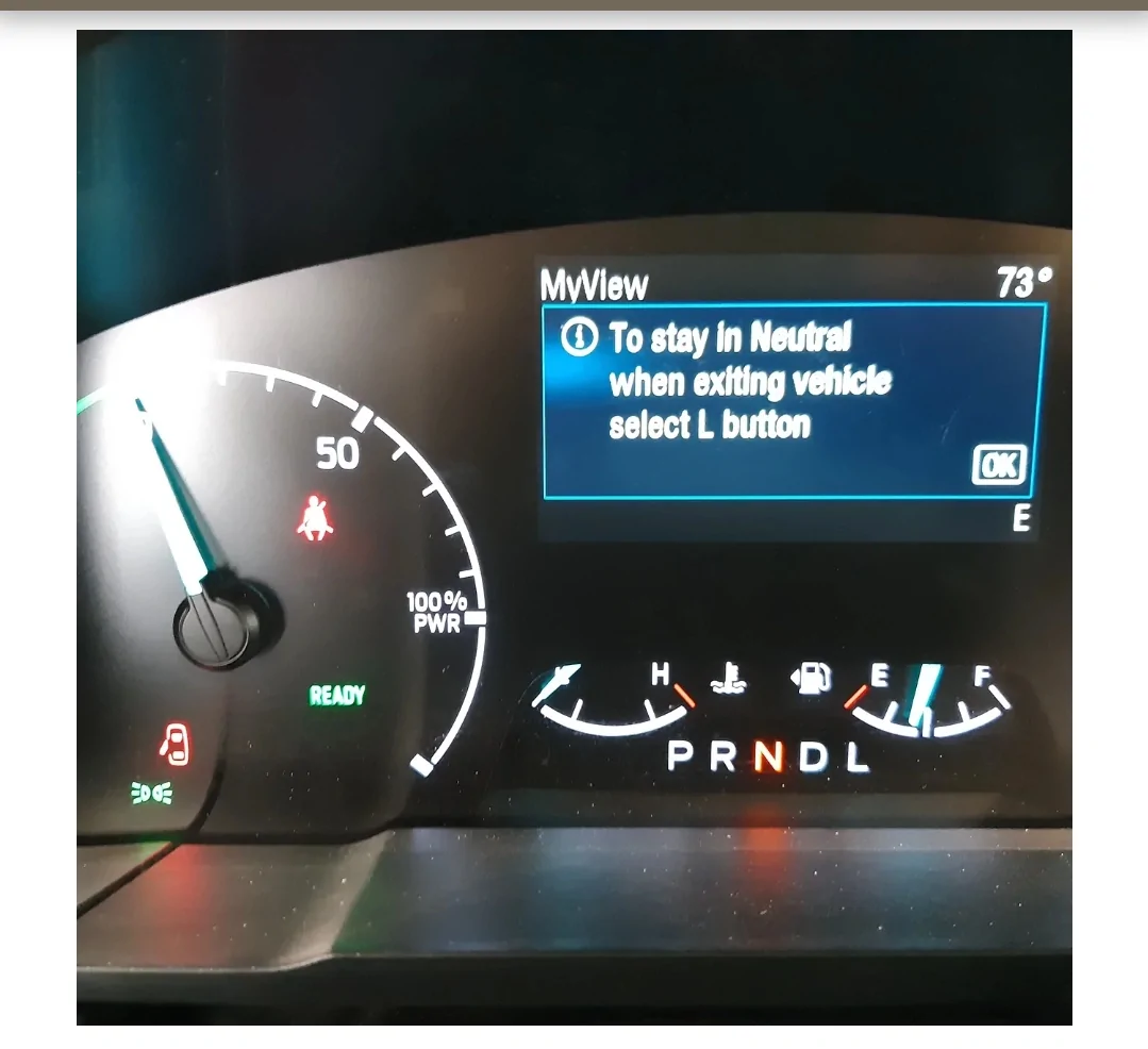

When in neutral, for car wash you have to push the "L" button (there should be a pop up on dash = "To stay in neutral push L button"). I would stay in drivers seat with truck ready to start ice if ready.
The pop up says,
To stay in Neutral WHEN EXITING VEHICLE select L Button

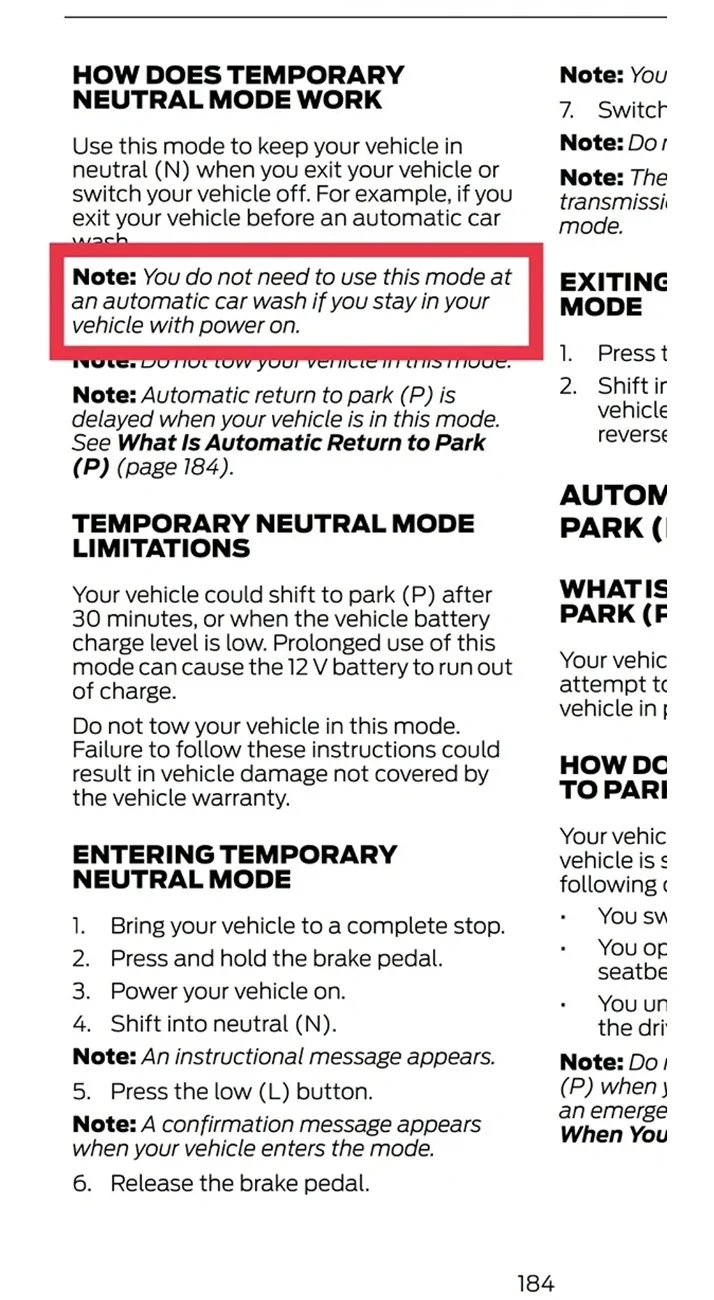

This is what the manual has to say on the subject.

The pop up says,
I wonder how quiet this Forum would become if everyone read the owners manual ?
