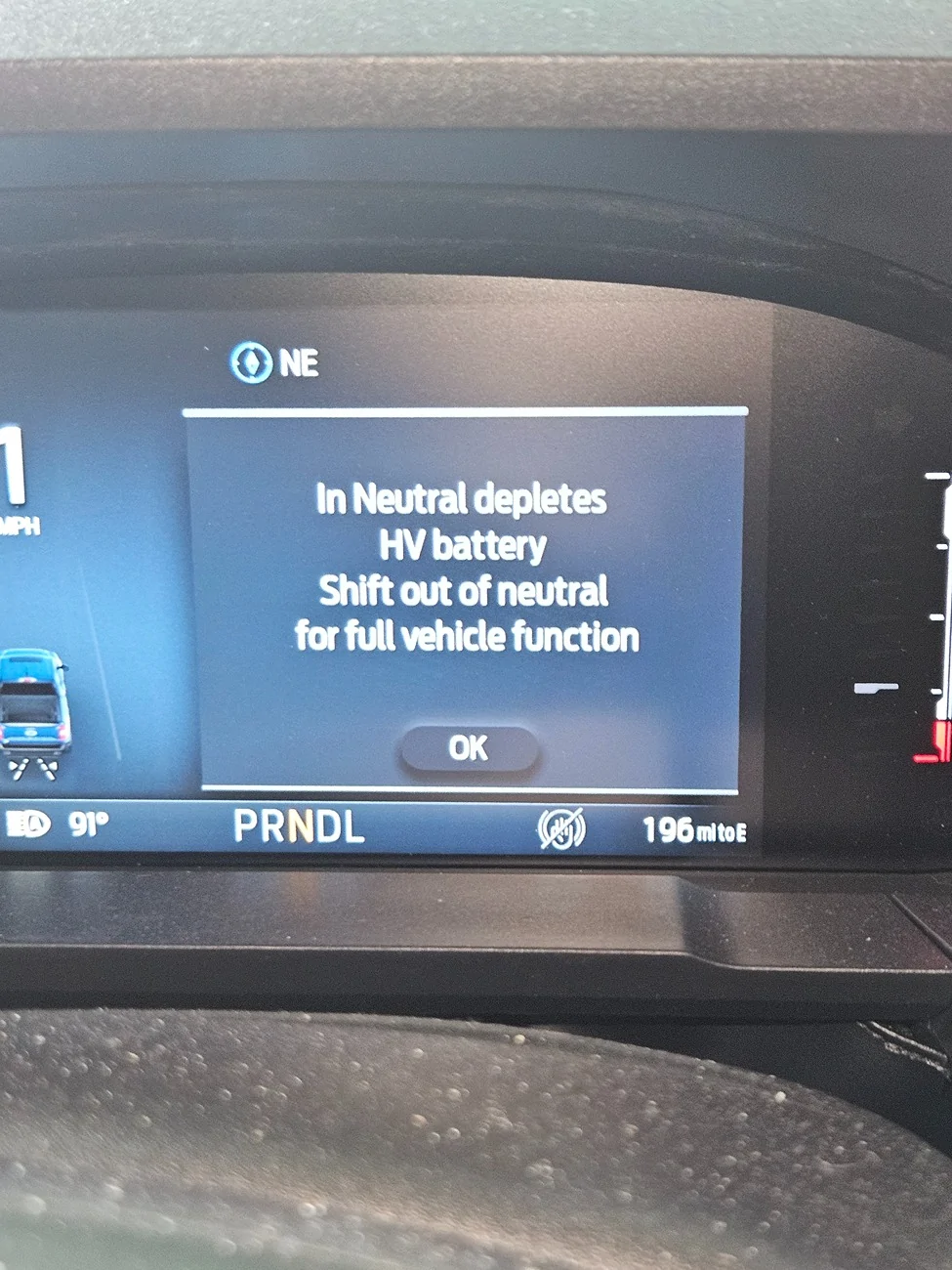

I agree that just N is the correct answer. It also disables the auto brake. Also, occasionally you see this...

Some folks are skimming the pop up message and totally skipping the middle line.
