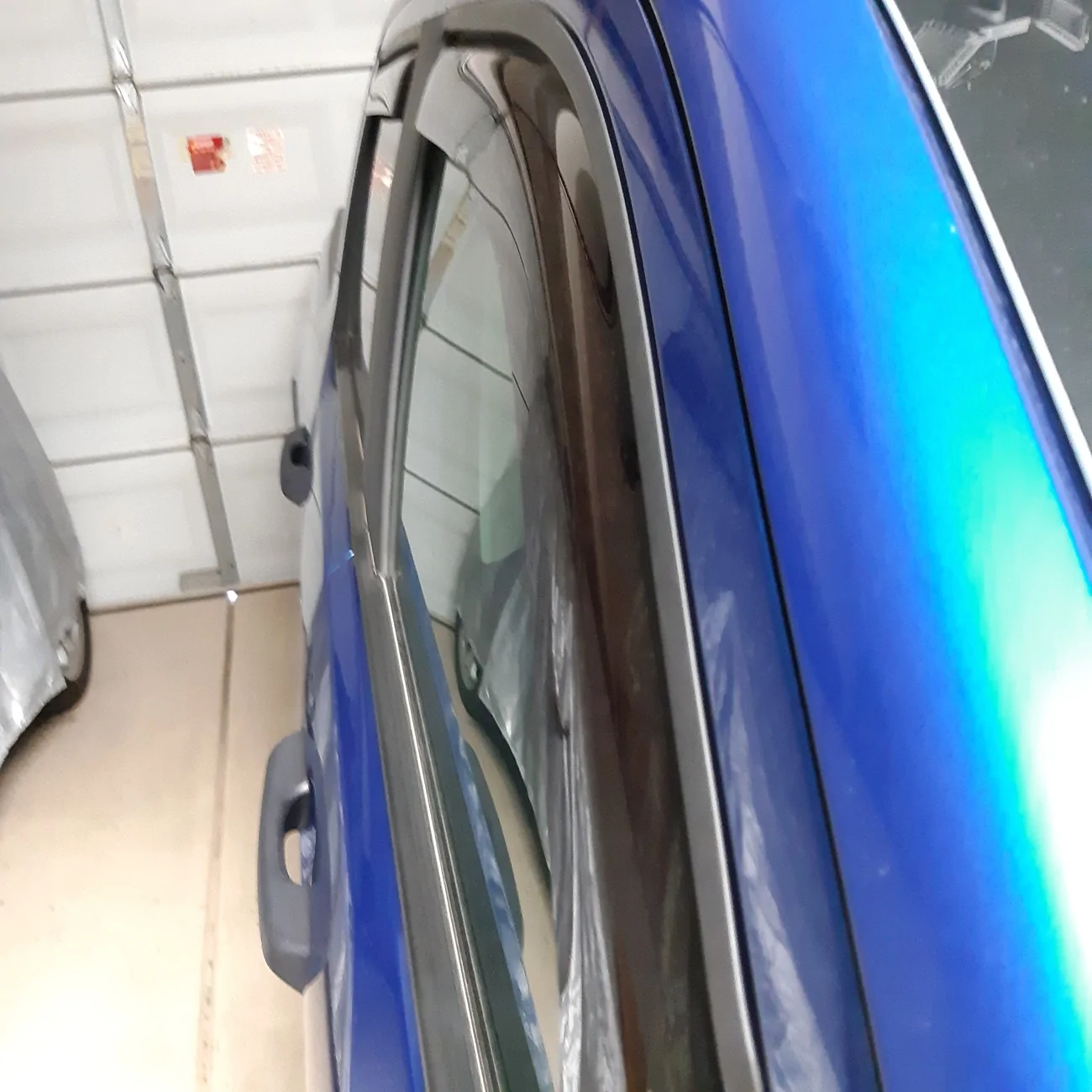

I'm glad my current EGR in Channel vent visors don't have any restrictions about not using automatic car washes.
The WeatherTech that I had on my Toyota Yaris and Buick Encore didn't have any warnings about not using automatic car washes either.
15+ brush style automatic car washes and they haven't ripped out.👍
I don't know about the stick on vent visors or bug deflectors.
