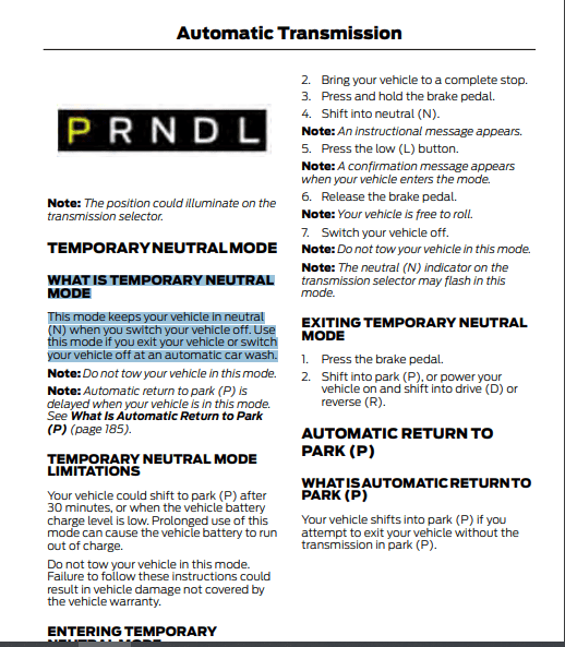

Page 185 of the owners manual talks about putting the Maverick in Temporary Neutral Mode. If you're at a car wash that doesn't allow you to remain in the vehicle, then you'll have to do this procedure with the engine off.
I feel this is a little much for an automatic car wash. Since I'm in the vehicle, why not just allow me to put it neutral instead of having to use the steps in the manual. Now if I had the door open or something I can understand. As the Mike's car wash I like to go to, (never had any issues from the brushes), they are rather quick at getting your car moving and you don't have a lot of time playing around putting it into neutral.
Wait...can you tow your vehicle in this mode? :LOL:
